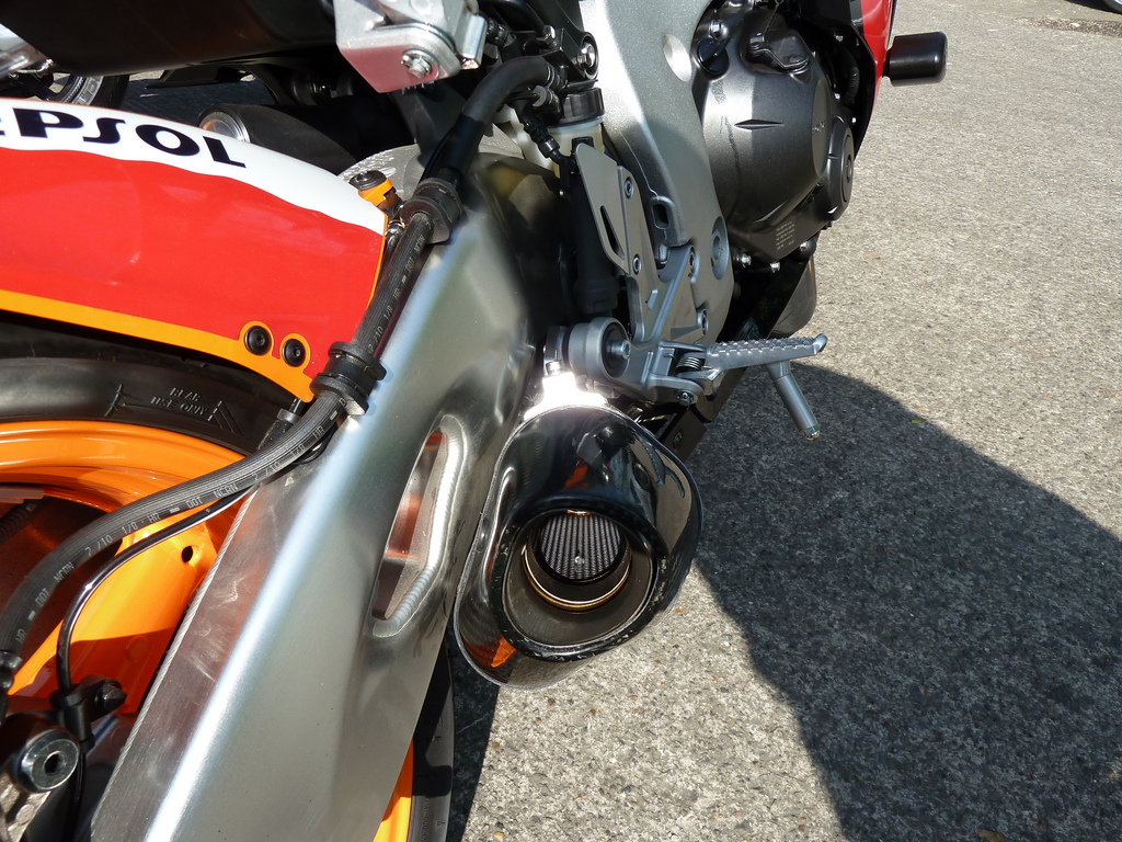

    Now i am thinking that i have been a complete numpty and that mine didnt have a baffle in to start with. I have google images of the R77 baffle and i certainly dont have what is shown in the images or on the Yoshi site in my exhaust. I think possibly the fact that i had a threaded bolt poking thru into the exhaust made me think that it was holding the baffle in when infact it was just there for the baffle to be held in place (if there had been one). This never clicked until Remal said his never came with a baffle but it did come with the bolt. I think the second thing that has thrown me a bit was looking at the pics Remal posted looking down into his Yoshi i could see no definate lip on the inside of the exhaust and yet when i looked into mine it looked different to his.
    Here are some pics anyway, i am still not sure but am leaning more towards there is no baffle in there

    Erm - there IS a baffle in there! 100% - i have the same can and baffle.
    The easiest way is to get a socket ratchet which slips inside the baffle, hook the square end over the back rim (inside the pipe) and yank.
    As for the bolt, either, take the can off - about 20 mins, or try using a magnet.
    BTW, the baffle is the big gold ring.

    The baffle looks like this.. sorry its a crap small picture, its all i could find.
    The black rim turns gold after it has been used...
    PM sent..
    this is what it looks like with NO baffle...

    Mine come from the US so no baffle fitted. but come with it if needed
    what mine looks like
    I can take more pics of the can and baffle later when I get home if u need

    just posted mine up and that looks like the baffle to me. the bold goes in on the top left hand side.
