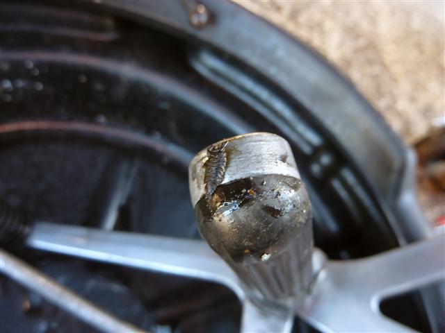

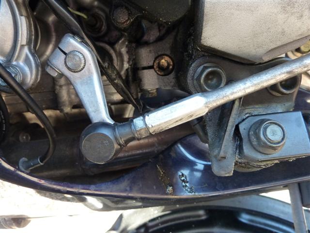

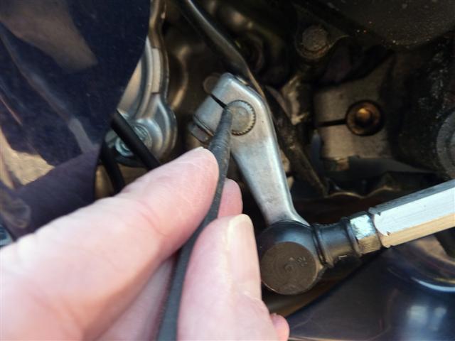

    I put a scribe to the end of the shift rod to make sure I put it back in the correct position, then realised that there is already a datum punched into it at the factory.
    Honda,eh? What can you say.

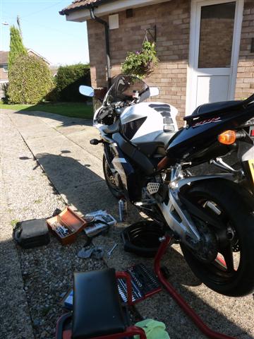

    At this point I wasted another 15 minutes searching for my thread lock (cheers for the warning Craig). In the end I had to give in and drive to the auto factors. That's another thread on its own for later. While I was gone, my beloved took this photograph which she insisted I include. She calls it "The Silent Driveway or Yet another job Ken starts without having everything he needs."
    I return.

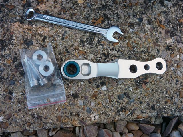

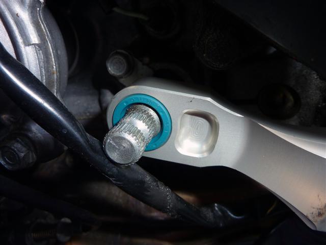

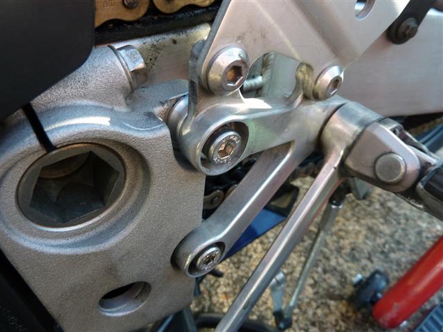

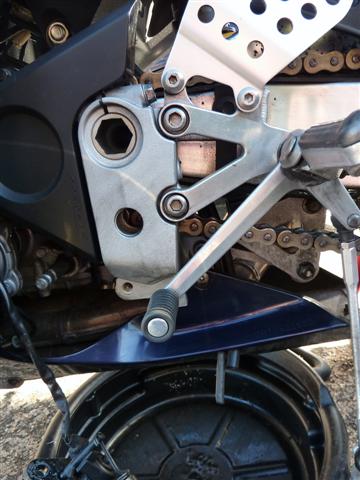

    The new bling. It's a real shame you can hardly see it in situ. It's such a pretty, feely thing.

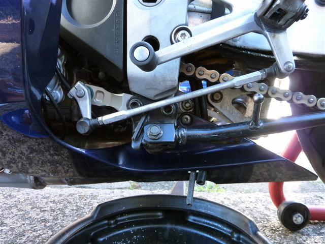

    After wrestling with the single sentence of instruction, translated from "ze Jerman" I realise that the 'basic plate' which the spacers need to be attached to are actually the footrest plate and nothing to do with the support or sidestand. Logical, I know but hindsight is always 20/20.
    The new bolts are not as nice to look at as the factory ones, and hating alloy to steel fixings I put a couple of Stainless washers in behind for future proofing purposes.
    Cruel fate. As the the footrest dangled and touched the ground, of all the planet this poor wood louse had to be stood...
    My inner Buddhist is gonna keep me awake tonight!

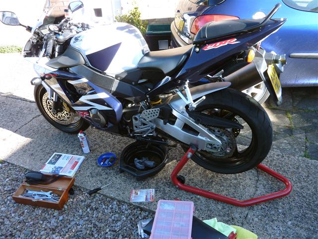

    The fit is flawless, like OEM.

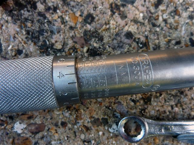

    Yes, you guessed it. 20 minutes to find my torque wrench! According to Haynes 44 Newtons per metre.
    All pinched up nice and tight.
    Then a chance at redemption. A half pissed wasp nearly trapped in my socket set was rescued from certain death. Karma of sorts for the wood louse.
    Done and done.
    So a couple of rounds of beans on toast and a test ride and what's the difference?
    Surprisingly quite noticeable. I've never suffered the dreaded false neutral and have learned to live with the somewhat agricultural nature of the 954 gearbox. This has not changed with the mod. But, the affect, still noticeable is damped out beautifully by the support, so it feels like changing gear through an orthopedic mattress. That's better and I'm impressed.
    However, the big surprise came on downshifting. It's soooooooo much smoother and a much more pleasant experience now, even though I never thought there was much wrong with it before. It seems to have made me much more inspired to stamp down the box approaching bends, making it less of a chore to get into the right ratio for the right entrance speed. I'm here to be told otherwise but an adaptation to the gearbox seems to have improved my cornering.
    A great mod, easy to do. A few quid cheaper from Calsport than anywhere else and it came so quick, I'd opened it before Jamie sent me the email saying it had been dispatched. It's beautifully cast and the only anal moans are that a better description of what goes where would have saved me 10 minutes to waste elsewhere and the replacement footrest bolts would benefit from being closer to OEM in appearance.
