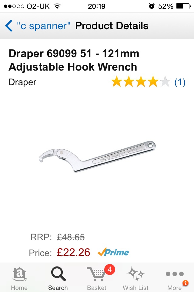

    Will this one do the job for a 08 blade shock? Slightly bigger than the last one I posted..

    7,860
    3,092
    I did suggest this as a sticky before but it got poo poo'd so to speak! I paid for mine but happy to share if it saves someone else money as someone will do the same for me at some point I hope

    Twisted, it seems that I have kept the tool kit from my old 2010 blade by mistake after trading it in.
    Willing to send it to you for the cost of postage if you still need it ?
    Pm me your details if interested.
