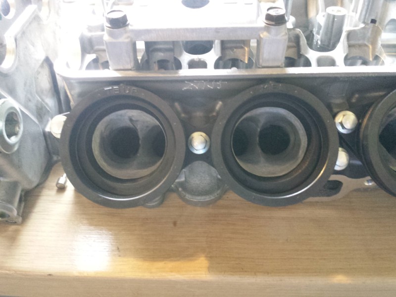

    So .... my engine is open since 2 days. I'm waiting for a new oil pump and after i ll close with its news goodies : Wiesco piston, KWS head, new cylinder, new valves, new bearings, PTH and PTV perfect.
    I ll dyno it next month to see what happen .....

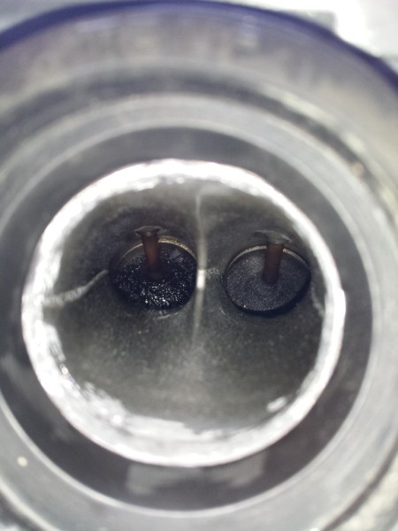

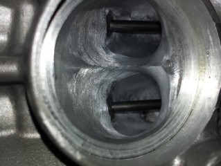

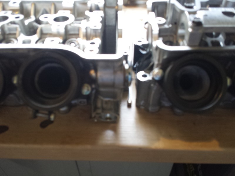

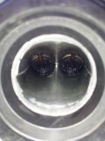

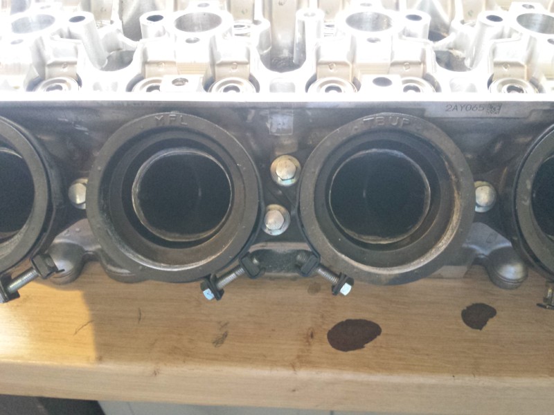

    So, engine on the way ..... 2 days and it will be good ......
    - Wiseco 13,5 piston
    - new cylinder block
    - KWS head : ported and CNC valve job on a completely new head ( head , valves, spring etc )
    - my old reprofiled cams
    - new SprintFilter
    - new rod and shell bearing

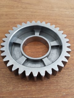

    - new 3th gears from Nova Racing, more strong and treatment

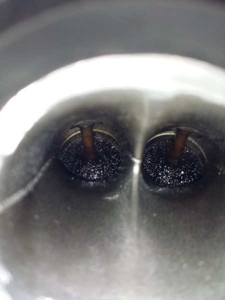

    You can see the amount of **** under the valve and the big oil on the top on the previous pistons ....

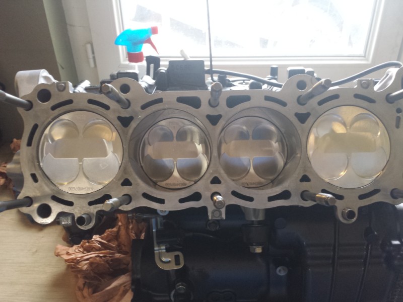

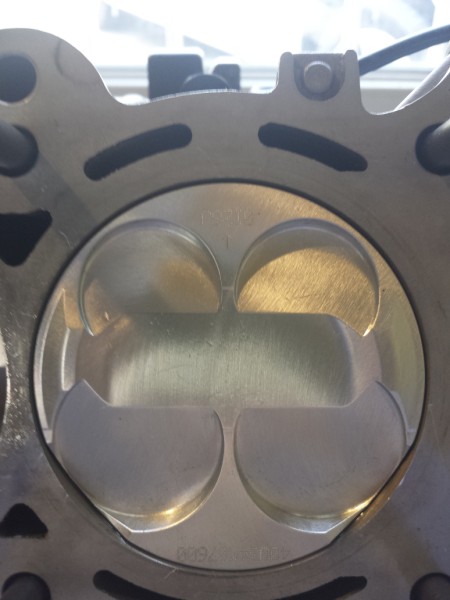

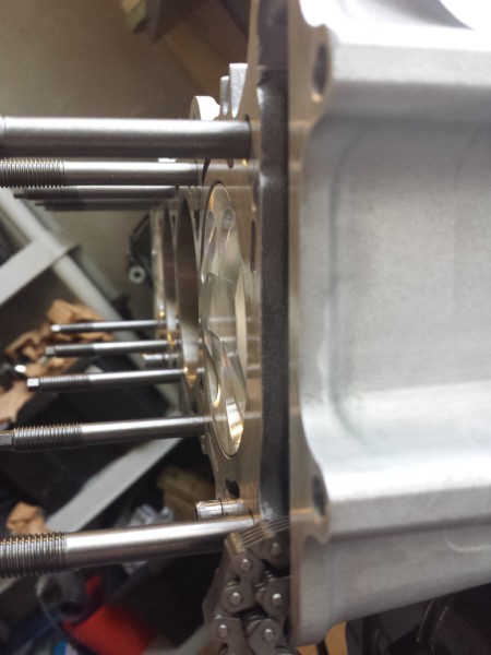

    So ....head mount today, with 0,68mm wiseco gasket, i got a 0,6 squish ( PTH ), i ll measure PTV tomorrow, but now i have already command an HRC 0,75 gasket, cause 0,6 afraid me with heat this summer , with 0,75 gasket , i ll run 0,7 PTH..... waiting ....
  7. foenix
    foenix Active Member
    Jul 8, 2013
    1,182
    250
    ENGINE CLOSED !!!! Wiseco makes things good ..... finally i ve kept my quench at 0;63 and i ve PTV > 2,8 mm ..... just perfect ......
    Tomorrow i put int in frame and go in break in !!!
