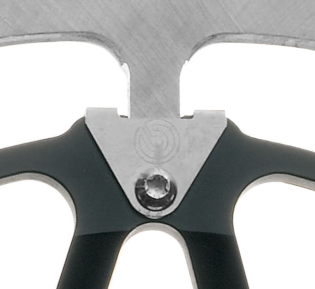

  16. PeterT
    PeterT Active Member
    May 17, 2011
    1,050
    247
    There are nice discs on your bike Arthur, strange bobbins which look like they are bolted on. Which model is that please?
  17. arthurbikemad
    5,371
    3,579
    They are Brembo T drives Peter, rather than use a round floater to decouple the disc from the carrier they use a T shaped guillotine, the lower part of the T slides into the carrier so load is forced against the flat side of the T, it's a more effective way of dealing with the forces and allowing the disc to expand and contact with heat. Invented some time back in the UK and common on PFM discs now re branded and used by Brembo in the racing range of discs.
    How I like to complicate a simple question lol
    #57 arthurbikemad, Mar 3, 2015

    Calipers are only half the equation! T drives are 5.5mm thick and transform braking to another level! Had them since they were released. Only downsides are heavy as 5.5mm and noisy. But WELL worthy! Better than ductile iron or CMC IMO.
