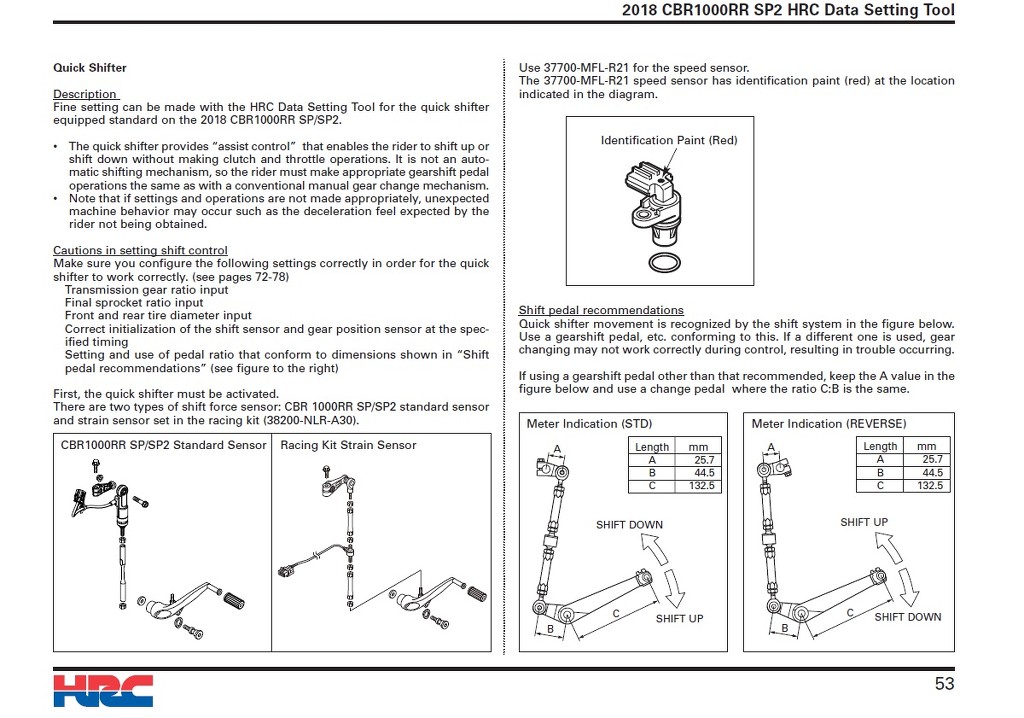

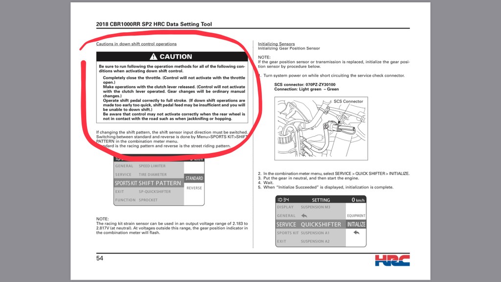

  9. RC45
    RC45 Active Member
    Jul 26, 2017
    435
    300
    Direct copy from the HRC book... so how is it the street bike miraculously doesn't need calibration but the race ECU does? Seems odd that the street ECU is that tolerant of different tyre sizes.
