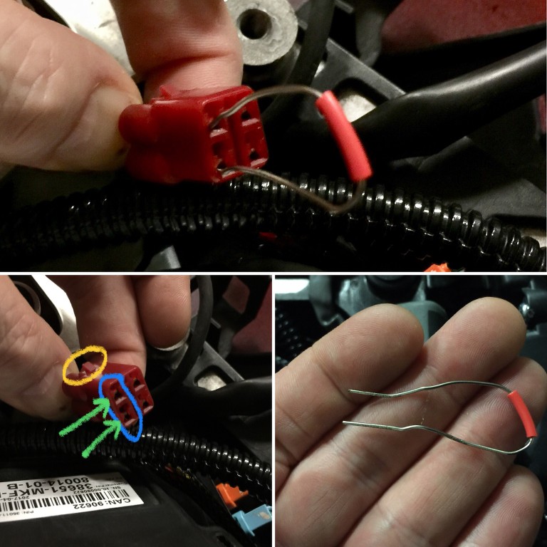

    thought just to share this with you guys as when im reading this thread i was very confused. because i followed grom video it didn't work. so its actually the mint and green wire. so when you look at the plug like the photo "DGR" posted its the left two slots. it will make a noise once you turn on the key so you know you are doing right. it worked for me cleared my code.

    Yes, it's I had success today with green and mint green wire. Bike even sounds better.
