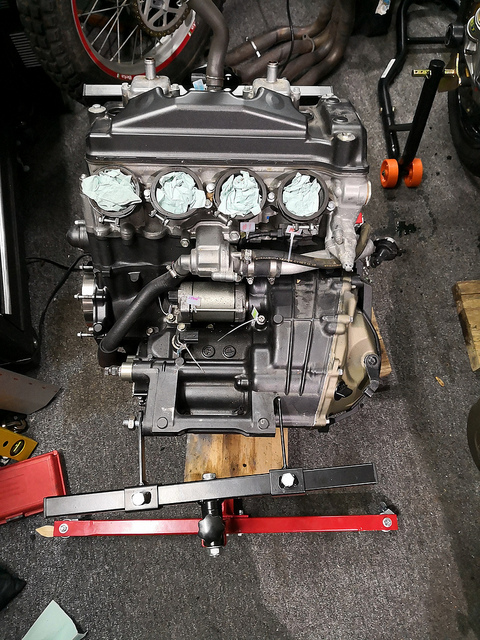

    The engine is out now and it is in a workshop engine frame so I can spin it around without damaging it. The last engine I worked on (GSXR) had a bit of damage to it after having it upside down to do some refresh gearbox work as it was jumping out of gears. It's not fully in the workshop frame in the photo - hence looks a bit lop-sided. But it makes life a lot easier.

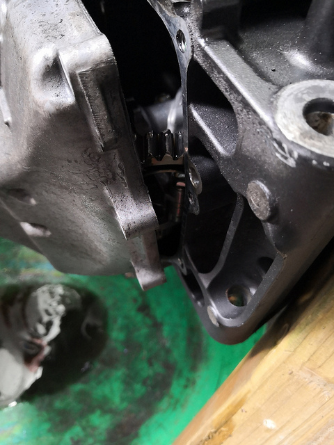

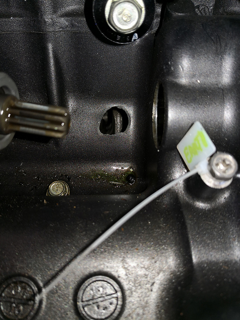

    I couldn't see any damage to the crankcase until I removed the starter motor - and a tooth had punched its way out of the casing. It looked like conrod and gear tooth didn't like to share. But I found a person near me who can weld this up - they specialise in wheel repair and restoration but found out he works on all sorts of restoration - including motorcycle cast alloy casing.

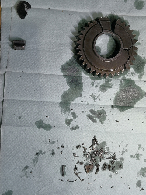

    Here's the offending bit of gear with the bit of casing punched out.

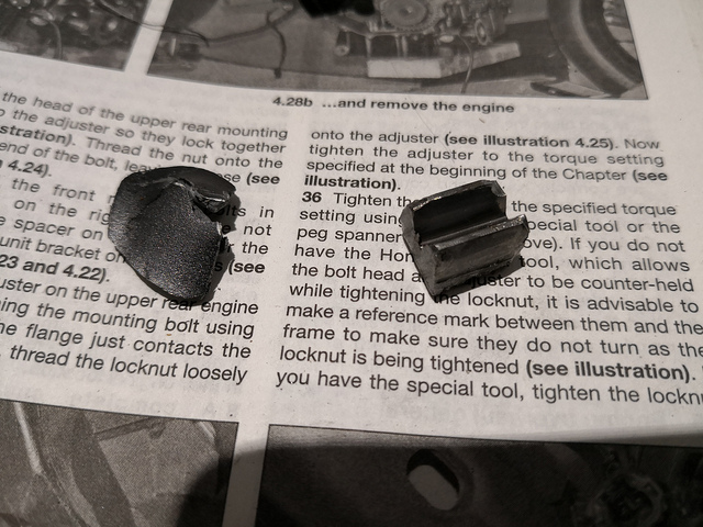

    Next was to remove the sump with the engine tilted to the side so any shrapnel stayed in the sump. Look what was there to greet me...
    Once the sump was off, this was the contents (ignoring the bits on the top-left) -
    Although it looks bad, the engine was very clean as far as I can see.

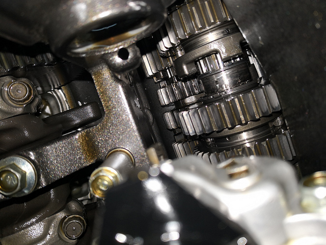

    A lot of the 'bits' have come from the broken 3rd gear grinding against the 3&4 on the main shaft. It's not clear in the photo below but 3&4 has a lot of tooth damage.
    So, next on the list is to split the casing and get the hole welded up, which can be done without removing crank, rods etc.
