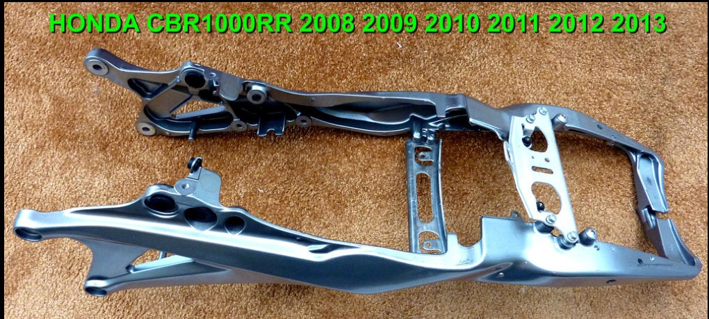

    522
    Right, just had a very entertaining chat with Si and we think we know where we are going with this now. There is not enough meat around the rear M6 bolt holes to bolt anything to ,so we are thinking of using the underside of the subframe and boltholes. Si can't get at his bike until Thursday at the earliest. Can any of you post 2008 Bladers take some pix and measurements of the undersides of the subframe in the area of the two M6 boltholes and give me an idea of how thick it is and how much room there is underneath? Pleeeeeeeeeeeeeeeeeeeeeeeeeeeeeeeeeeeeeeeeeeeeeeeeeeeeeeeze?

    Yeah that's handy. Just need some pix and dimensions of the back end now and how close your undertray is?
  11. megawatt
    megawatt Well-Known Member
    Jan 27, 2011
    2,479
    522
    Si, look at this eBay item; 390476436885
    Zoom in on the back part of the right hand side. Look at the bolt holes?
    Is it the same as yours?

    Looks like bolting bracket(s) underneath is the way to go then?
    Did you understand my sketch?

    That's useful mate. So what is the the thickness of the front and rear threaded bolt holes. If I make some models outta alloy , have you got any tools to trim them to the right length?
    I see that front allen bolt has an alloy pillar around it. How much room is there around the front M6 bolt hole that we are gonna use?
    #39 megawatt, Feb 28, 2013
  20. Si.
    1.2 mm from the pillar mateā€¦thickness of the bolt holes? No idea dude. At a guess, about 5 or 6 mm?
    Yeah, can use some snips to trim the bolts dude, no probs.
