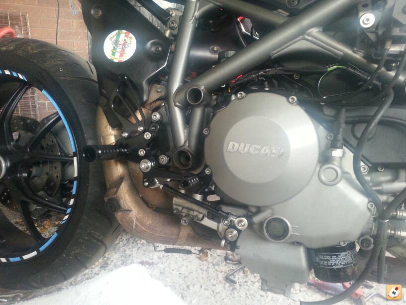

    Added these phantom [​IMG]

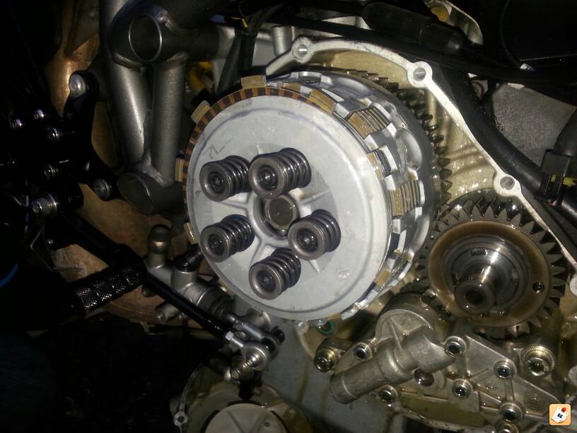

    Went for blast before after fitting this [​IMG]was out nice whether here in e port. Then my clutch started being funny.
    Got home bleed it . More the took the cover off an found this. [​IMG]
    I have 10 steels an 12 friction plates. I think there is too many in it...?

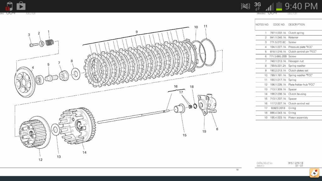

  6. arthurbikemad
    5,371
    3,579
    Install the clutch plates (9) in the following order:
    - one friction plate (H) with 48 square tangs;
    - a series of three plain plates (I) thickness 1.6 mm, alternated with three friction plates (L) with 40 rectangular
    tangs;
    - a series of four plain plates (M) thickness 2 mm, alternated with four friction plates (L) with 40 rectangular tangs;
    - a series of two plain plates (I) thickness 1.6 mm, alternated with two friction plates (L) with 40 rectangular tangs;
    - one plain plate (I), 1.6 mm thick;
    - one friction plate (N) with 48 rectangular tangs.
  7. hump333
    hump333 Member
    786
    223
    I'm gonna take it apart again tomorrow an make sure its right. I'm guessing someone put more plates in than need.
  8. arthurbikemad
    5,371
    3,579
    IF someone has added a plate you have to wonder why, I'd guess that it had a wet slipper and someone has put it back and muddled up the order or mixed up some other plates, IF you run a sigma for example the only thing you'd change is the anti chatter rings go against a steel and not the sigma hub, so god knows where it's gained a plate from?
    It's a common mistake on slippers that people place a steel at the back and when the pack opens the plate drops down between the hub, nothing to do with this but the kind of errors you find.
  9. hump333
    hump333 Member
    786
    223
    At the back its got friction then aint chatter then steel then friction. Seen strange Arthur ?
  10. Skippy79
    Skippy79 Active Member
    Sep 9, 2013
    1,103
    427
    I know on the R6's they can add an extra steel plate, but never 1 friction plate…. wonder why wome did that? do you have history on the bike or know the old owner, get in touch otherwise ;)
  11. arthurbikemad
    5,371
    3,579
    Correct if the anti chatter ring sits inside of the narrow friction, then a steel, then tbh the rest of the pack will work in any order so friction steel friction steel until correct number of plates used.
  12. hump333
    hump333 Member
    786
    223
    Yes the bike been serviced at P&H motorcycle in Gatwick. I gonna call them in the morning.
  13. arthurbikemad
    5,371
    3,579
    Well considering the great Mike Edwards rode the 848 challenge bike sponsored by them they should indeed know the score. My money would be on the bikes had a slipper fitted and removed at some point...at a guess...be interesting to know.

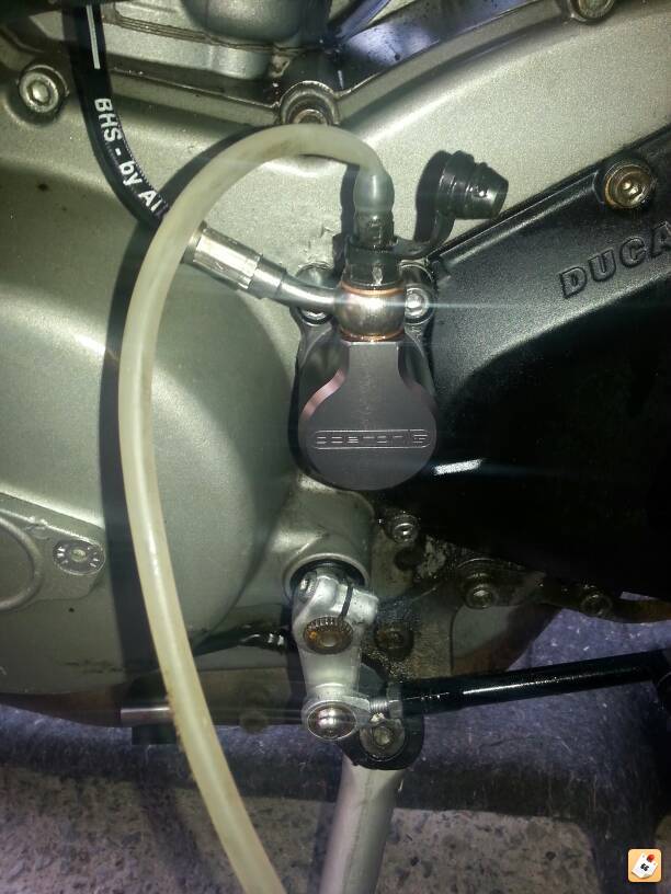

  14. hump333
    hump333 Member
    786
    223
    Arthur if I added Oberon the little rod extension that come in the kit. Would this push the plate out at the end? Give it too much leaver?
    Oberon clutch slave
    #94 hump333, Dec 9, 2013
  15. arthurbikemad
    5,371
    3,579
    Yes, if you fitted the Oberon slave with the push rod extension that's the answer! The extension is for older Ducati as far as I know.
    The extra rod length would cause a problem mate. However the 848 and Evo clutch is the same and the diagram I posted is from the official Ducati 848 service manual I do have a clutch in a box so could double check it's correct but don't think any need tbh, just odd you have a different pack. But YES the over travel of the clutch would cause your problem 100%.

  16. hump333
    hump333 Member
    786
    223
    I'm f@@king dick head should of read the instructions.. I gonna try tap it out. Nightmare. Would this f@@k up the working of the clutch?[​IMG]
    The clutch only had 1 chatter ring! Do I need 2? ? The diagram shows 2, my blade had 2.

  18. arthurbikemad
    5,371
    3,579
    Normally has one concave spring like ring and one flat thin washer type ring so yes two, I think you will be fine mate, don't beat your self up over it easy mistake and think you have been lucky as the clutch has stayed open so lost drive before anything could really go wrong, now you know sort the pack order out and jobs a good one, P&H should be able to confirm my diagram or if you wish or call W M Snells and ask for Alan or Paul in the workshop they may also have time to check the order of the diagrams, or just ask and I will have a look at my old one as I converted mine to dry, saying that I am 99% sure the diag I posted is correct.
    I still think the pack has been fitted or mixed up, also if too many friction plates that will be why the plate escaped the pack as I'm sure if the rod was to long it should just lock up towards the end of the clutch lever travel, rather than open the pack and a plate slip out like yours has done.

  19. hump333
    hump333 Member
    786
    223
    I go with your first author only take 30mins on & off not big job. Got the slave off an push rod extension out. So my head clear for tomorrow morning. If I get stuck I'll drop you pm. But you given me plenty of advice. Thanks a lot. New bike new rules new leaning. Taking a lot on board.
    The clutch did feel super light thanks to the Oberon slave ;-)
