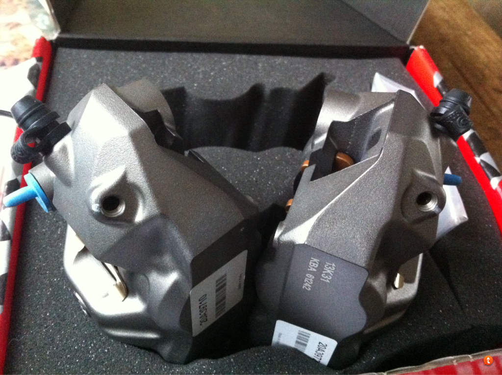

    Has anyone any idea what the second threaded hole is for opposite the bleed nipple on these M4's
    There's nothing in the box to screw in there.
    It's an M6 thread.
    I am wondering if it's for a second bleed nipple.
    Any ideas folks ??
  5. kev.b
    kev.b Well-Known Member
    Jun 8, 2011
    953
    697
    Think its blanked off , it has a drop of white paint by the thread so the blank is probably been torqued
  6. ShinySideUp
    ShinySideUp Elite Member
    May 22, 2012
    2,100
    1,111
    Is it actually a whole or is there a cap screwed down inside but still leaving threads exposed above the cap?
  7. t0m541
    t0m541 Senior Member
    Jul 3, 2013
    1,136
    545
    It's hard to tell TBH, I'll dig out the flexi light and see what there.
    I do think it's a bit odd that they cap all the other apertures off and leave these open.
    Will report back :D
    Yep...looked in there with fibre scope...it's a blanking plug with the threads exposed above it.
    Drop of copperslip to go in there I think, stop it filling with crud and corroding.
