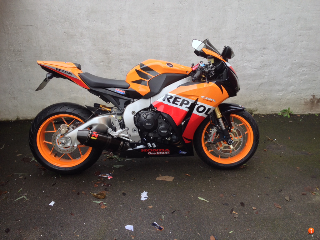

  1. Jamiestrada
    All done ☺️
    • Like Like x 9
  2. Skippy79
    Skippy79 Active Member
    Sep 9, 2013
    1,103
    427
    they really don't look that good on a repsol, just give em to me Jaime ;)
    bling bling :D
  3. sps170373
    sps170373 Moderator
    May 24, 2013
    7,860
    3,092
    Reckon they would look better on a black bike :D
  4. arthurbikemad
    5,371
    3,579

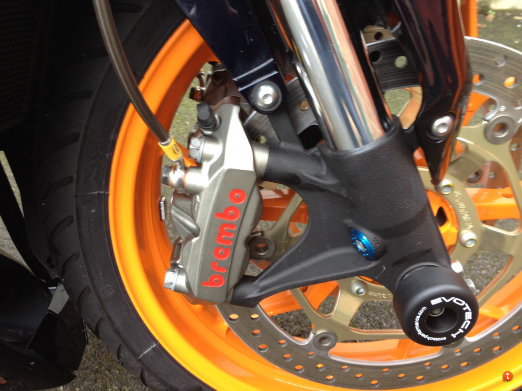

    Glad you got them Jamie, I am sharp if I do say so myself, it was hard not to buy them just for the wall display! Did the late fork have the dowels to locate them on, I've not fitted them to a 2012 yet?
  5. Jamiestrada
    No Arthur its flat after you remove the shims, but as soon as you fit the bolts there is no movement
    The alignment is better than the OE callipers, I can spin the wheel now as I couldn't before ?
    Thanks for the heads up once again Arthur, they are awesome and a real bargain !! Your a star :)
