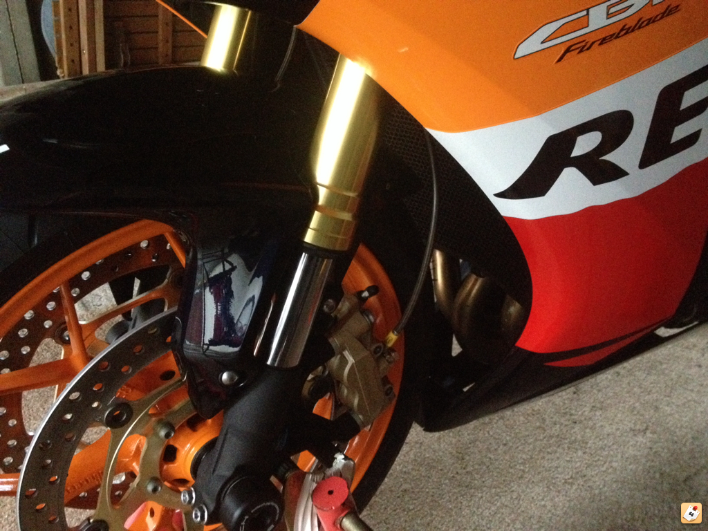

    Excellent job cheers :) just to add amazing how easy it is to fit HEL brake lines supplied by you ;) [​IMG]
    Will get the 19rcs next then the M4s :)
  11. arthurbikemad
    5,371
    3,579
    Look great :) and point the right direction ;)
  12. Jamiestrada
    Best bit is at the M/C I didn't need to use pliers to twist the fittings into line !!!!! They lined up perfectly !!!! :)
