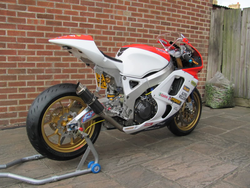

    Any chance of some pictures of your past builds, i've not seen them in MCN

    They look very nice, I bet the sense of satisfaction when everything comes together and looks that good must be immense.
