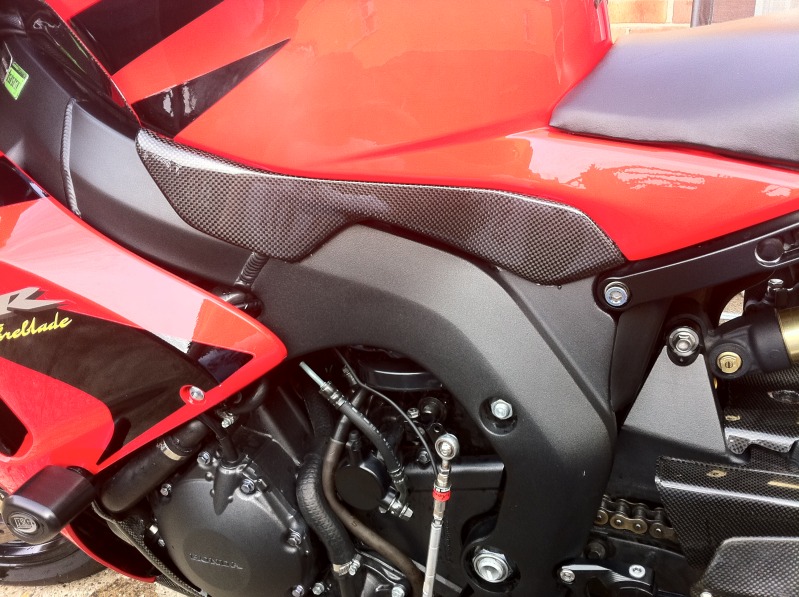

    Hi
    Here are the pics as promised sorry not the best as done with the iphone sorry
    If you need any more give me a shout and i will do my best

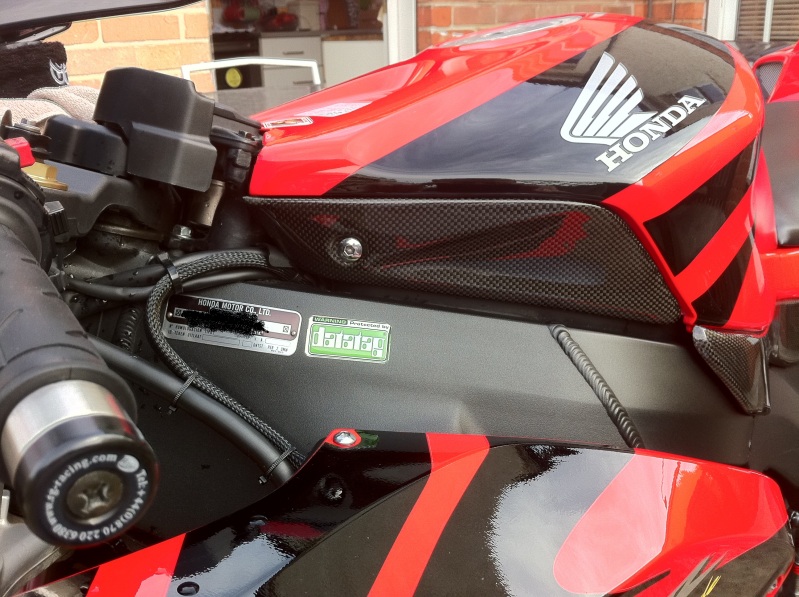

    Tank Infills

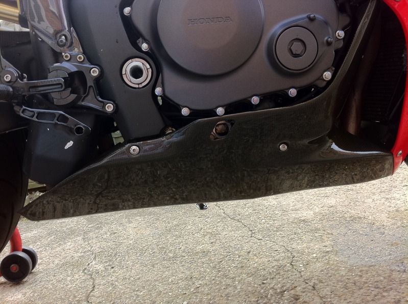

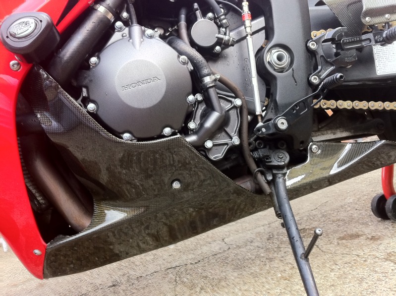

    Belly pan
    Note mine has been on for over a year and slighty warped due to the heat of the exhaust and being a doughnut and not putting any heat tape inside

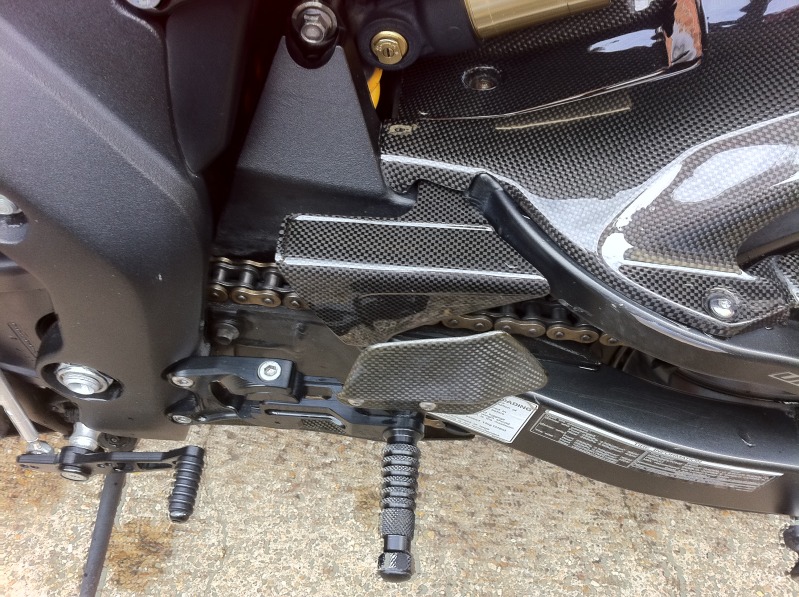

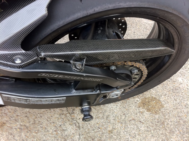

    Chain guard
    This comes in 2 parts

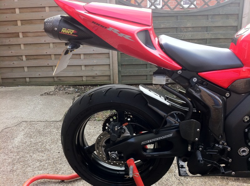

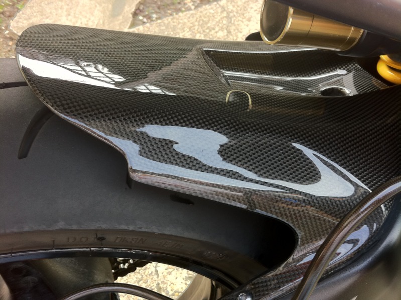

    Hugger
    Side heat sheild

    Cheers g. That seems good quality, and the fit seems to be good. Did you have to fettle the bolt holes on the bellypan etc...???

    No the bolt holes lined up fine it was just where the edges curl over just neaded a little filling on certain parts(lower mounting points near side stand and the other side) but the only thing was the plastic honda clips that go under the belly pan to hold together i had to use stainless bolts as the holes where slighty larger and the trim clips would not hold but not a big deal for me.But dont forget dont do like i did put some silver heat tape inside near the header pipe.like i have said i have known paul for 2 years he is a down to earth bloke but im not here to get buissness for him busy with my own job i know the carbon he gets is good i would not put any tat on my bike but at the end of the day mate its up to you i know he has done a lot of deals with the Tl100 forum pop over and have a nose and see what they say
