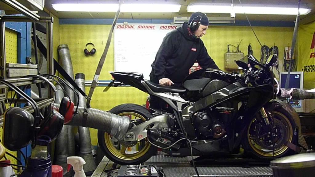

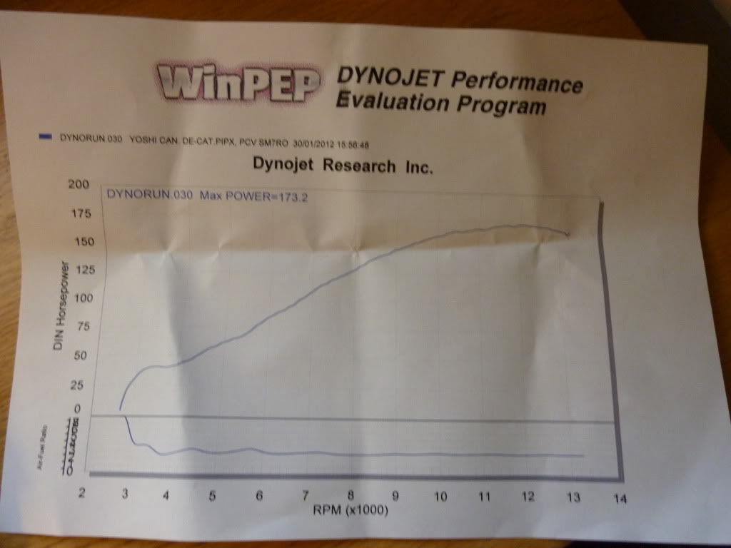

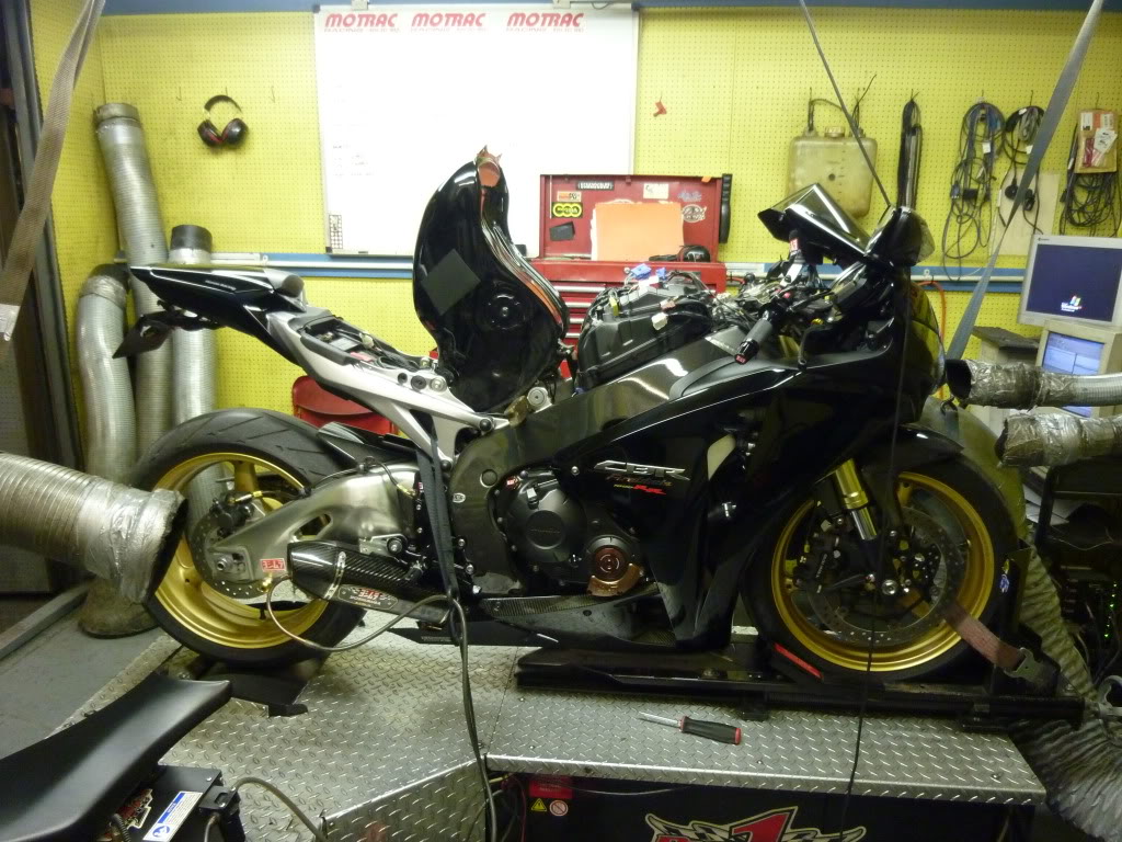

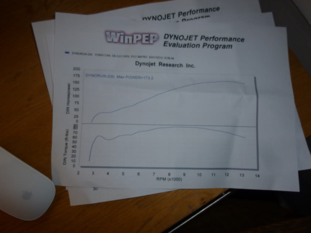

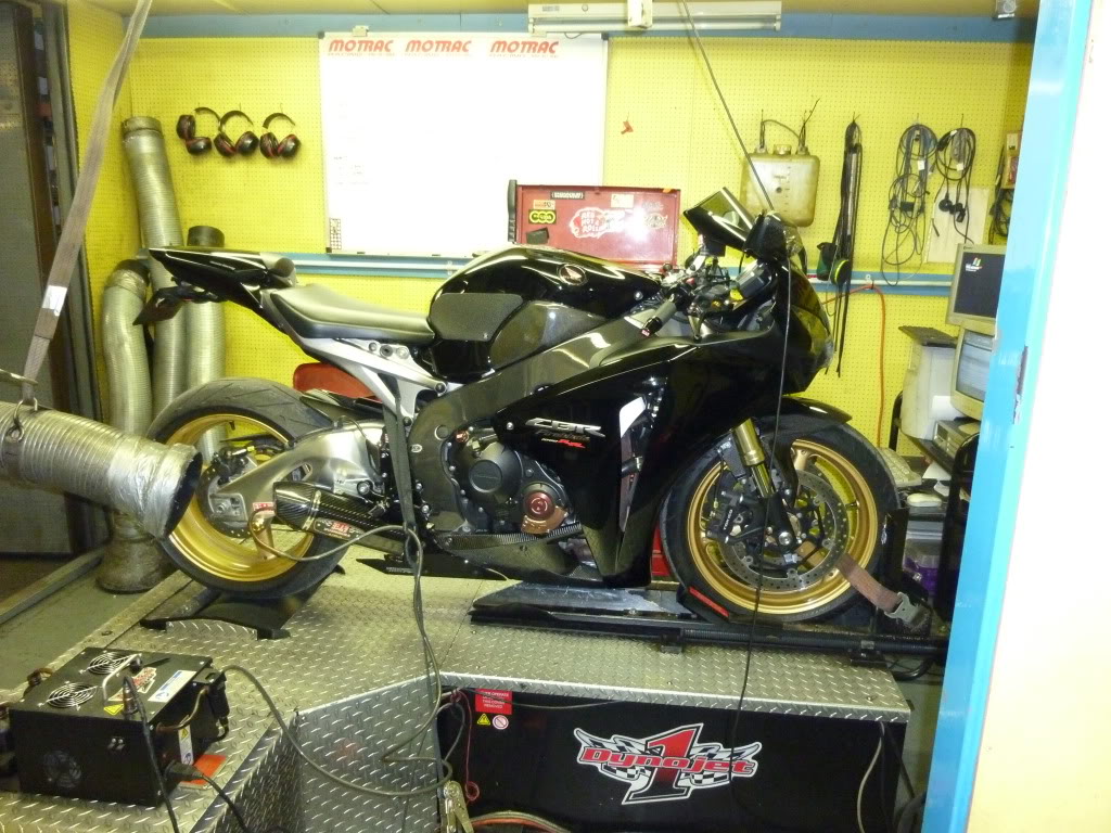

  15. Si.
    173.3 at the wheel.
    Big problem with the power commander though, as it was one of the first out, and the firmware was well old. I really did think it was fooked...The bike kept chucking in fuel on the over run, so ran shit, until it was updated... then Bingo! all sorted. The map on it previous was 168.4, Motrac is 173.2. No wonder Zee couldn't get on with it.
    Anyway, arrived at 9.30 am and didn't leave until 4.45pm... took a while but he's a thorough chap. It was freezing today, 1 degree, so loads of cold ram air in there too... my hands where numb there and back.
