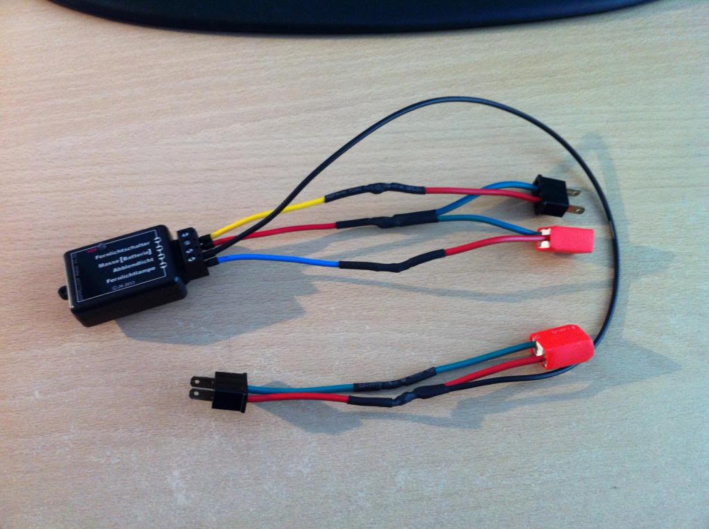

    Wiring looks fine! (tidy job)
    Only problem I can think of is when placing adaptors in make sure Live goes to Live and Earth to Earth on the existing loom end (not a problem bulb end!)
    I also found the plugs not the greatest so make sure connection is made. If before you had this the wrong way could of blown fuse. The headlight and starter switch run on the same fuse...
    Lets us know if you have any luck!

    Thanks...... will have another go tomorrow.
    I also had the same problem with the connections not being that great and had cable tied everything on just in case.
    Thanks again for all your help :)

    Mod finally finished for now, but foresee potential problems in future... all the issues I've had with programming the module and things not working as they should have had nothing to do with the module or even my poor soldering skills!
    Looks like all the issues are with the very poorly fitting adaptors used.... now every connection is cable tied and all is working...... cable tying some of the connections was not easy so will have to see how it goes once it's been over a few rough roads.
    Will have to see if I can get better adaptors and dismantle and rewire the whole thing at some point!!!!

    I had the same problem with the connecters and had to cable tie them too,
    All seems good now

    Fitted mine today! Very happy with how it works and looks!!!

    Wrong way round for some reason!! Nevermind,you get the gist!! Done it the womblewizard way!!! Thanks mate!!!
