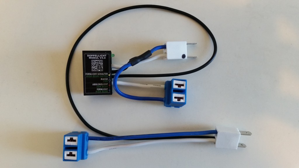

    Some News: The plug'n play module for H7 is ready!
    Maybe some little changes in the color of the wires, but I got the adapters in blue/white :-(
    My new Module, version 4.0 has a waterproof sealing and some changes in the firmware.
    The firmware changes are now in ALL my dual headlight modules, means version 3.x and 4.0
    The changes are:
    1.Adjustable span: Now from ~25% to ~90% to always make sure that it is possible to decide if the module is defect or only dimmed to zero.
    The span before was from 0-100%.
    2.Save the settings: Now the settings are directly been saved during the setup process automatically. Once you finnished the setup, just turn off the ignition to leave the setup mode. Thats all!
    3.Detection of an deactivates Module: I got a lot of claims that the module is defect, customers send it back to me for repair. In no case the module was defect, it was only deactivated. For those cases I added a function. If the module is deactivated, the integrated led will flash shortly every 5 seconds to indicate that the module is deactivated.
    In every case (deactivated, dimmed to lowest possible value) the high beam will always work normally once the high beam switch is active!
    Here is a photo of the first module:

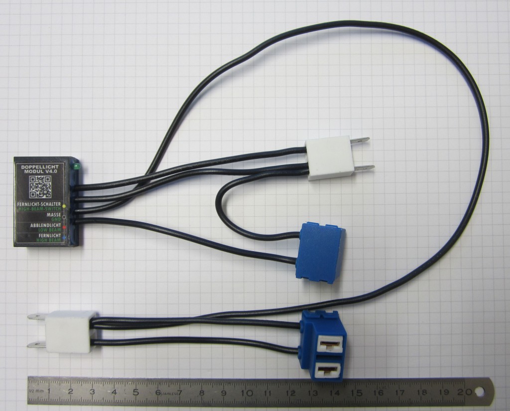

    Final Version with all black cables only ....
