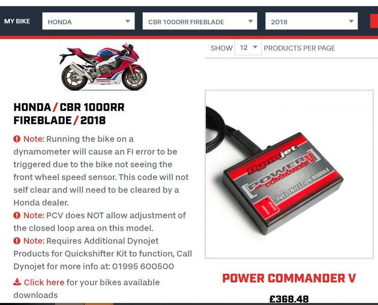

    What company is this claiming that running the bike without the front wheel turning causes an error only a dealer can reset?
    The error is self resetting - its a simple front wheel speed sensor error.
    Christ - why is there so much false and misleading information spread around by lazy companies not willign to know the facts?

    1,242
    took that screen print off dynojet's site
  13. RC45
    RC45 Active Member
    Jul 26, 2017
    435
    300
    Then, sorry to say they are full of shit and never verified the statement before committing to print.
