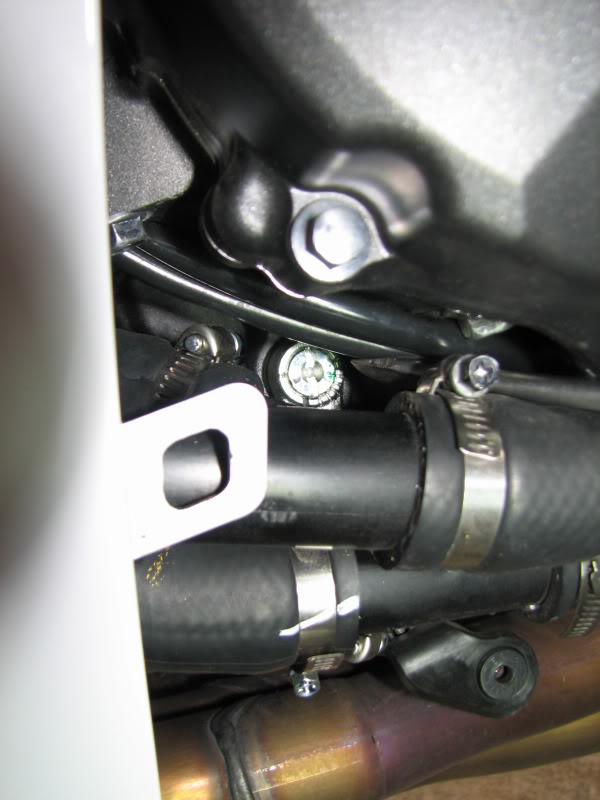

    Ok I have fixed my rattly engine, it took about 5 minutes, and I am rapt.
    As I suspected, the culprit was incorrectly set backlash adjustment on the crankshaft balancer gears, obviously set incorrectly from the factory.
    This procedure is described on page 12-21 of the service manual.
    To reduce the backlash you rotate the shaft anti-clockwise, just a small amount.
    The eccentric balancer shaft is located on the lower LHS front of the crankcase, and is accessed by removing the belly pan.
    When doing this, you need to be careful not to overdo it and reduce the backlash too much, and load up the gears.
    I did it with the engine idling at normal operating temperature, and as you make the adjustment, you can clearly hear the change.
    When the rattling stops and the gears start hissing you have gone too far.
    I put a texta line on mine before I started so that I could easily return to the original position if I had too.
    If you look closely at the photo you can see the texta marks indicating how much I rotated the shaft, I reckon about 5-10 degrees, or about 2mm between the marks.

  12. Pete

    I'd be interested in another video to compare the sound now you've tweaked it.
    I thought mine sounded OK, and that the 1000 Km service would pick up anything if it wasn't normal. I've done 1700 Kms and it always sounded that way.
    Better get a service manual - where did you get yours?

    Pete its quite likely that yours is set up O.K. and isnt an issue.
    Mine was quite rattly at idle when it was hot, it sounded like a diesel tractor and the rattle was coming more from the left or middle of the front of the crankcase.
    I noticed in the manual that the balancer gear back lash was adjustable so I thought I would give it a try, and hey presto it worked.
    The Blackbird has a similar setup and its a known issue with them also.
    Maybe the guy on the production line was having a bad day, who knows?
    Its probably unlikely that they would be set up in the factory with the engine hot and running anyway, which is the best way.
    You can download the manual, I will PM you the link.

    Got around to adjusting the gear backlash and ended up with the adjustment set exactly as it was. I could hear the rattle you are talking about when the adjuster was turned, but mine wasn't making that noise before. Adjusted as per manual and ended up in the same position as it was. Hope yours is OK now and you are enjoying it!

    Hey Pete that is really good news.
    It just proves to me that mine was set up wrong from the start, and that it was an exception to whats normal.
