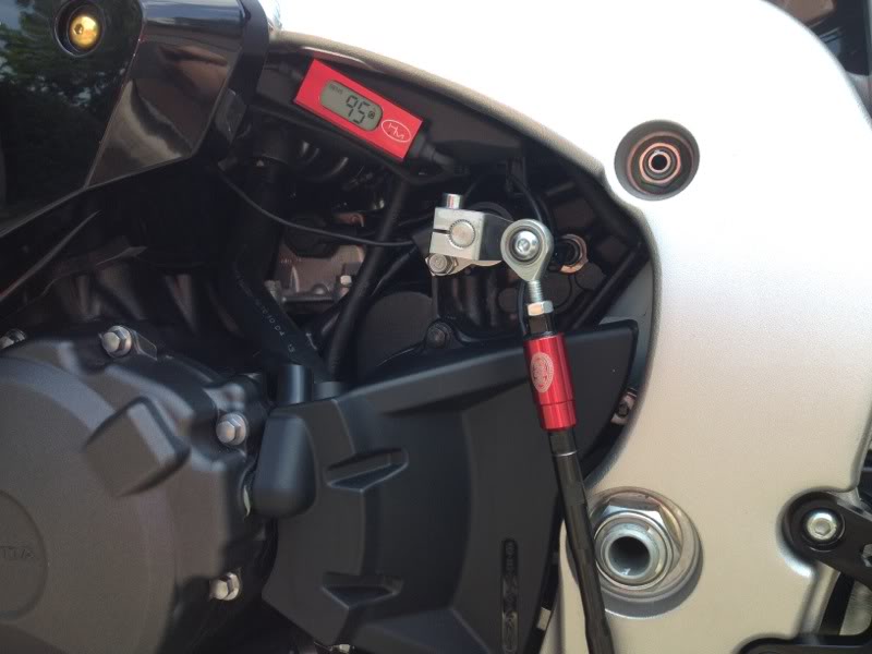

    My quickshifter installed. let me know if anything looks out of place!

    95% is way to high. I suggest dropping down to 55% and trying a static test as per the manual. If it takes more effort than you would normally apply to the gear lever then raise the sens % by another 5% until it cuts the engine during this test and your happy with the amount of effort it takes :)
    You will probably be getting false shifts on the shifter randomly at this setting.
    Yuor bottom rose joint looks a little more twisted than the top but as long as you can twist the sensor and it twists on the rose joints it will be fine.

    Have you done many OEM rear sets mate? They are always around 95-100% as the shift is so easy the HM needs to be set very high, turning the sensor 90/180deg often does nothing as that's what's been suggested to me by HMR in the past..? I've had around 6 OEM RR8s that always end up with the sens flat out or it just does not detect the shift, lower and the gear selector remains loaded and then the kill forces the shift...if your with me.

    No I have not just I have not heard the mechs saying this. You will have fitted many more than me so I will go with you on this one ;) I will enquire about this on tues as im having a long weekend for a change.
    Rotating the shifter I guess they can only be checking if the wire is looking to be coming out of the side, pointing away from or towards the bike rather than flowing in line with the rod if that makes sense as that will have a slight effect on the sens due to the way it is built inside.
    Still learning all the time :)

    It's worth asking mate as a big,ish problem with stock rear sets, CBRs are so easy to shift into the next gear with stock pegs etc they always end up round 95ish, it's NOT stopped any from working correctly and more often or not people change to aftermarket race style rear sets and then MUCH more effort is required to shift and the sensitivity can be lowered, one customer with rather large feet did cause me a problem as with high levels of sens any motion around the peddle can cause engine cuts, if the boot is rested on the peddle the whole thing can go a little crazy, I moved the peddle up high for his large feet and it was 100 times better however he still has not changed the rear sets and runs at high sens, like you say with high sens it's possible to get false shifts.. Hence what prompted me to ask..

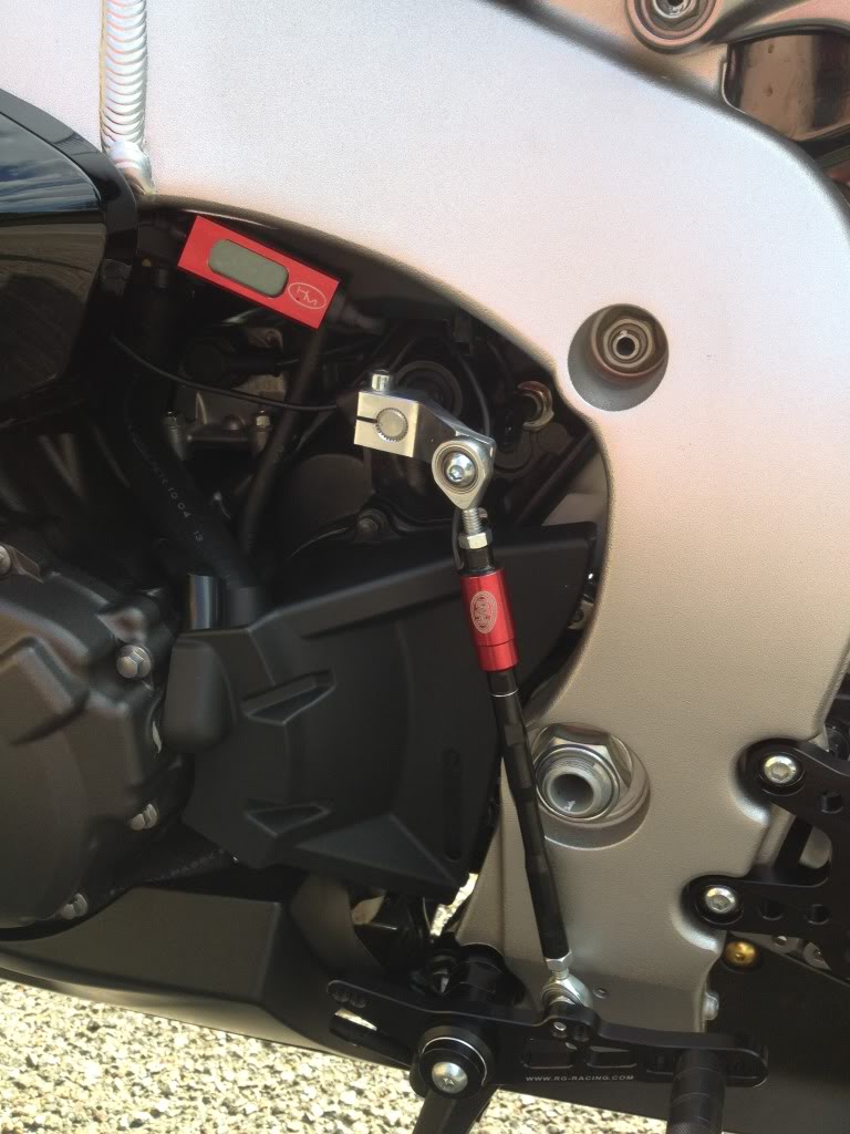

    HM Quickshifter SH
    don't drive without it..................

    This can be another reason a shifter does not feel or appear to be operating correctly, having the lever incorrectly positioned without really realising :)
    When we do installs here we always get the rider to sit on the bike in their natural riding position and ask them if it feels comfortable to shift both ways. Most times they realise the lever was poorly positioned before and was much better after this simple 5 second adjustment
    Looking good black devil, thats what I want I think.
