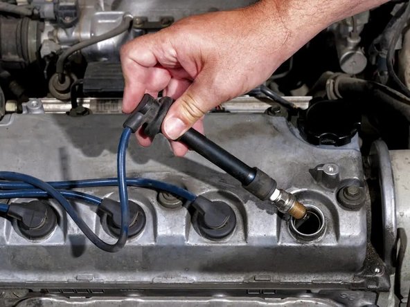

    Remove a coil pack, and then connect a spark plug to it. Make sure the body of the plug is touching the engine so it has a ground.
    Now.. crank the engine, and look to see if there is a spark.
    If yes, we can move forward. If no spark, then we need to diagnose this. Hope that helps.
    Here is a picture:
