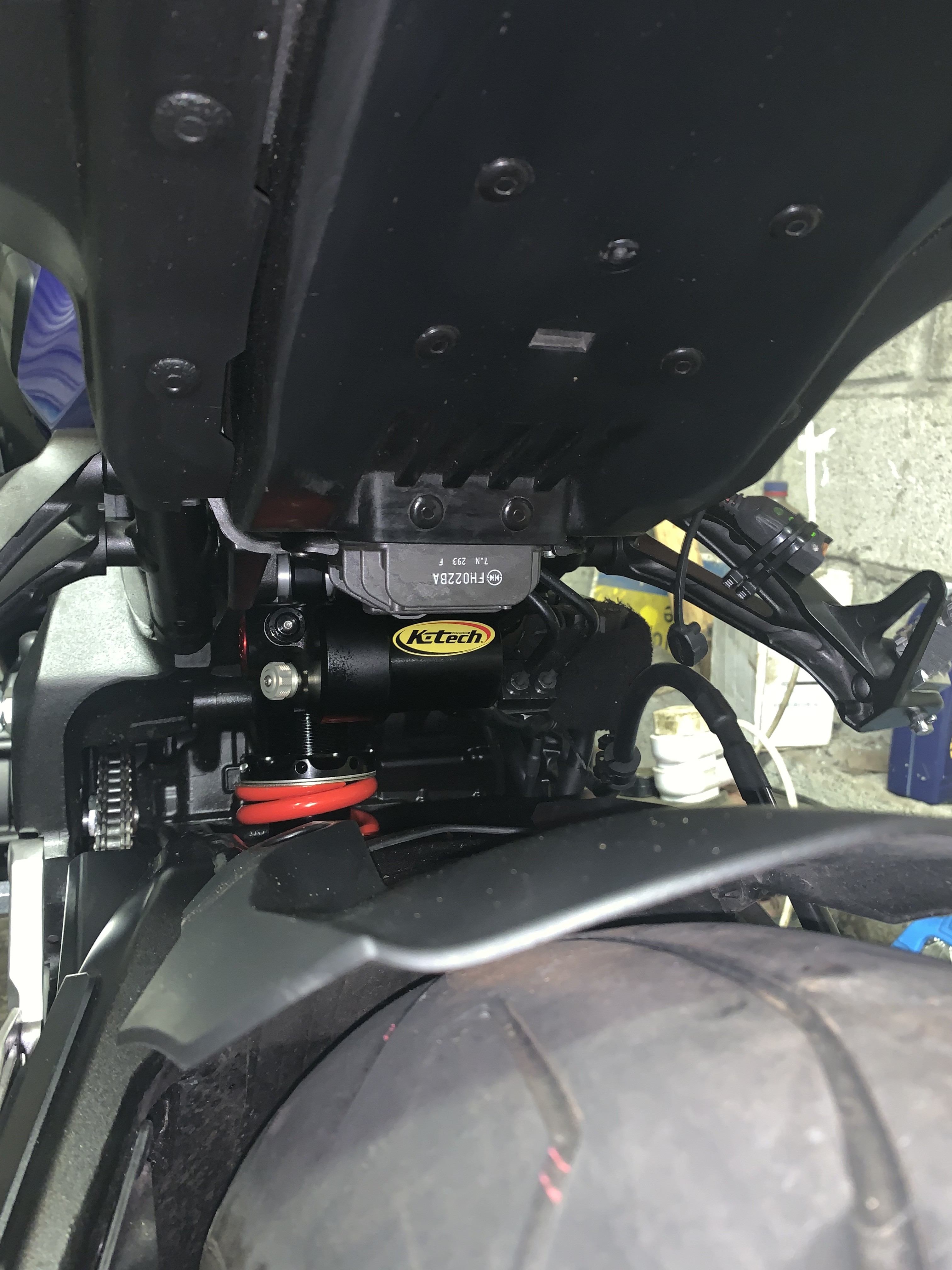

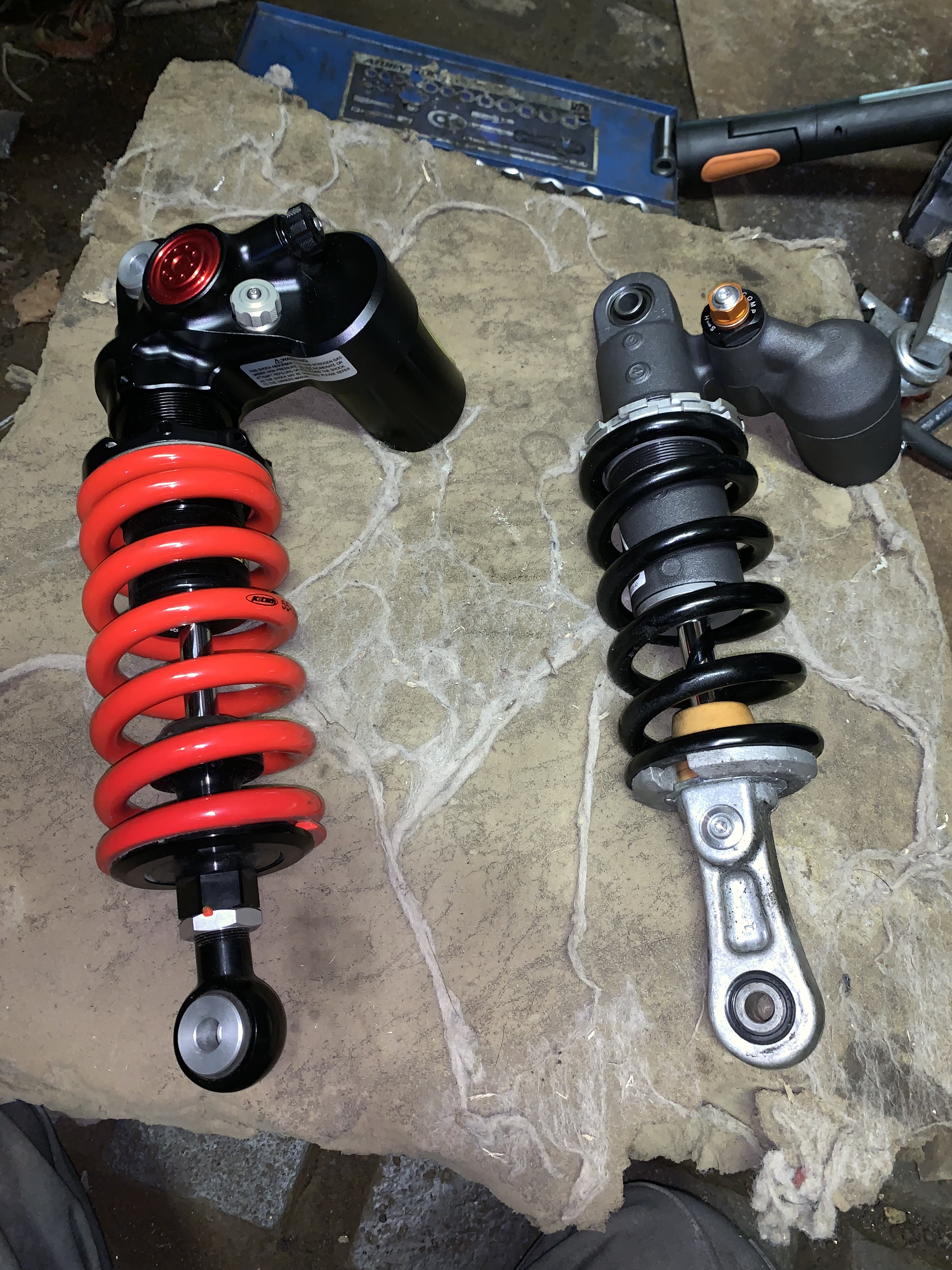

    Finally got my K-Tech DDS Lite shock fitted after installing the Constands centre lift fitting kit. Just push the stand into the frame and lift it with one swing of the handle. Made changing the shock easy. Also dialled in the front suspension. Can’t wait to try it tomorrow now.
    Before anyone asks, no it didn’t need it, but it was half price with just 300 miles on it.

    Wow, that's one serious looking shock. I reckon it's worth the money just in bling value!:)

    Cheers Nige, I stuck in BJ’s fork settings as dialled in by James at JHS on his long termer for Fast Bikes and dropped the front by 10mm as opposed to Dave Moss’s recommendation of a 20mm drop but as I’ve fitted the shock too I don’t want to do too much in one hit. I’d be concerned that 20mm and a better rear end may be too nervous on the roads. Fine for the track maybe but I need to see how it rides first.

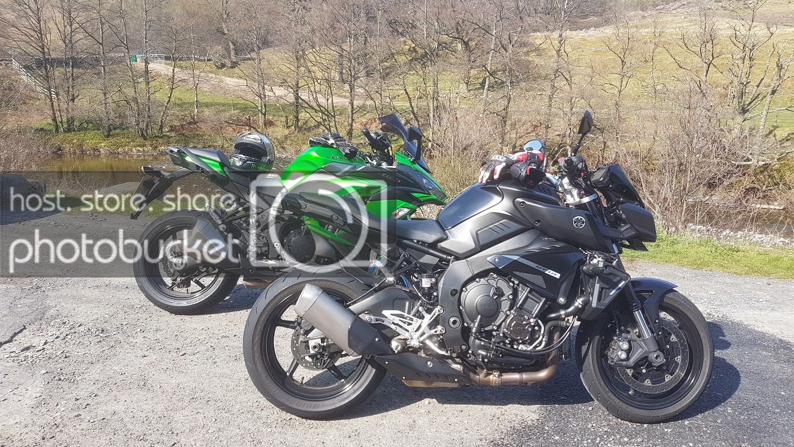

    260 miles through Glencoe and back via Aberfeldy & Crieff :)
