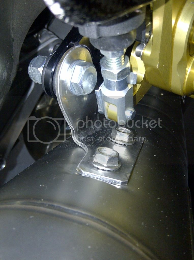

HELP...... I have fitted the LH side no probs. Does anyone know if these are supposed to fit the Blade with the Leo GP Pro exhaust on? The fit just doesnt seem right. Anyone got a leo and VCRs fitted?
got them on but need to make a bracket to hold the exhaust on. you can see the exhaust bracket missing in this shot. I will fit the CF heel plate when bracket is made
Ahhh ha .... that's the same as when I fitted my Leo with VCR's I had to make a bracket as well . There was no way the lovely carbon one would work with the VCR's . I made one that was OK in the short term ... then when I was bored I made a better one .... still got it somewhere
Cheers NT. Ive cut a template for the bracket. You dont have any photos of the bracket you made do you?
I've just had a good look around my pics and can't find any that show the bracket . Soz But its in the bike shed so I can get it tomorrow . The better one was a decent thickness of ally with a 90 degree bend with a slight twist It is about the width of a lolly stick and attached to the rear bolt only

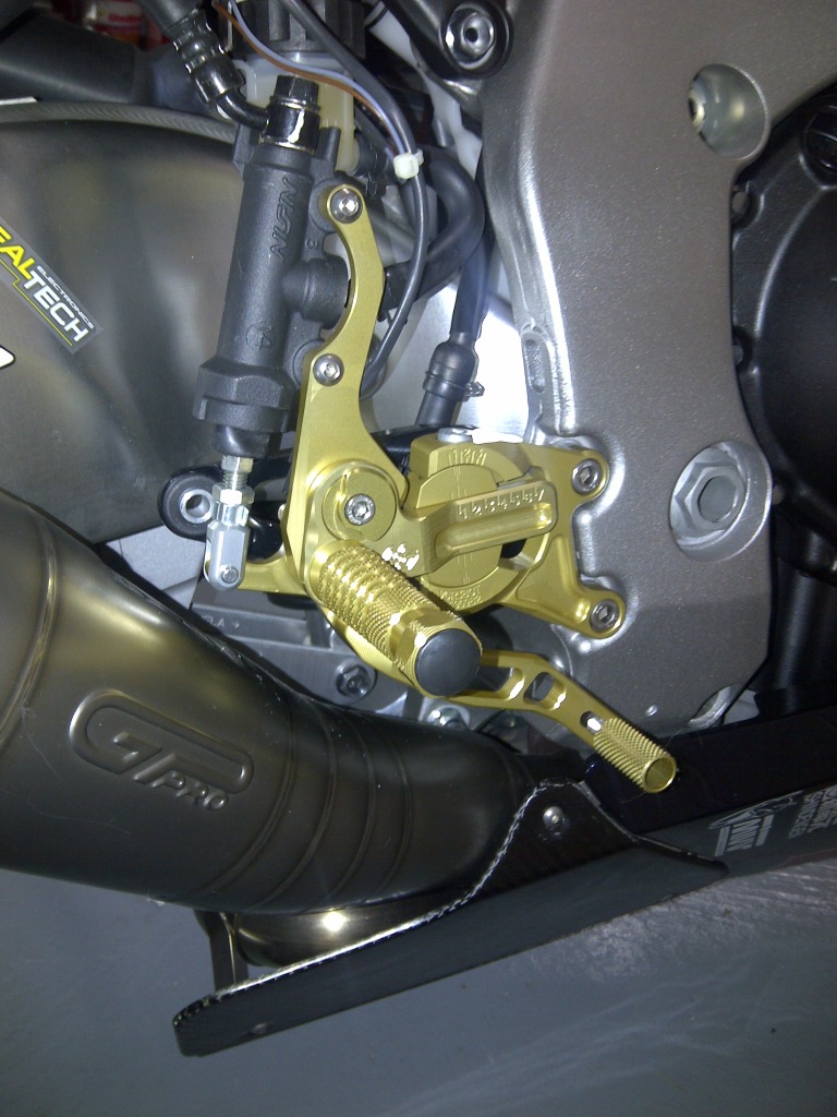

Your going to love them Steve. Just make sure you glue the black plastic end caps on, I used blue loctite.
Awesome job there mate, looks factory Looks great with the repsol paintwork, I need some black ones now
