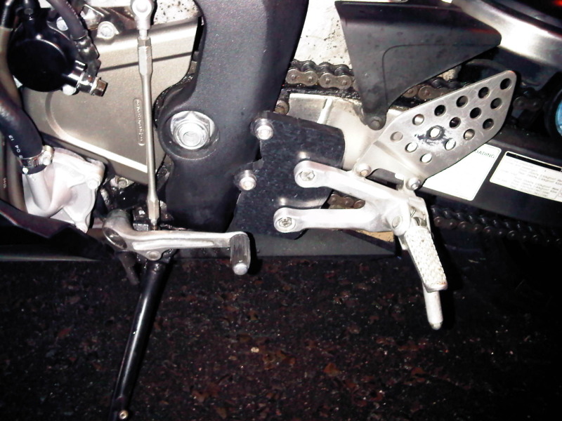

    Great stuff gents, i had a look at my rear brake arrangement and what you can do is pull the cable back through and then route it along the front and it tucks nicely between the frame and the fairing. This then gives a few more cm of free cable and i managed to move mine back around the 50mm and down around 40mm that me and Alan were talking about. So its all do able for sure.
    Alan I made up some templates/brackets out of thick plastic tonight and below is a pic of it on the bike, god it feels so much better on the knees like this and it may even be strong enough in this thick strong plastic.
    The reach to the gearlever is fine i just adjusted it down.

    How close is the back of footrest to the fairing Mark. What sort of plastic is it? Dunno if I would trust a piece of plastic to take my weight!!!:eek:

    11
    :) Yep i know what you mean they are good as templates, the type of plastic im unsure of just had some lying around but its flippen strong stuff I was bouncing (15stone) up and down on them and it was fine. I thought using this plastic was easier to make the template it was easier to get the shape right but think it needs to be transfered onto metal which the guy at work can do i think but im amazed how strong it is. Using this thickness of plastic around 10mm means it steps the right footrest out enough to clear the fairing, the one thing i needed to do was to cut a little step out of the plastic so that the rear brake light switch clamp could be missed easy enough.
    Do you want me to take them off and take pictures of them??
    Some thought needs to go into the heatsheild clamp..

    No i am just going with what i have here on the plastic, this was made before i saw your pic im not bothering having multiple adjustments just the one fit will do me now that i know this is so comfy. I will see what Steve says but i may end up calling on your services if i dont like what he suggests. The more you can make the better eh plus we can fine tune the fitting??
    I think you need to use thick metal simply to give the space out to clear the fairing, its fine on the left hand side but the right needs this thickness. Maybe it could be spaced out simply using a spacer between the frame and the new bracket.
    I will remove and measure it all out and post some pics with dimensions.

    Alan,
    Mine as it stands are back 50mm and down 30mm and its a nice feel, sorry if i reported differently yesterday:-(
    These i made yesterday are made out of Delrin Plastic and its 13mm thick so steps it out off the frame nicely for the brake lever side. I think you would struggle to get much more than 30mm down on the brake side without having to alter the rear brake switch wiring. Like i was saying it feels perfect for me in this setup 50 back 30 down.
    Its pouring with rain here today so hopefully get the bike into the workshop and pull these adapters off tonight to photograph.

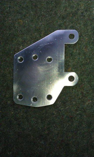

    OK .I'll start with 50 back and 30 down plus adjustment either way. Will make 6mm templates first. Will make a start tomorrow.
  16. megawatt
    megawatt Well-Known Member
    Jan 27, 2011
    2,479
    522
    Pre production prototype is finished. It's 6mm not 10mm, just to try footrest positions. There are six possible at the moment.;

  17. mpgscott
    mpgscott New Member
    Sep 30, 2012
    62
    11
    Thats looking good Alan, i have to say the plastic ones worked a treat for me today did around 120miles and what a difference its so much more comfortable. Anyone wanting to be more comfy on the Blade then drop megawatt a PM to get a price cant stress how much of a difference its made lowering and moving back the pegs..

    522
    Thanks Mark, must have a play with some Delrin! Just had a long chat with Gary (Muffking) and will be posting the prototype to him tomorrow!
