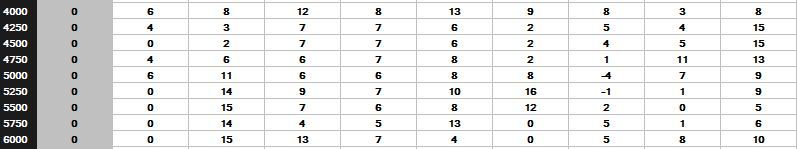

    4k to 6k rpm ... cruising speed on my custom map:

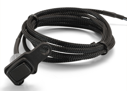

    Quite like this:
    Can't find it anywhere though!

    That looks the same as my DJ one.

    Yep... but DJ want £44 + postage for it ...
    It's a 2-way basic switch! :(

    Red = Richer
    Blue = Leaner
    That is base map v custom map... now I can see where all the fuel is going! :D :D
