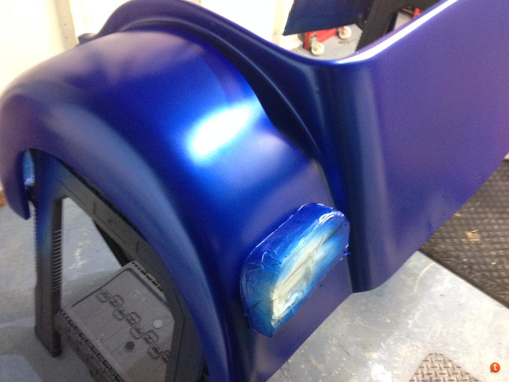

  6. Remal

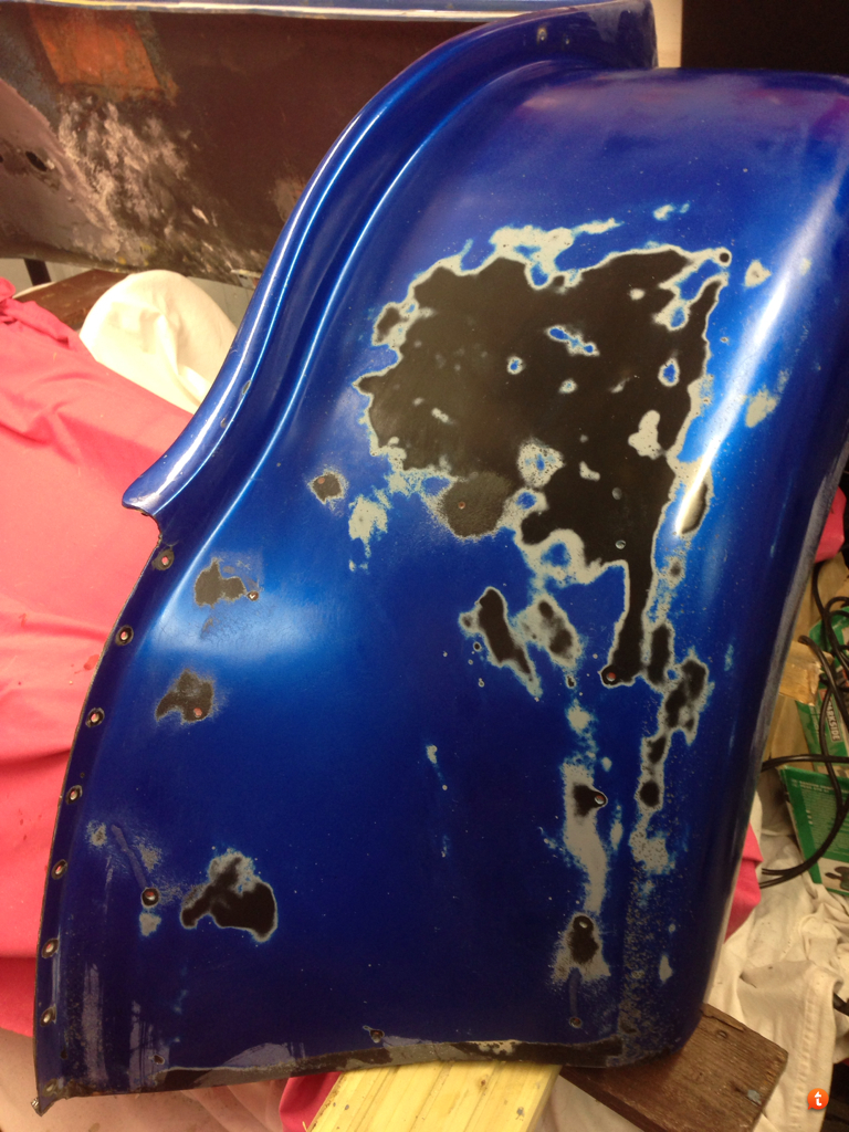

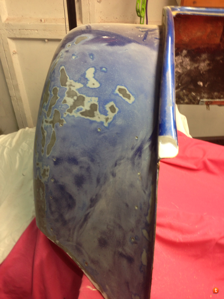

    More bodywork prep
  7. Remal

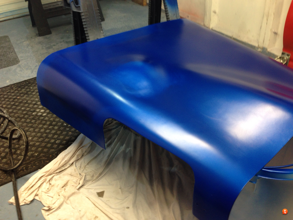

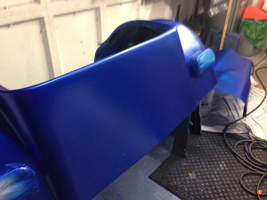

    Will be painting the scuttle Saturday . Then once done I can fit the screen
    Picked up my pain today. £48 per ltr for the blue pearl
  8. Remal

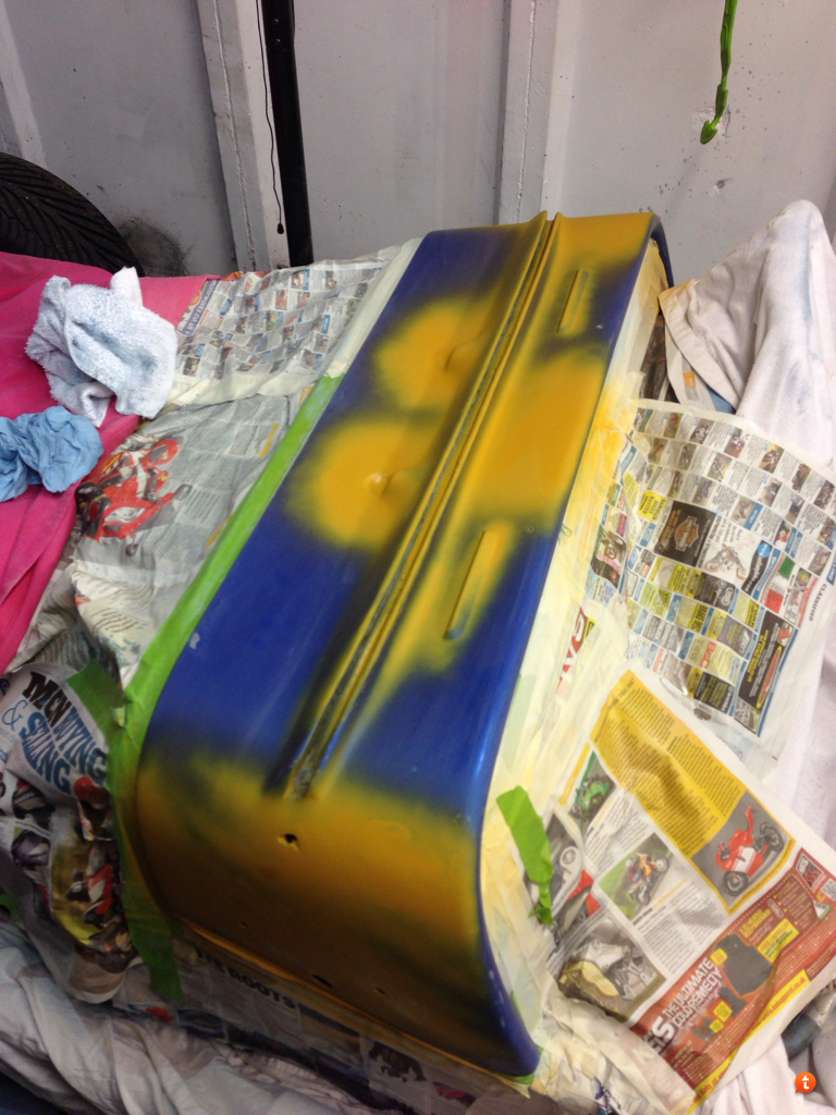

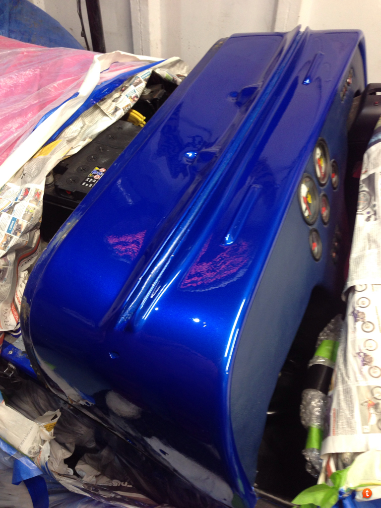

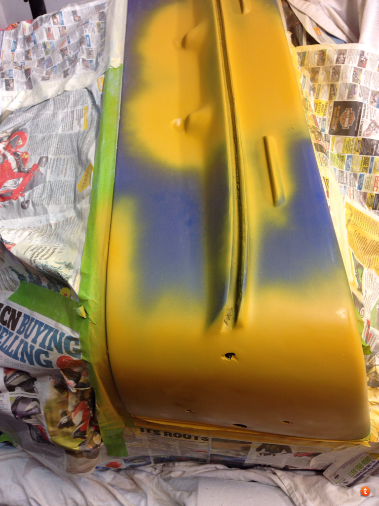

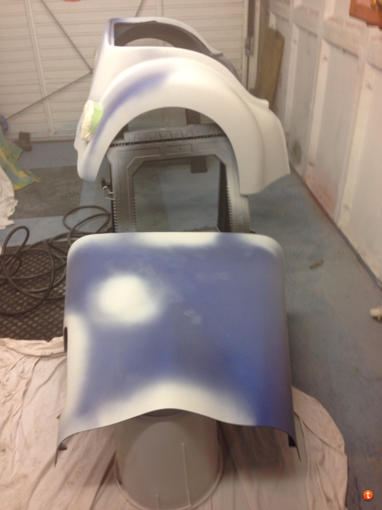

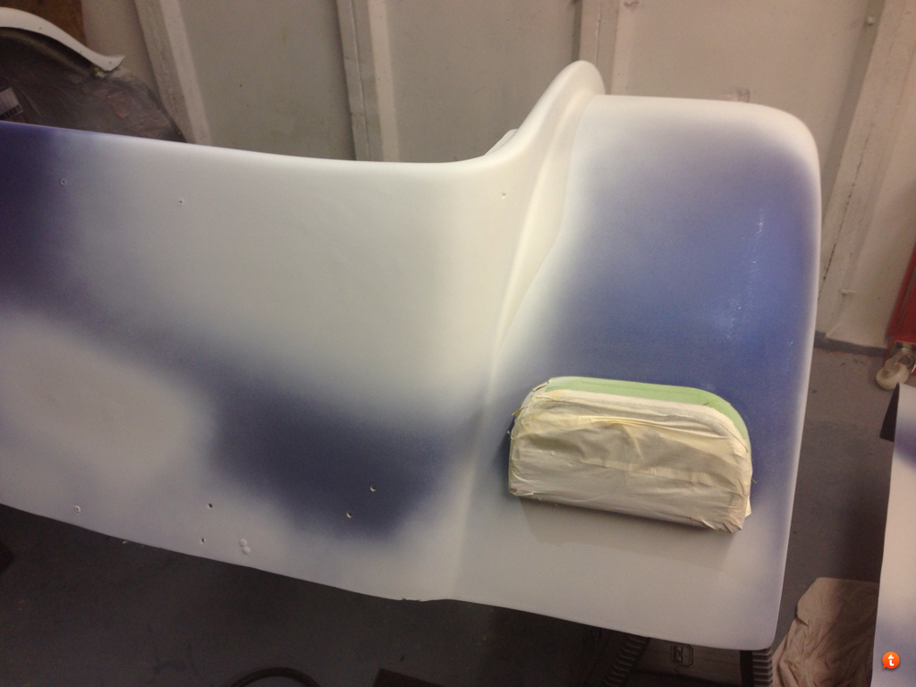

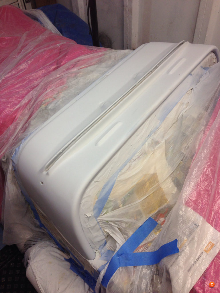

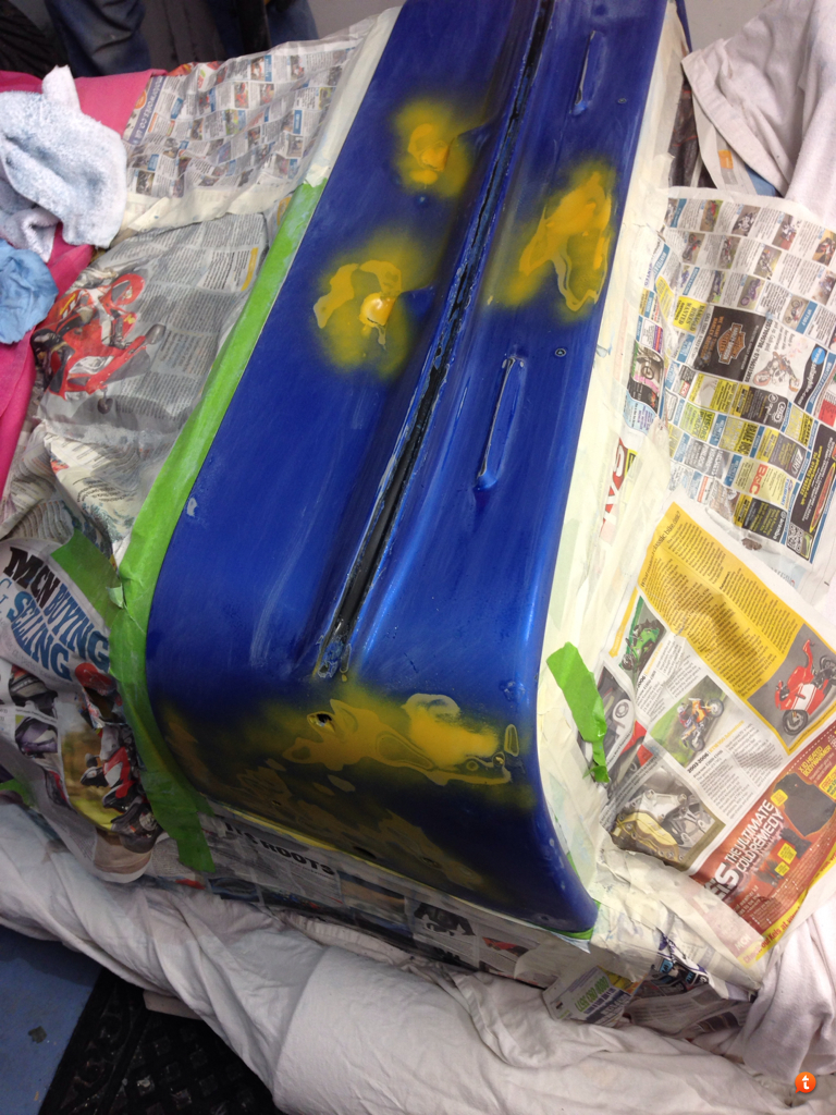

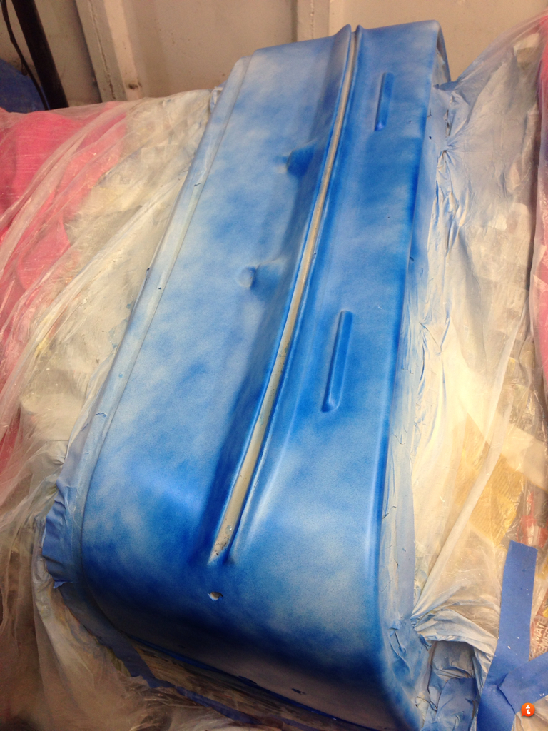

    Spent a good few hours today spraying the scuttle/ dash up today. Once finished I can fit the screen

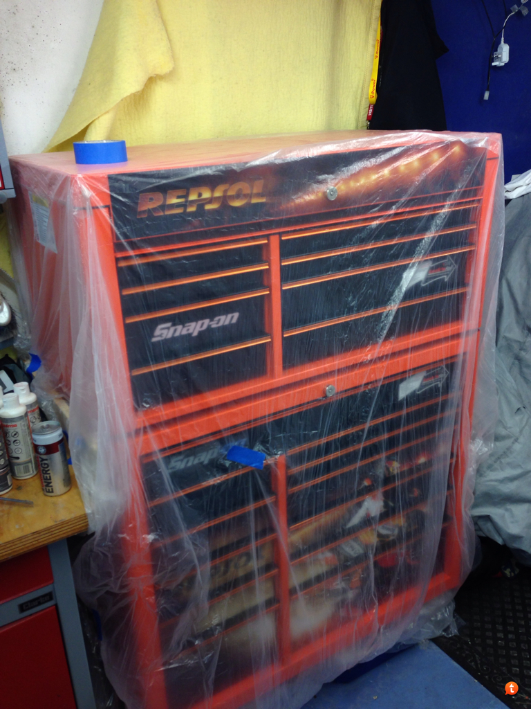

    As well as covering the car the tool box needs to get covered

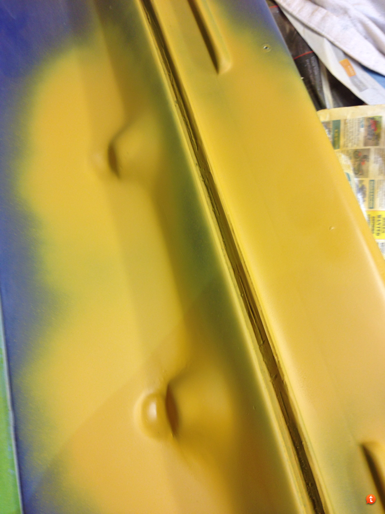

    Last bit of prep

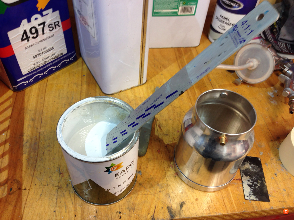

    After high build primer goes gray primer

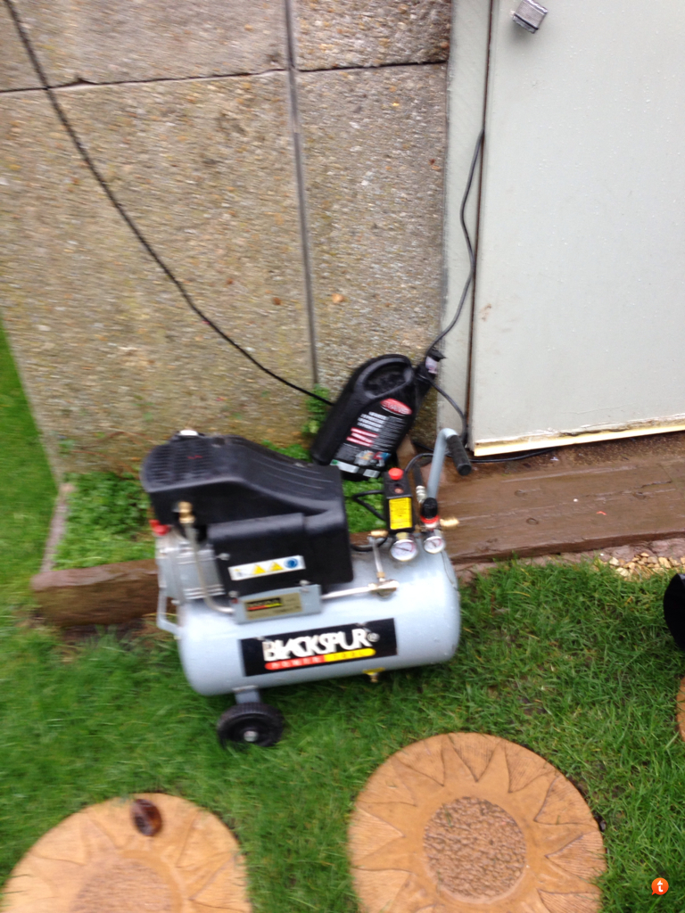

    [​IMG]only using a hobby compressor
    3 coats if high build primer, 4 gray primer, 8 of blue and 6 clear coat

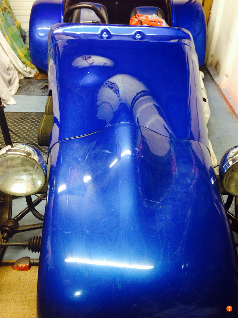

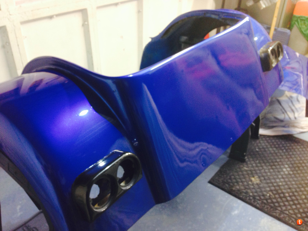

  10. Remal

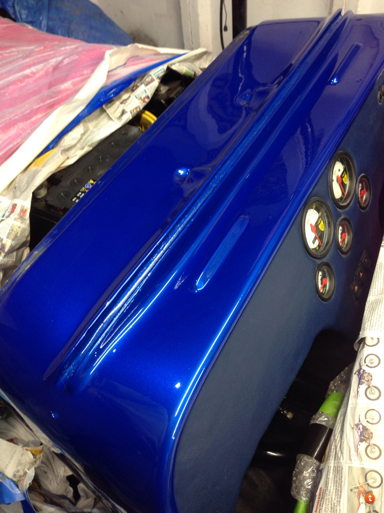

    well the match is bloody good considering the car was painted 10 years ago and it looks better in the flesh then on from my mobile pics
    next job this spring re-spray the track fairing again :)
    and happy how it came out when it's sprayed in jan in my garage lol

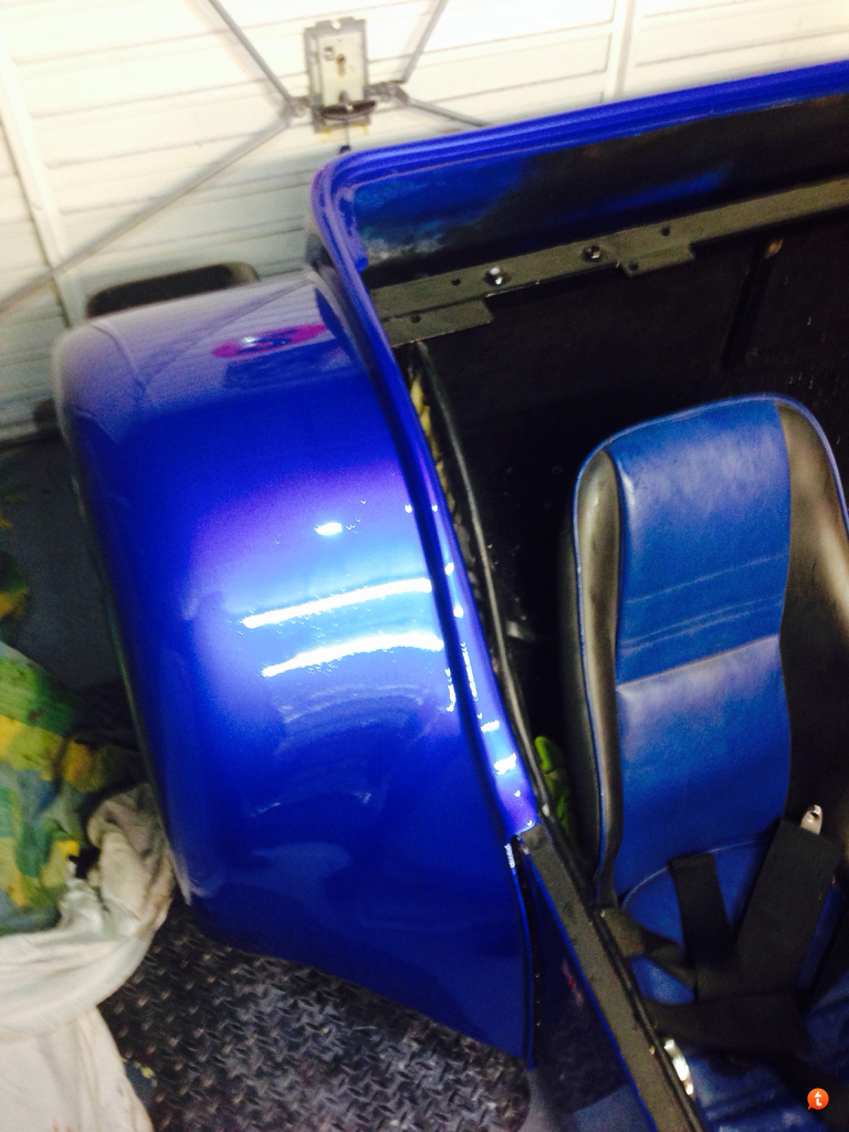

  14. Remal
    Well forgot to update this but the bodywork is almost done
    Very happy with the results and better than before, but still lots to do

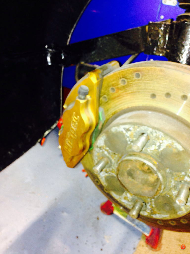

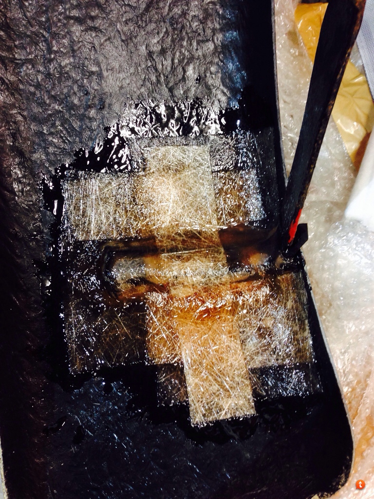

    Right my eye op tomorrow so won't be doing much for a week. Last few days I've been sorting out the front cycle wings. They are carbon and u don't want to drill and use a bolt so have used tiger seal then after 48 hours fiber glassed Over the top. Taking a while to do each side but not worth rushing
    Also going to clean and paint around wheels now
    I used panel degreaser before applying the fiber glass and it's sold now

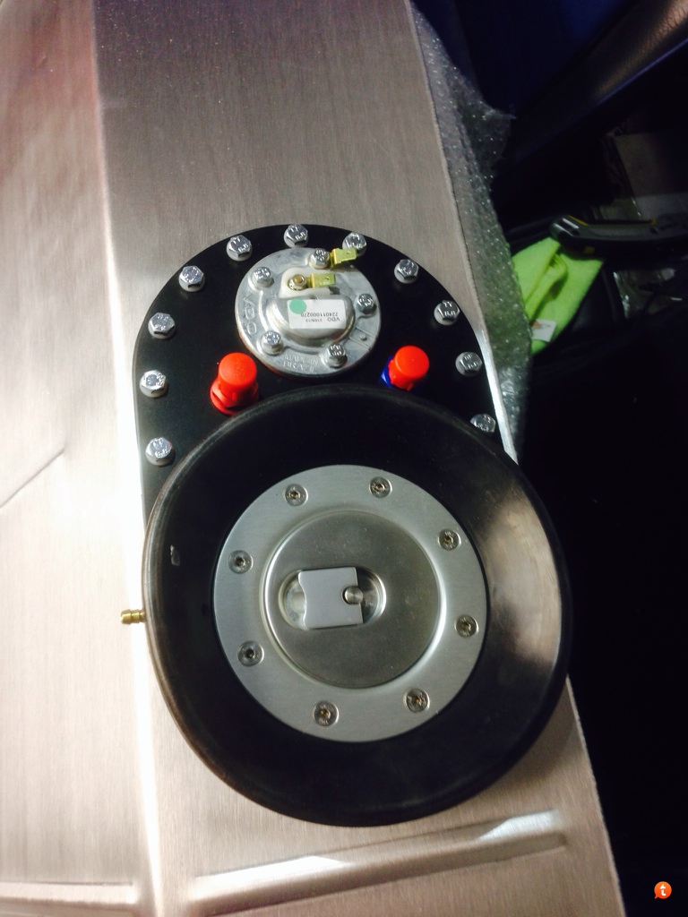

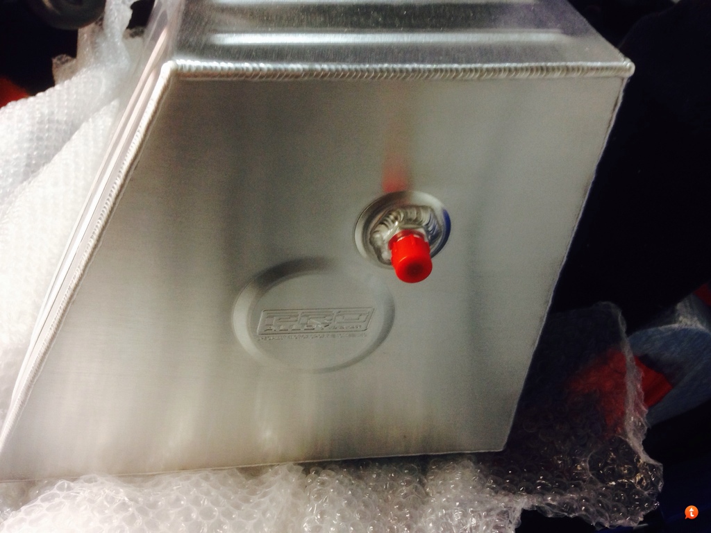

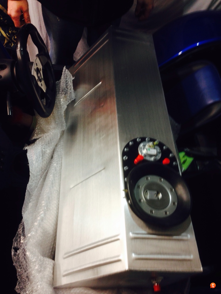

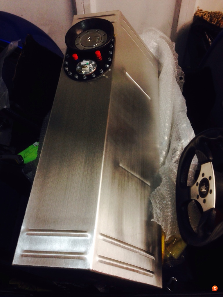

    New tank arrived today . Must say its a piece of art and very pleased
    [​IMG]fuel outlet on the right
    Also has a return on the top if I fit TB. Air valve and drip try [​IMG]
