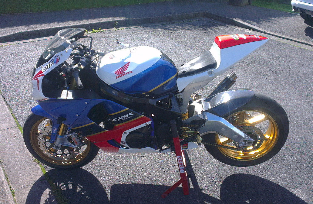

    OK well started work, decided summer is over and went for it :) I have a new tail to go on her so first job was to trial fit and see if I liked it before I strip the whole bike down down the the engine work. Even though the tail came off a blade it was the 93 model and unfortunately the frame is different so doesn't fit as is.. Nothing is ever simple :)
    So managed to wire the new subframe in place and take some photos, its not positioned perfectly of course but you get the idea. Bit of a CRT look going on I think :)
    Started to make some paper templates for the new subframe sides so it will fit the RRW frame, will make them out of thin plywood to make sure its all fits before giving it to my buddy to make in alloy

    That looks lovely, swinging arm is mint. As it happens if anyone else is thinking of fitting an RSV swinging arm I have a brand new one still in the box lying in the garage !!!

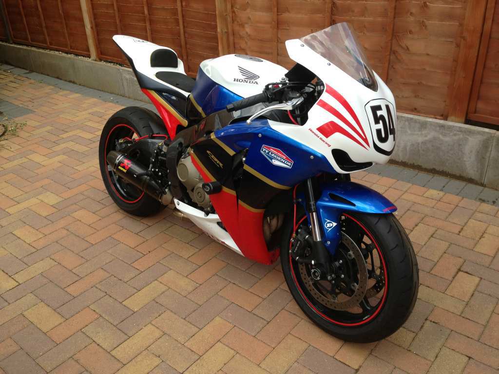

    Lambchops any chance you could stop upsetting me with those flourishing mods !
    I can't look at mine anymore.....
    This will be project blade sometime next yr...
    Ummm rsv swinger ? You haven't got a patent on the design have you pal ? Lol
    Seriously though keep those pics coming its great to see a morphed blade..... Top job fella

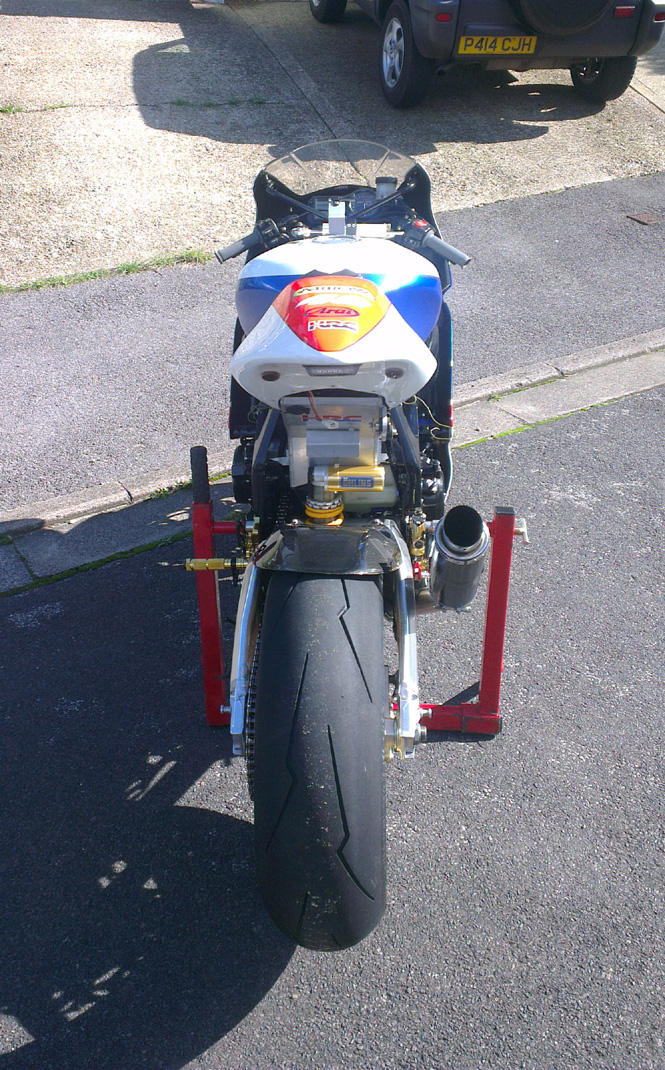

    Thanks guys. Well did a bit more today with the new tail, took my paper template (must have made 9 of the buggers to get it right) and bought some thin wood board and jig sawed out my best template and screwed it to the alloy subframe so its supporting its own weight. I think im happy now with this and its time to drop it around to my buddy to get its fabbed up in alloy :)
