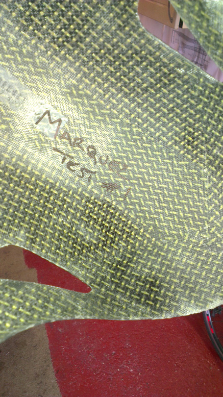

    HOW F-ING COOL IS THIS!!!!
    It even says inside Marquez test 1 :) not mounted yet of course, just rested on :)
    I open the bidding at £500 hehe

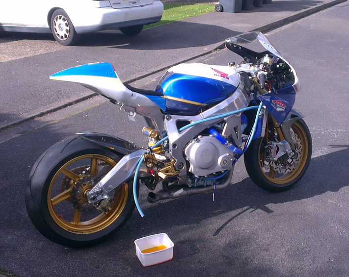

    Well just finished.. It has lost about 250ml yesterday so topped it up. Ran it today started dripping right away from cold before the thermo was even open.. Rad was super cold so wasnt letting any hot water through. Anyway dripping continued until it reach about 100c when it stopped due to a lower level in the rad. measured what it lost and its around 250ml so about the same as what I put in.
    Anyway I used this florescent stuff and now its eveywhere haha, bloody have florescent greens keys on the laptop now after typing this!! haha
    So will drain off some oil later and check it for colouring,
    What havent done is give the bike some beans, not reved it past 3k. so gave it some beans 8 - 9k and loads of air came through. Im thinking perhaps ive had trapped air and because ive not reved it properly the waterpump has been able to shift them. Now perhaps its going to be ok was just trapped air!! I bloody hope so!!

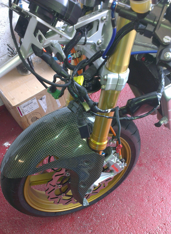

    Yep indeed!! I cant believe it SPS. RCV genuine bloody parts and not only that ones removed team riders spare bikes!!! Still cant believe it even with it sat in the garage! Missus isnt impressed, well she wont be when its in the front room tonight!! haha

    That mud guard looks cool! Is it going to be an easy fit?
  11. lambchops
    lambchops Elite Member
    Aug 21, 2013
    2,885
    1,606
    Not too bad I dont think Martin, going to need a bracket from the standard mounting on the forks to the mounting holes on the mudguard. Going to have a play today :)

    Anyway another couple of pics of the fender fitted :) Well fitted with wood mounts as ive run out of alloy so will have to remake them
    and one from the motogp bike.. Now I think I need the complete fairing to match!! :)

    Thanks hump :) ive tried the coolant bottle mounted higher doesnt seem to make any odds..
    OK latest installment of operation head gasket.. I think after yesterdays revving antics perhaps I had some trapped air as the oil I removed to rest overnight has not separated so looks like the Evans isnt seeping in to the oil.
    So im thinking perhaps the coolant im loosing is the natural heat expansion (have an Evans and die mix at the mo). So just topped up the rad yesterday and today have just ran it up and captured whats been expelled via the overflow to the res tube (which is about 100ml). So will check the level in the rad when its completely cooled (will measure down till I hit coolant). Then fire it again tomorrow and if no more coolant is lost and the measure in the tank is the same when its cooled again then perhaps that's it just needed to find its level... My hose arrangement to the rad is not stock so perhaps this has caused some headache with trapped air..
    Anyway as always a pic :) thats just tape on the tail to see how I want it painted
    #896 lambchops, Mar 21, 2014
  17. Gilesy
    Gilesy Elite Member
    Aug 31, 2013
    2,081
    1,181
    wondering if you need to move the expantion tank :eek:.. its position and "height" in relation to the rad must be causing some of the airlock..
    I'm sure once all the air is out it will be fine..

  19. lambchops
    Aug 21, 2013
    2,885
    1,606
    hehe thanks Phil,
    Well Ive had an brain wave today after losing coolant everytime I start the bike even if the radiator is only half full before I start. I now think the water pump is flowing more liquid than the radiator can flow. So the coolant hits the rad and as its a small rad the fins cant flow the coolant quick enough so its builds up and flows out of the overflow.
    So the rad is acting as a bottle neck in the system. The rad is half the size of the RR4 rad remember so half as many fins to allow coolant across the radiator. If I turn the bike off when warm the fluid bubbles down to half way up the rad, start the bike and instantly the fluid is up to the top and the overflow starts dripping.. So im going to buy a second hand RR4 or perhaps RR6 rad (as its slightly smaller) and then try again, im sure this is the problem...
  20. kev.b
    kev.b Well-Known Member
    Jun 8, 2011
    953
    697
    Think you will need the bigger 04 or 06 rad as the 1000rr engine gets pretty hot . Dont think the 900 rad will be up to the job .
