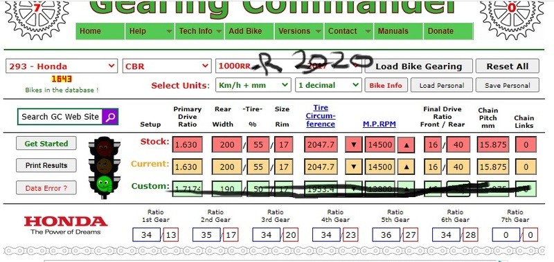

    The motorcycle portrayed in the video footage uploaded to the YouTube streaming platform that was subsequently linked in a message post made in this thread, portrayed by way of sequential moving images 14,000rpm on the tachometer, all while the gear selection numeric display indicated it was in 5th gear.
    It wasn't that cryptic of a statement.
    And I have put the gearing data into Gearing Commander and for the most part the speeds displayed in the gears at the rpms are within 5 to 8kmh
    This bike is stupid fast. Now some of the excess revs can be attributed to being on the side of the tire and the appropriate gearing change but still I am going to predict the bike runs deep into the 315 to 325kmh range with very little effort.
    Stock sprockets are 16/40 fer Chris'sakes!!!! I think Honda means to make some kind of statement with the SC82.

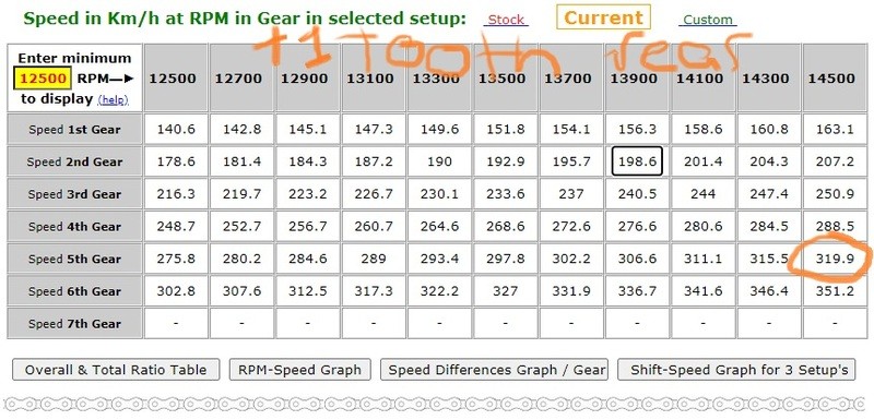

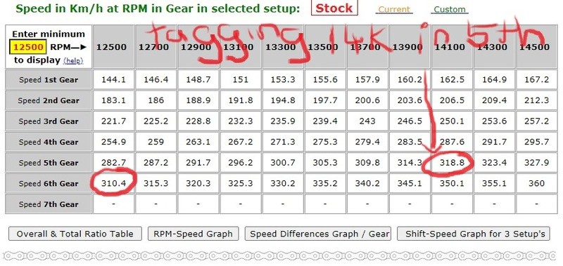

    That's probably a good 310kmh at a true 12,500rpm 6th.
    Tagging 14k in 5th should be good for 315kmh
    6th is way tall and so I can see 5th being the practical top gear if you add a tooth to the rear sprocket.
