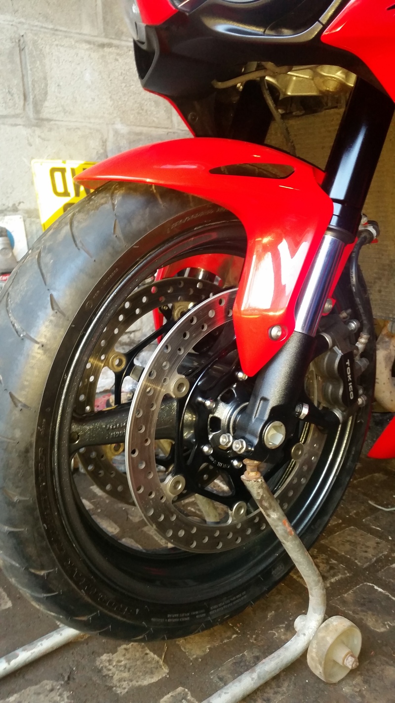

    Right, I managed to get a bit of time today to pick up my stuff. The pics are below. It is really hard to get a good photo of the wheel colour but you can see the amount of flake in the finish. They're stunning. The hangers and footrests are awesome too. Hopefully I'll get a little time tomorrow to fit it all. Tyres are on etc but just need to fit the bearings now and I can refit them.
    There is some dust etc on the wheels but they've not had a coat of polish to protect them yet.
    You can see the flake in the pic below, along with a blatant plug for Tony at Perfectadent. I'm sure he could do stuff by post if needs be but for locals in South Wales he's worth a visit. His work is exceptional, everything is dipped and stripped before blasting to key the surface then minor fettling before powder coating. He's not a fly by night guy and you just know that his work is going to be good for years, He's very reasonable too.

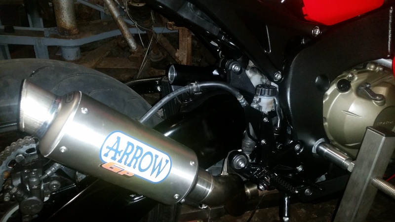

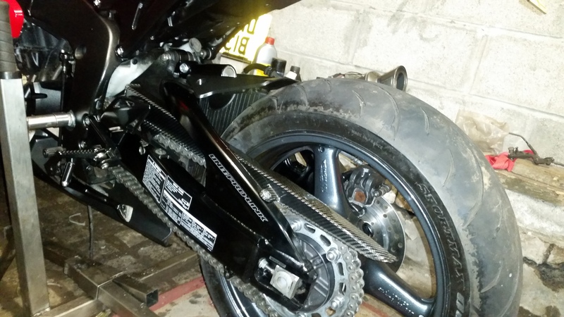

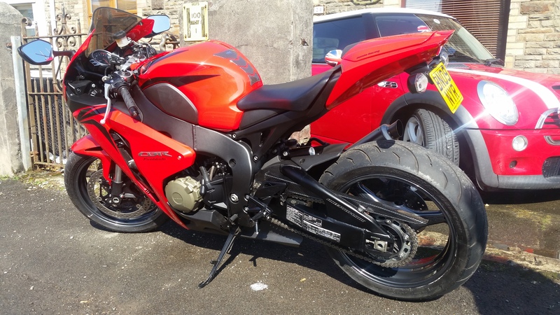

    Got up the garage at 7 this morning, had a bit of time out to do some other stuff for 2 hours then left the garage around 6 this evening. I got loads done and all that is left is to give the front callipers a bit of a service tomorrow then it's finished.

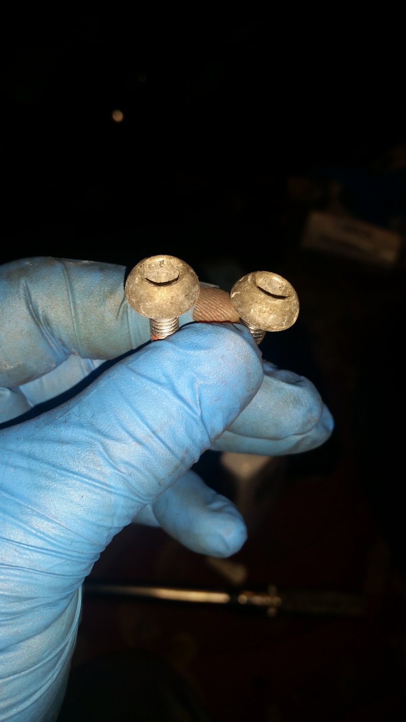

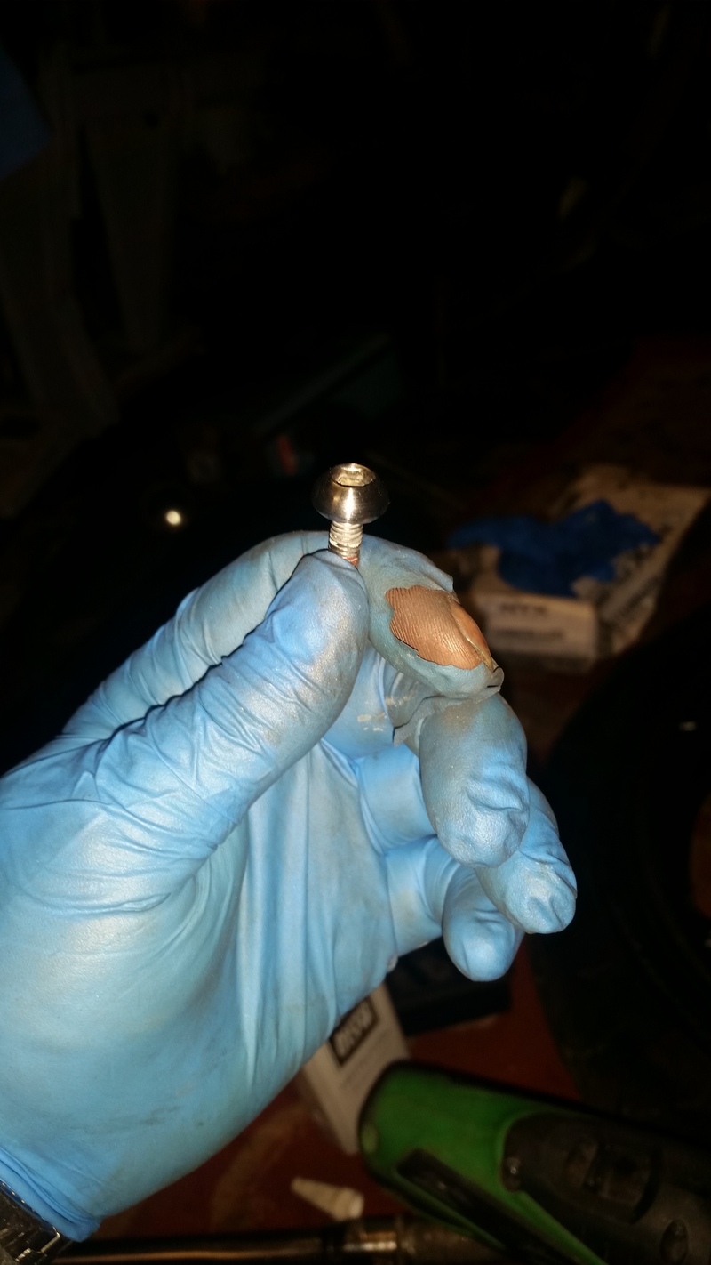

    Making a start, I refitted the bearings and seals then gave the wheels their first coat of Autoglym wheel cream to give them some protection, but when I went to fit the discs, all the mounting bolts were looking like this:
    Sticking them in the battery drill and shining up with some 400 grit W&D then a quick spin inside a rag with a little Solvol saw them looking like this:

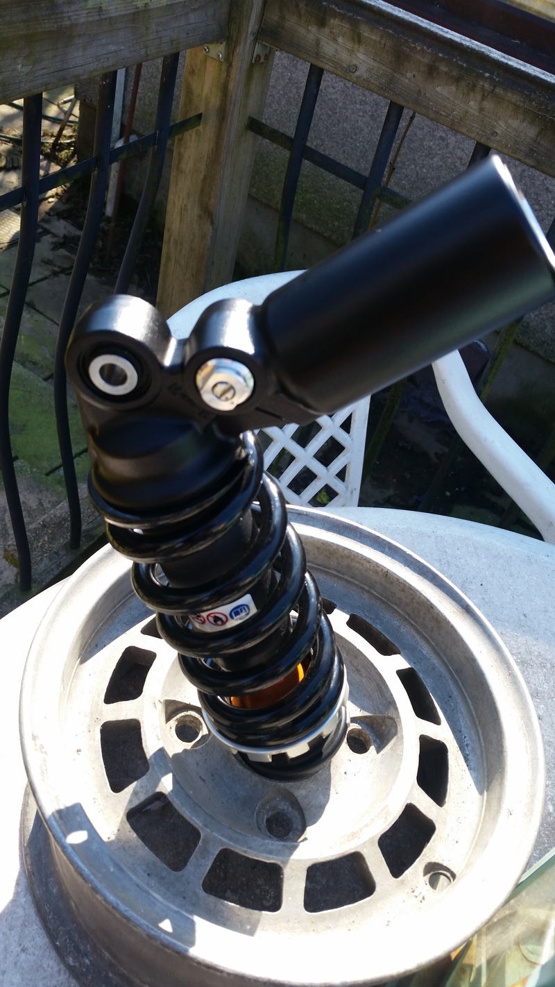

    Next up I couldn't fit the rear wheel without making sure the shock was spot on. I gave the top of it a quick once over with 400 W&D before masking it all up and giving it a lick of etch primer then some satin black. Much better!
    Next I turned my attention to the R&G tail tidy. and new 7x5 plate.
    Next up was the powder coated footrest stuff and exhaust.
    Then fitted the powerbronze chain guard.
    I really need to get a full set of braided lines to finish things off.

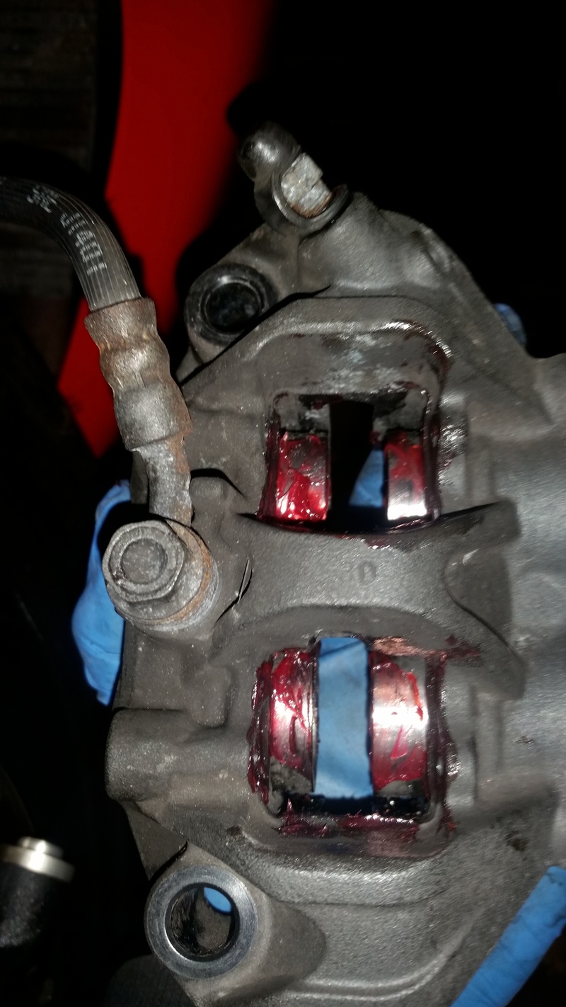

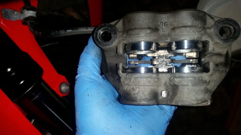

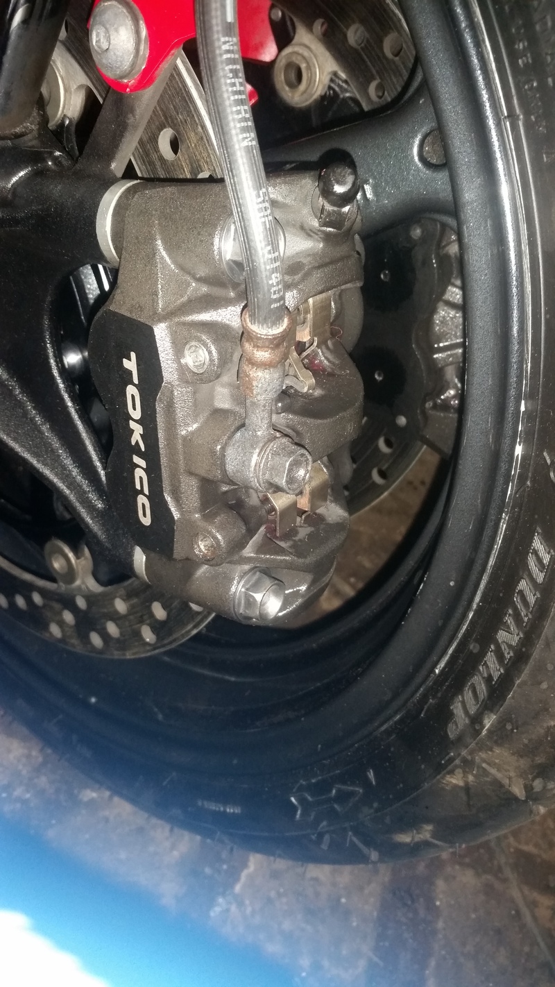

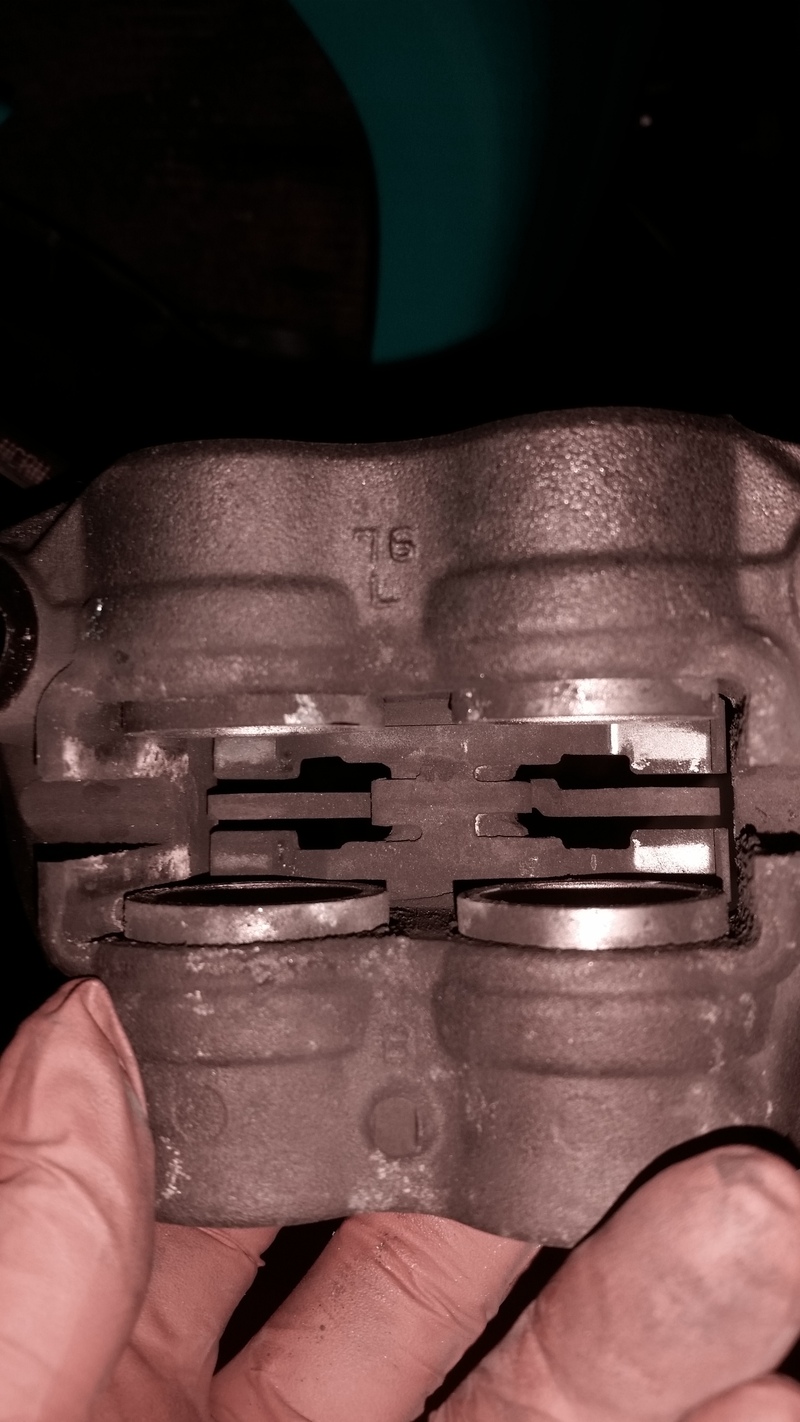

    I took off the caliper this morning and once the pads were removed the pistons looked like this:
    A little brake cleaner a and a toothbrush saw them look a little like this:
    I smeared a little Castrol red rubber grease around the pistons like so:
    Then pushed them all back. This has a tendency to move the other pistons back out a little and spreads the grease around the seals so make sure none of them pop out of their housings (one of mine did a little but I caught it before it came right out, but it went back in, then it needed a little bleeding as there would have been air in the caliper which can compress, and sure enough the lever went a little spongey).
    Next the pads were cleaned and the edges dressed lightly as they are meant to slide inside the caliper, I also put a thin smear along the vertical edge of the pad but not too much.
    Once the pads were back in, the caliper was bolted back up following a wipe down with ACF50 and a rag. The lever was then pumped to get the pads against the disc.
    I found the easiest way to bleed off a little air is to open the master cylinder pot then place a large syringe on the bleed nipple with a long length of clear hose then pull through some fluid until all bubbles are gone.
    You could reverse bleed it if doing a fluid change out with the syringe but I only needed to pull off a little air. Topped off the pot and it's done!

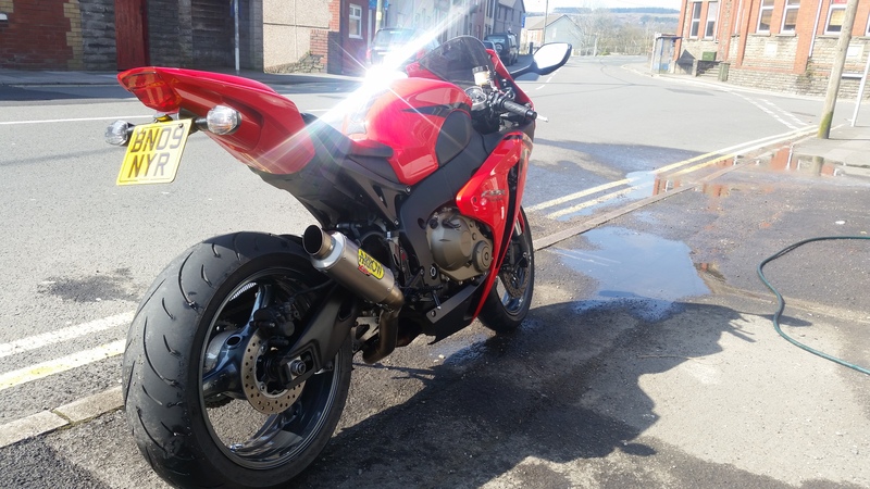

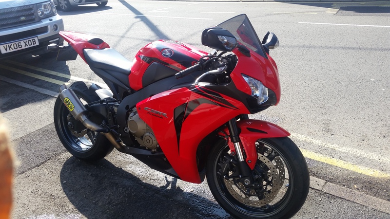

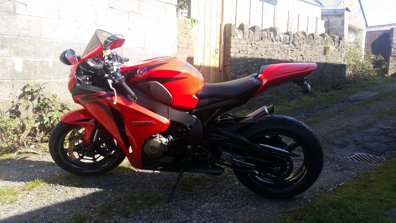

    That was it. Everything was torqued up and it was time for a shake down.
    I have to admit the Arrow is VERY fruity and WAY too illegal! Ear plugs are a must!!
    I had the arse end slide out when leant right over which had my arse twitching but I think it it's down to the edge of the tire having some tyre dressing still on there since I bought it.
    Also the idle is slightly high at around 1500-1800 but I think thats more to do with the Arrow. Can you drop the idle on these?
    When I got back there was some traces of salt and grit other so its had its first wash and brush up.
    I'm really pleased with this bike. :)
