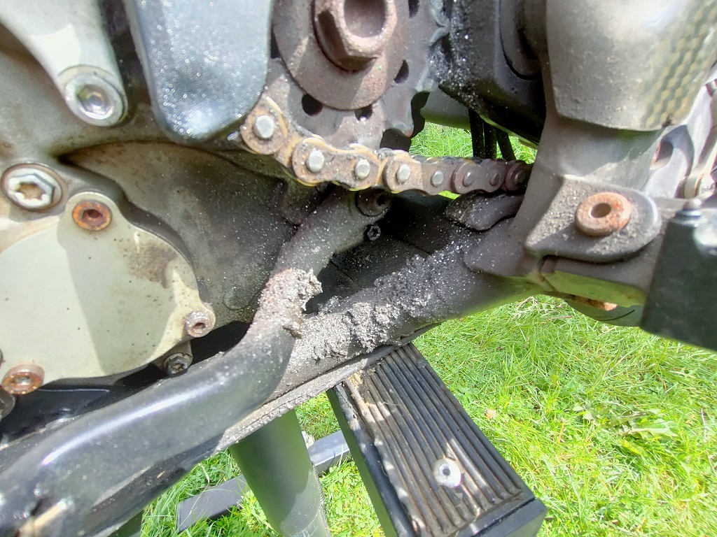

    While tightening the chain I noticed a fair bit of material on my back sprocket seemed to be missing. :confused:
    Oh no - it's not missing - there it is. :D
    I don't know - was my first alloy sprocket. Maybe a thousand miles is ok milage for one.
    Anyhow - have ordered a steel replacement.
    ...and taken the opportunity to go up a tooth to 47. Can spare a litle top end and the 5th-6th transition is a touch tall on uphill stretches sometimes.
    (mainly due to the baffle robbing power - could still use a rejet)
