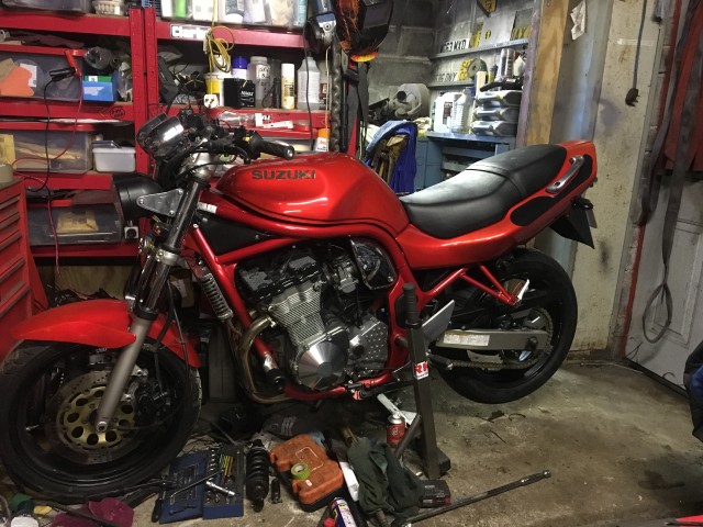

    Removed the grab handles and run them over the wire wheel before polishing them.
    Removed the air box and sprayed acetone (it’s all I had handy) in there when turning it over. I did drain the float bowl first tho to at least purge it of old stale fuel.
    Stuck the tank back on losely and it seems to be running just fine.

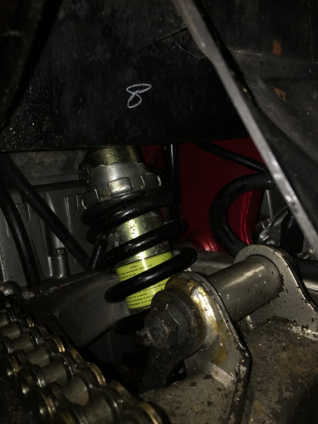

    Now I know it’s a runner I’m happy. Been back up the cave and fitted the rear shock. That’s the start of the improvements.

    I fell lucky with the shock on ebay, it was from a 1200 so should have plenty of support and a slight lift as it is about 6mm longer and only cost me £45.

    Well, that’s the basics done. I scrubbed the chain today with parafin and re lubed it with Wurth dry lube and it looks like new! Got all the bodywork back on after a quick polish, I stripped both front calipers and popped out the pistons, cleaned them up and gave them a coat of red rubber grease and managed to clean the rear caliper piston and worked it with a coating of red rubber grease but didn’t strip it as it wasn’t seized. I also modified an SV650 chainguard to fit.
    Front calipers bled up nicely and there’s a firm lever. If I can get it insured I’ll see if I can get it MOT’d tomorrow otherwise it’ll be next weekend as I’m on a course all week next week.
