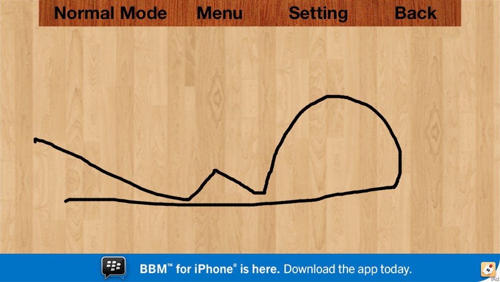

    Don't laugh but these clips look summat like this what are they called doing my head in [​IMG]

    I've been using these for a couple of years now, easy when you have to change from wets to dry of the other way around 5 times a race day ;)
    this year I have used the wire from a bike brake with an elctricians eye on it instead of doind the lock wire on these clips, if you want a pic I'll get one taken so you know what I mean, very easy to use and cheap as to buy

    Good old R Clips.

    Good pic that's what I need on my dipstick cheers wedgie.As a pain otherwise to lock wire the dip stick Everytime I want to dip the oil.:D

    Ha ha it was my 3rd attempt with these bloody arms ! Lol

    Now it's what size r clips

    Ordered 1.6mm if wrong ill keep ordering till right ha ha
