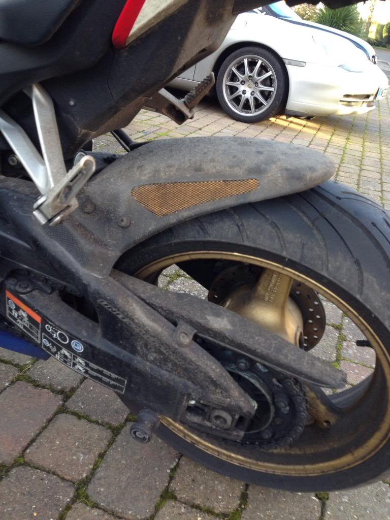

    Can't understand how anything rusts when you lube it properly, that's the trouble with you OCD cleaning boys :cool:

    I cant look at that picture. its making me go funny.

    Nooooo, it's sooooo wrong. It needs to be cleaned....

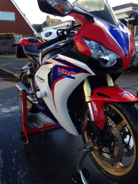

    Guys and girls, they are all just fast depreciating lumps of plastic and metal, but we all have different priorities, that's what makes the forum so interesting I guess. At the end of the day, under all that gunk, it was well protected and scrubbed up well and some a punter bought it from the dealer it was traded too, so they must have been happy, so alls well that ends well. When you buy a used bike, you don't always know what you are getting is my motto.

    I love the HRC paint scheme. Looks the dogs.
