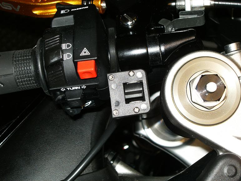

    What switch did you use & where did you position it? Any pics of it fitted?
  3. ColinBR
    Hi Ray
    I got the map switch from CMC chesterfield. It's the actual map switch dynojet advertise. I mounted it on the left handlebar next to the clutch clamp. I'll get the pics up of the fitting at the weekend if I get some time.
  4. ColinBR
    The fitting is different on your bike though. I think u need the hub to fit the map switch to the pc3.

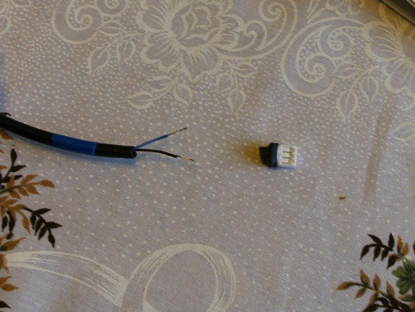

    It's not quite a plug n play like ud hope. But simple enough. You just have to put the wires into the rear of the unit. I'll post up the pics so u can see what I'm talking about. I'm not that good at describing things ;)

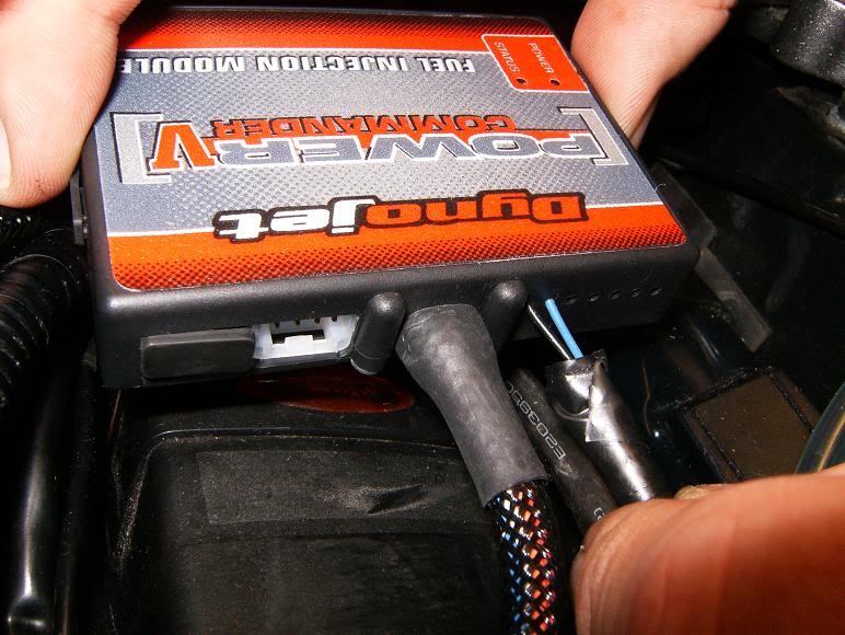

    I read through the instructions that came with the PCV, and from what I can gather, you need to strip the cable back & then feed them both into the PCV box?
    If that makes sense...
  8. ColinBR
    Exactly that mate.
    It come with a small 3 prong plug attached to the end that u cut off, strip back the wires, and feed into the back. I soldered the wires for a better connection.

    Hi Ray
    Here's the pics of the map switch fitted
