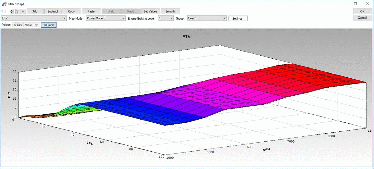

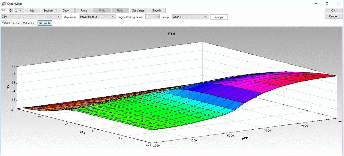

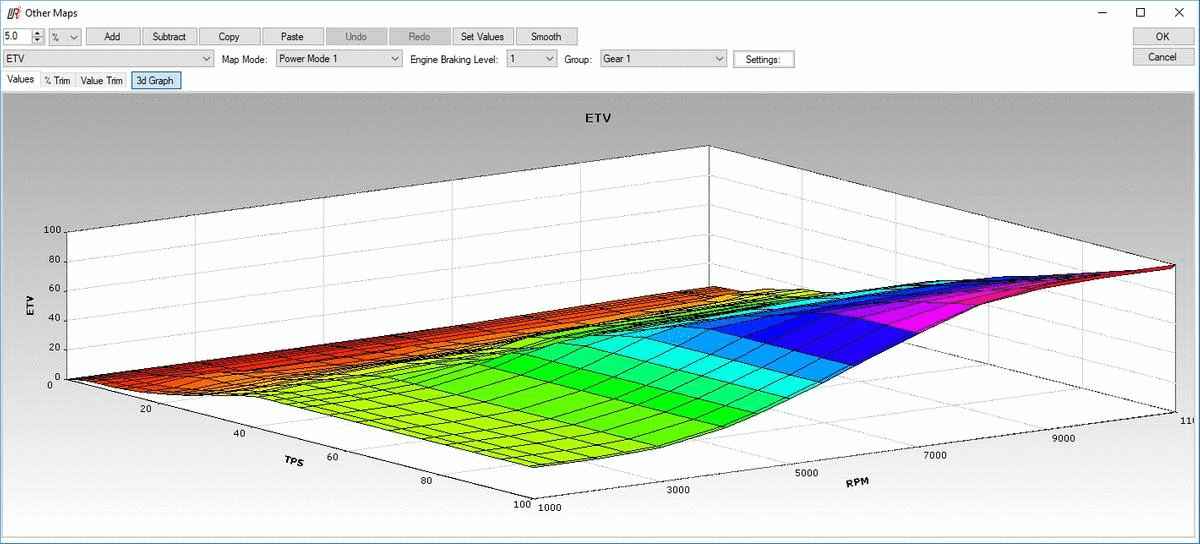

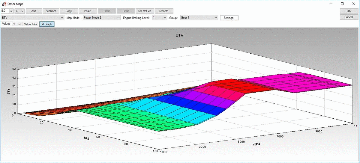

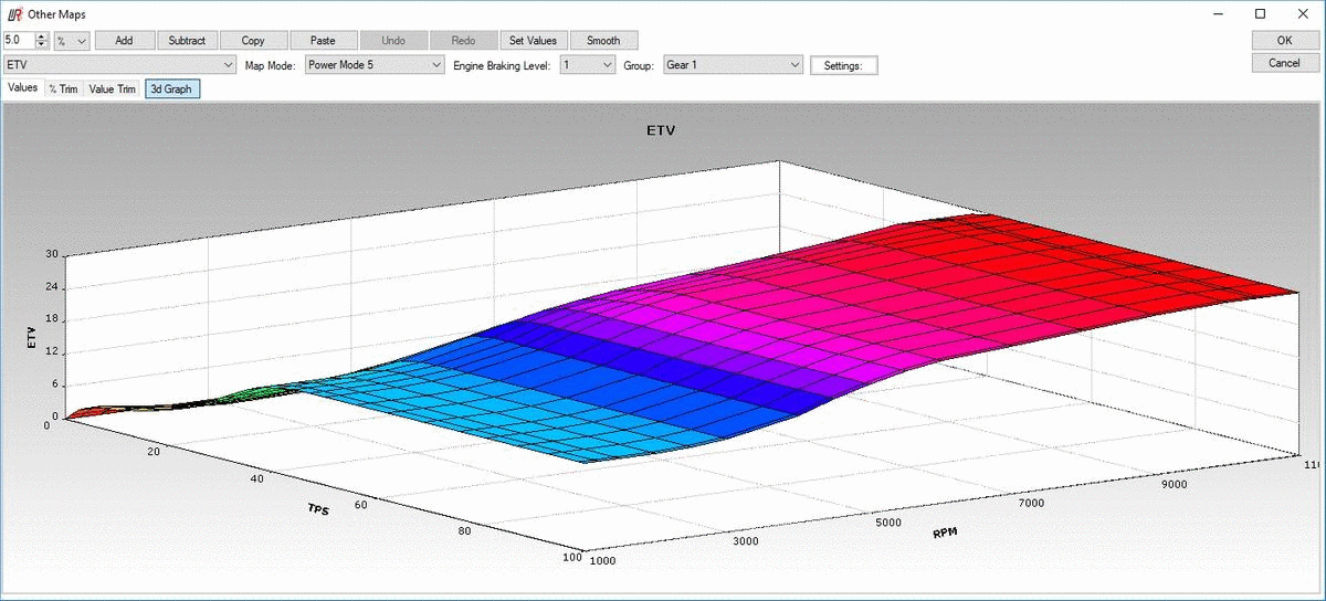

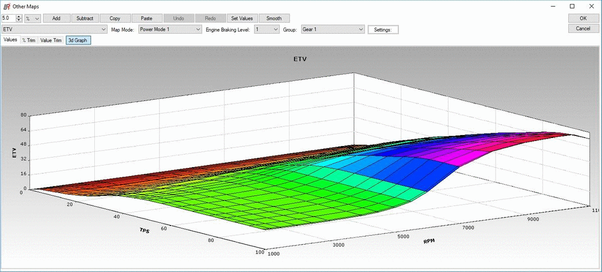

    To give my bike a bit more kick in the pants and have it behave as originally intended, I have remapped to the ETV tables to the Euro/UK spec - bike has a new personality. With the US maps the bike did not even carry full throttle past 10,000rpm.
    US Power Mode 1 Gears 1 - 6 ETV maps
    US Power Mode 3 Gears 1 - 6 ETV maps
    US Power Mode 5 Gears 1 - 6 ETV maps
    Euro Power Mode 1 Gears 1 - 6 ETV maps
    Euro Power Mode 3 Gears 1 - 6 ETV maps
    Euro Power Mode 5 Gears 1 - 6 ETV maps

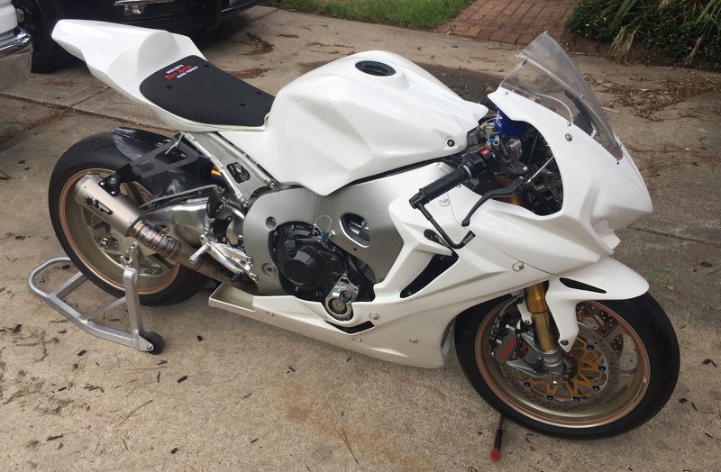

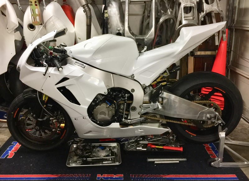

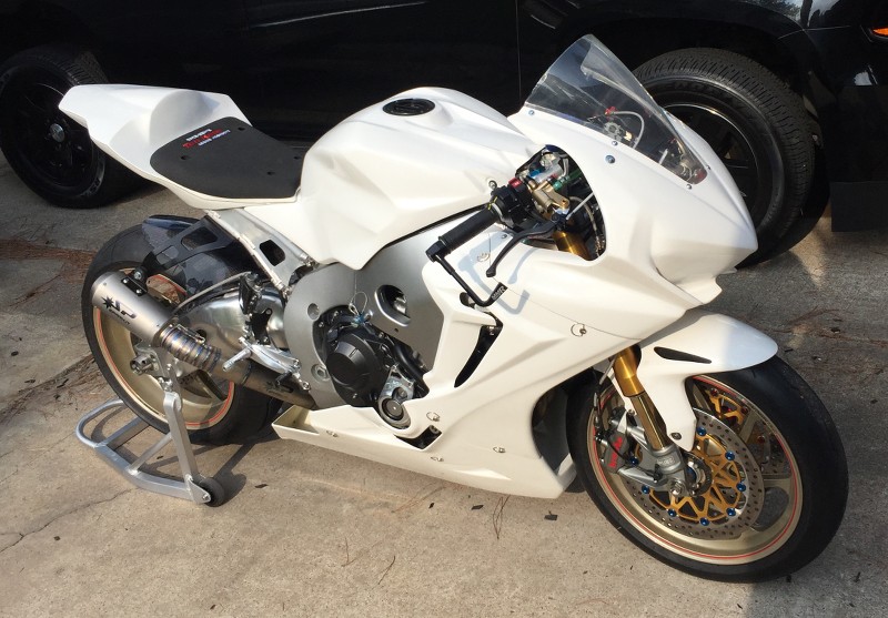

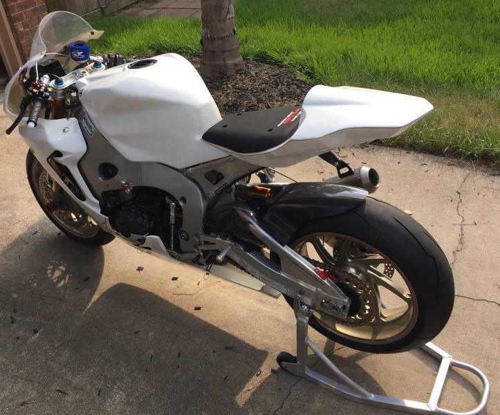

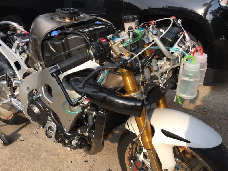

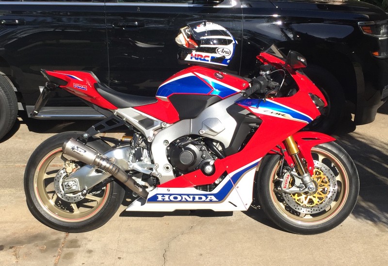

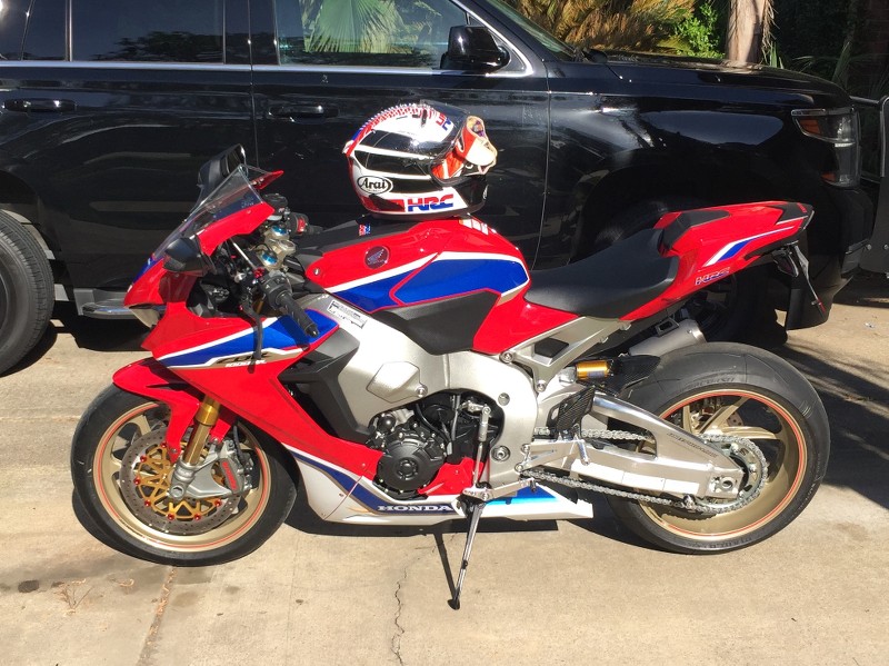

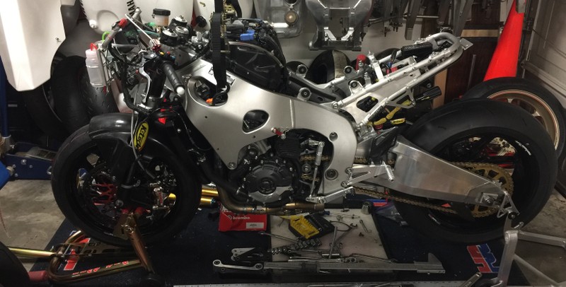

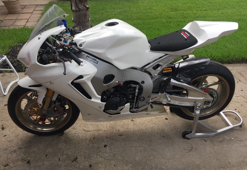

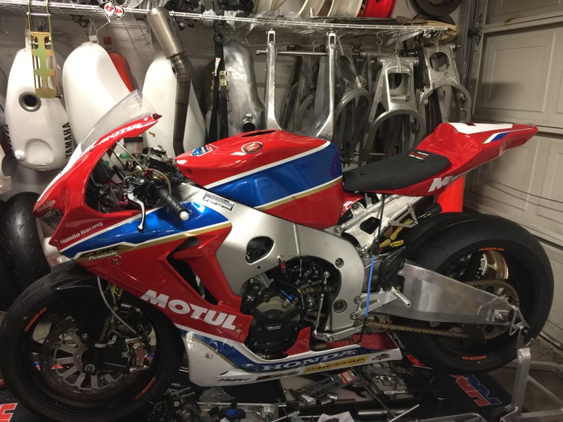

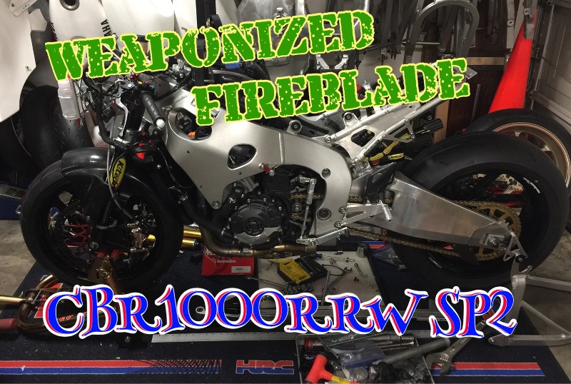

    Its been a while, but my bike has gone from stock:
    To this:
    To this:
    Then this:
    And is currently this - with either HRC Endurance bodywork or Honda Racing skins :)

    Well, you are right about it never being completed.
    We all know that Honda very unceremoniously sacked Ten Kate last year 2 + decades of dedicated support, research and development by Ten Kate into fielding as good a race bike as possible.

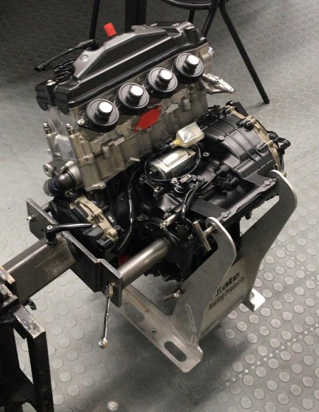

    One thing lead to another and when Ten Kate put the Redbull bikes up for sale, they offered me one - but I was not able to take them up on that offer - so I did the next best thing, snatch up one of their full blooded WSBK motors in Qatar race spec.

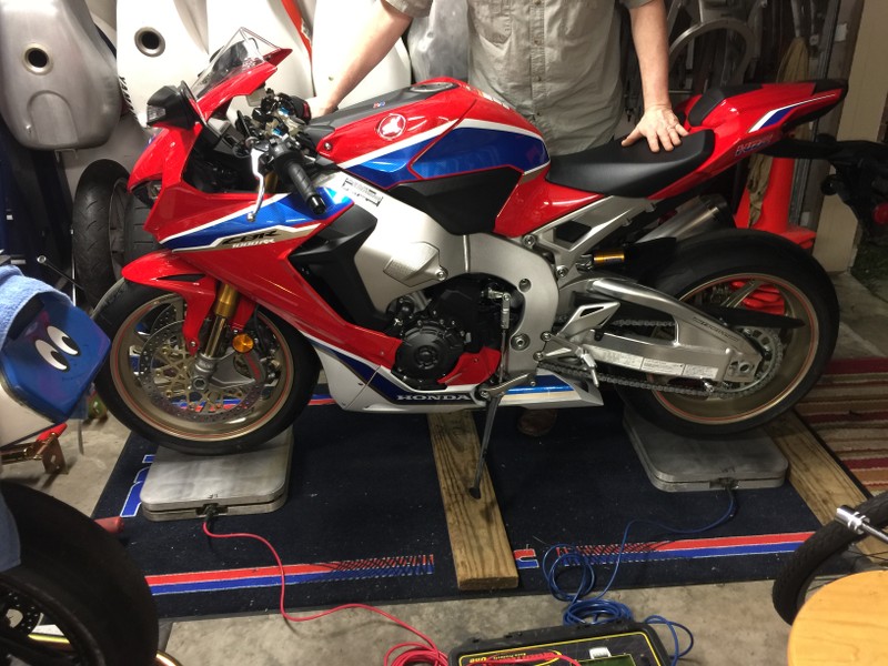

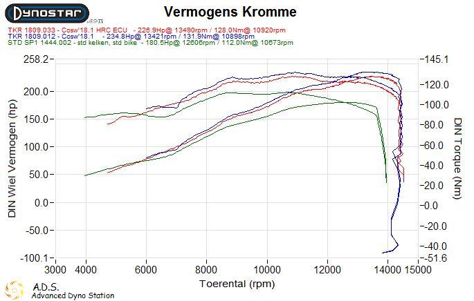

    I think this power plant is sufficiently developed and tuned and with all that torque available from such low rpms, it will be a case of pick a gear, any gear and then hold on tight :)
    My custom tuned HRC ECU is represented by the red line.
    Blue line is with Magneti Marelli in charge of the fire and fuel management.
