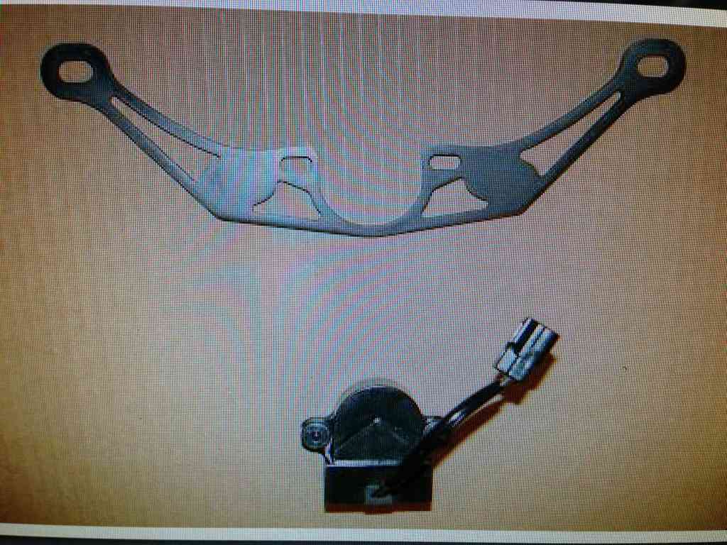

    have got my carbon clock mount, and I think I will need to mod it a bit to allow for the tilt sensor on the front like you have done

    Remal the rear will go over this plastic lip mate mine did on the 12 mine looked like it wouldn't but squeeze 2 sides together it will go over and when you drill the rear the 2 only mounting points are underneath they bolt to the most forward of the 4 bolts you need to squeeze together then drill so the under tray goes back on as when you remove the tray it widens well mine did . It will go over this lip and once over becomes quite moveable again
  11. Remal
    cheers Wedge, I've removed the undertray and will have another try. Still my only concern is taking the front wiring off the original nose and putting it back onto the bike. Seems the carbon clock unit does not have access for the tilt sensor so Will need to make something up was the front cage you had made up or from SES?

    Hi buddy yeah I took rear original under tray off and the lock key part and take the crc under tray off .I brought a second hand front loom of yorkshiregooner mark and stripped it down so its just got tilt and speedo wires that's it that way I unplug my complete front original nose with everything I have a hrc bracket that fits to the 2 holes what are left from removing original cowl there are 2 stubby push in to line headlight up it bolts to there I see your carbon one does not have this but all you need mate is a simple brace on the back of your unit out of 2mm alloy and a block with 2 holes to bolt your tilt to it
