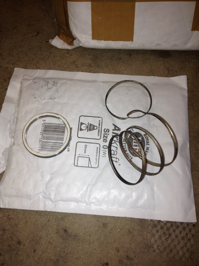

    First on the list was to fit the new exhaust gasket to the front cylinder. So it was back off with the left hand fairing for some more room and also I needed into that side for the other fix for today.
    Here's the old seal next to the new 1
    Once that was fitted, I re-sealed all the joins with fire gum and put the exhaust back togther, fired the bike up and thank fook it was all good :)

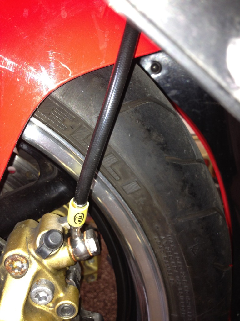

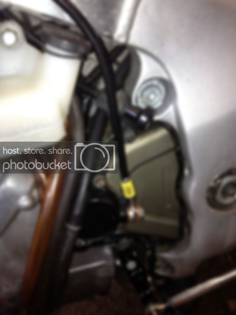

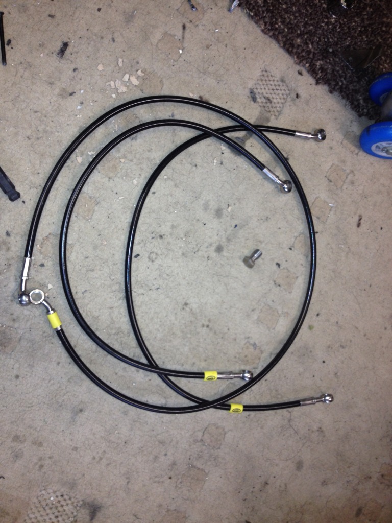

    Then on to the brake and clutch lines from our very own Arthur (thanks mate). The fluid in all the lines was well past its best, a not so lovely orange/brown :( , so decided to just replace the lines while I was at it.
    New lines laying in anticipation.
    And on the bike looking great
    That's all the must do bits done. Now it's just a case of putting a few miles on the saddle for the next few weeks, before doing all the major bits to the bike.
  8. kpone
    I'm no expert but I think it was wise to replace that gasket. It looks to me like it was on its way out.
  9. ColinBR
    Yup I agree, all sorted now though Ken :)
