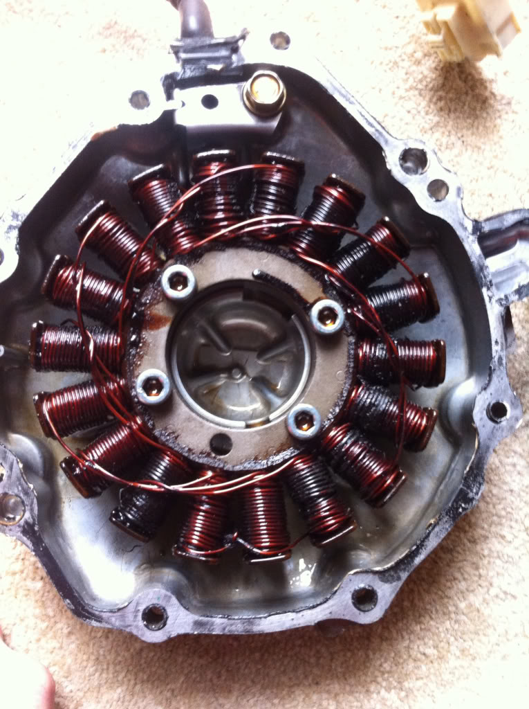

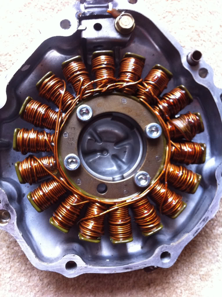

  17. SteveBuxx
    SteveBuxx Active Member
    Sep 14, 2012
    144
    25
    Old:
    New:

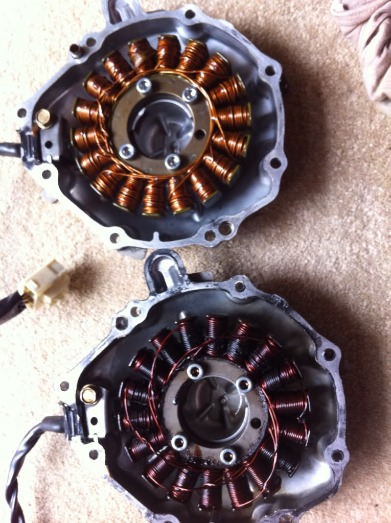

  18. SteveBuxx
    Sep 14, 2012
    144
    25
  19. SteveBuxx
    Sep 14, 2012
    144
    25
    Now just waiting for the threebond to cure..
  20. martinowen
    9,907
    Wow, bit different
