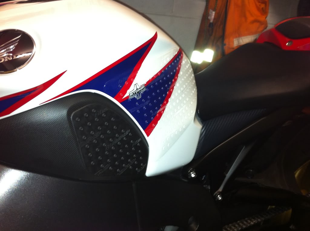

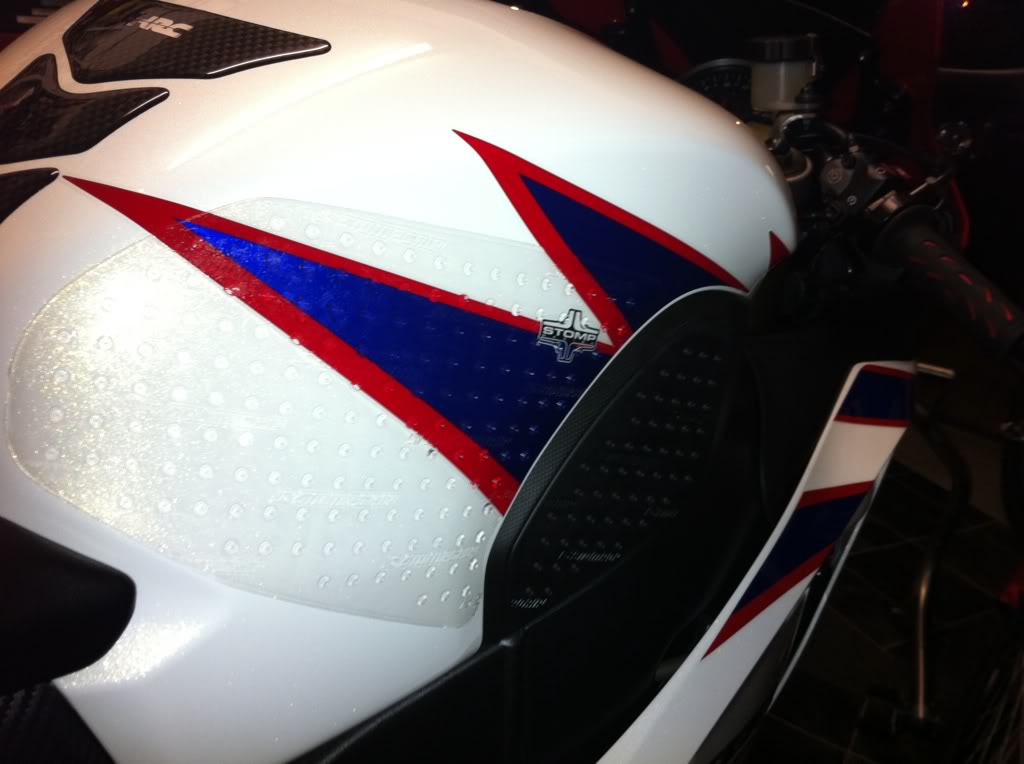

    Fitted mine tonight
    I took the tank off and did it in the house which is a bit easier.

  12. flatstickHRC
    flatstickHRC Active Member
    Apr 23, 2011
    1,037
    63
    no bubbles mate
    i clean the panel with window cleaner then i spray soapy water on the tank and fit the sticker. gives you a couple of chances if your not happy with the positioning. i heat the sticker with a hairdryer first too
    once on i spray the sticker outside to lube it up for a good rubbing! if its dry on the outside you can't rub the bubbles out as the rubber is very sticky.
    once all the air is out i blast it with a hair dryer and jobs a good en
    for the black bits i didnt use soapy water, just heated them up.
    both sides are about perfectly symmetrical!
