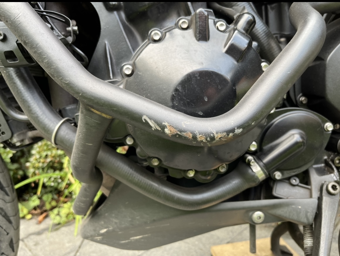

    I need to do a bit of rubbing down and painting on the engine bar where I forgot the side stand

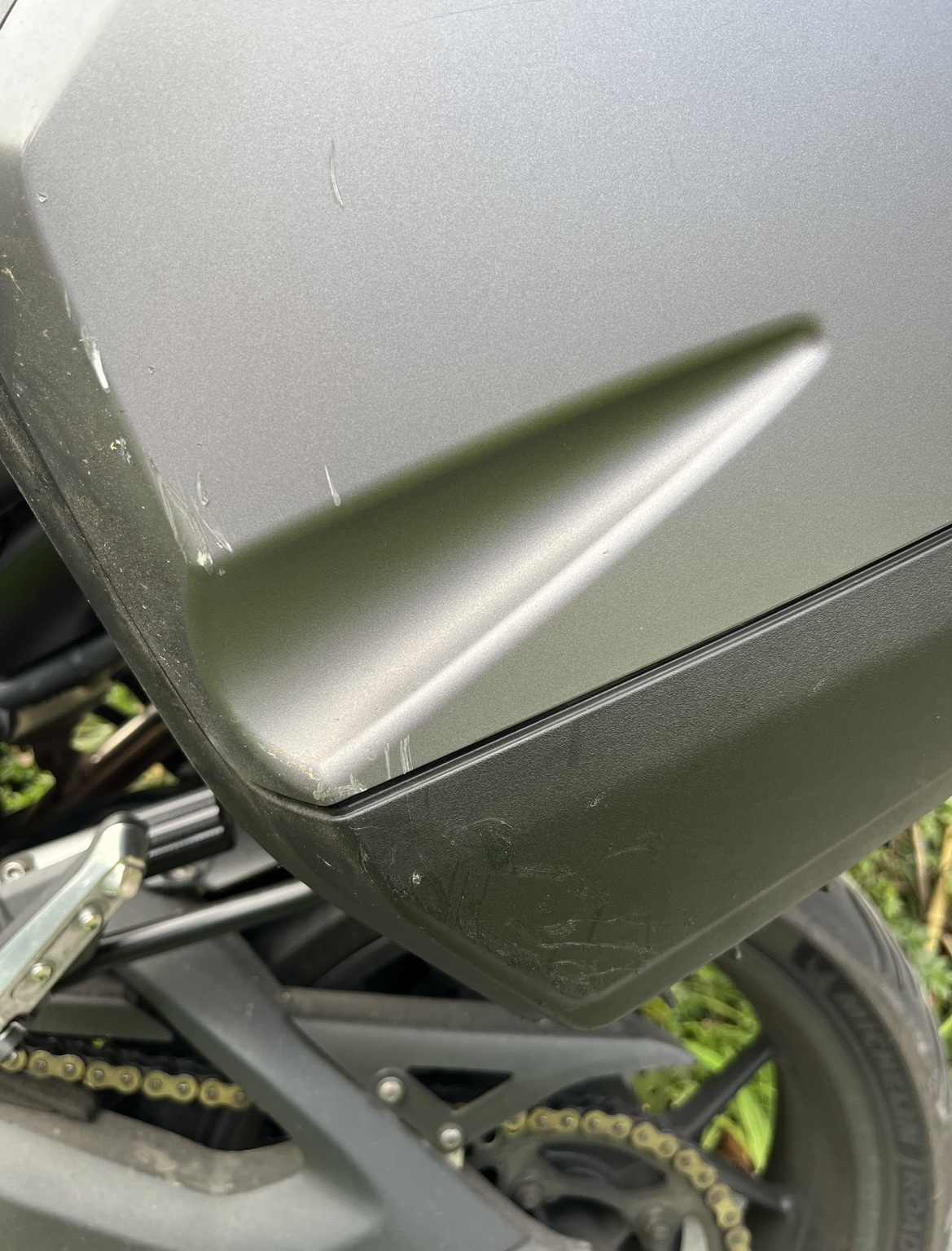

    And there are a few more marks on the left side pannier (but the luggage was far from perfect when I got the bike)

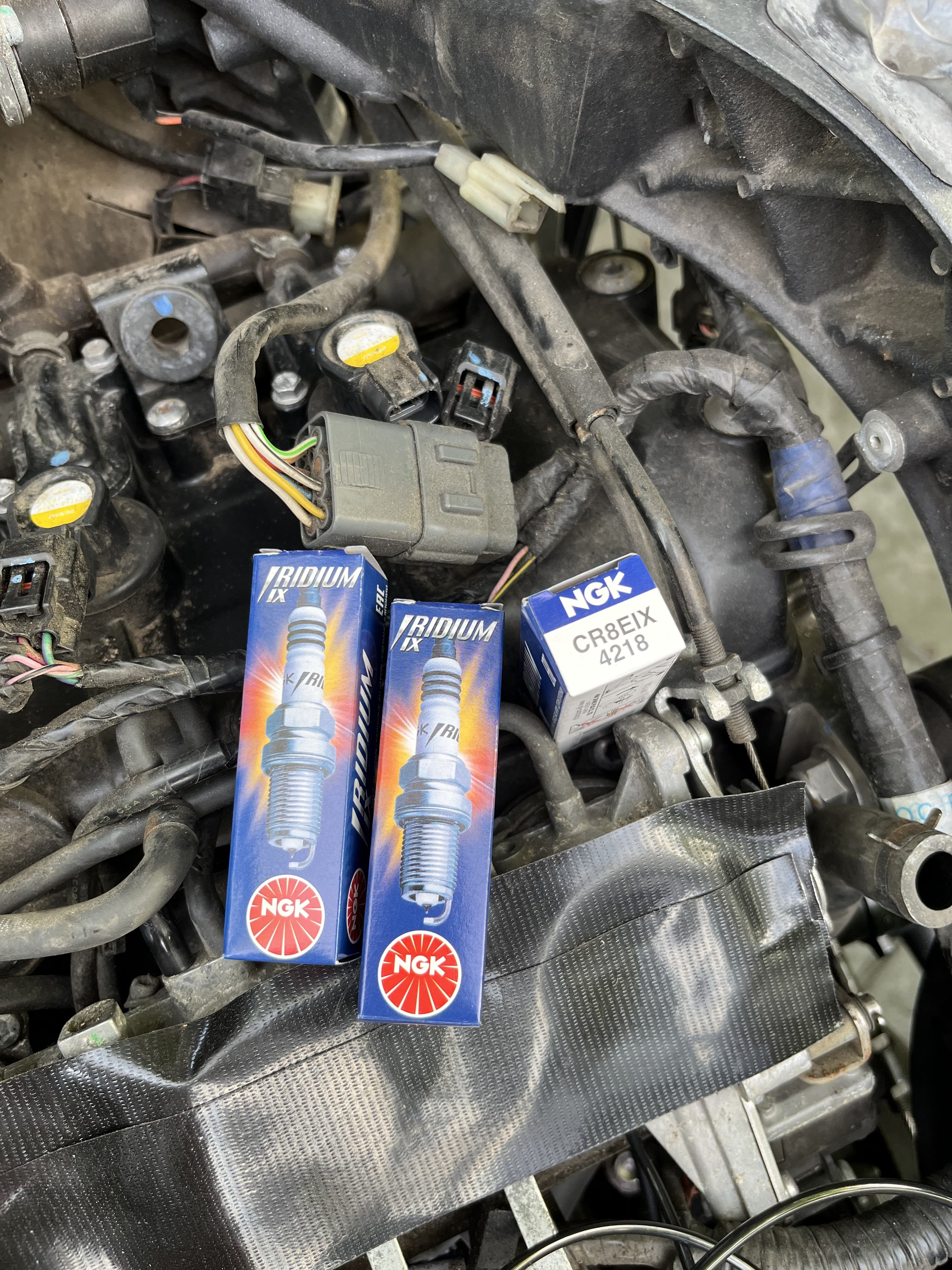

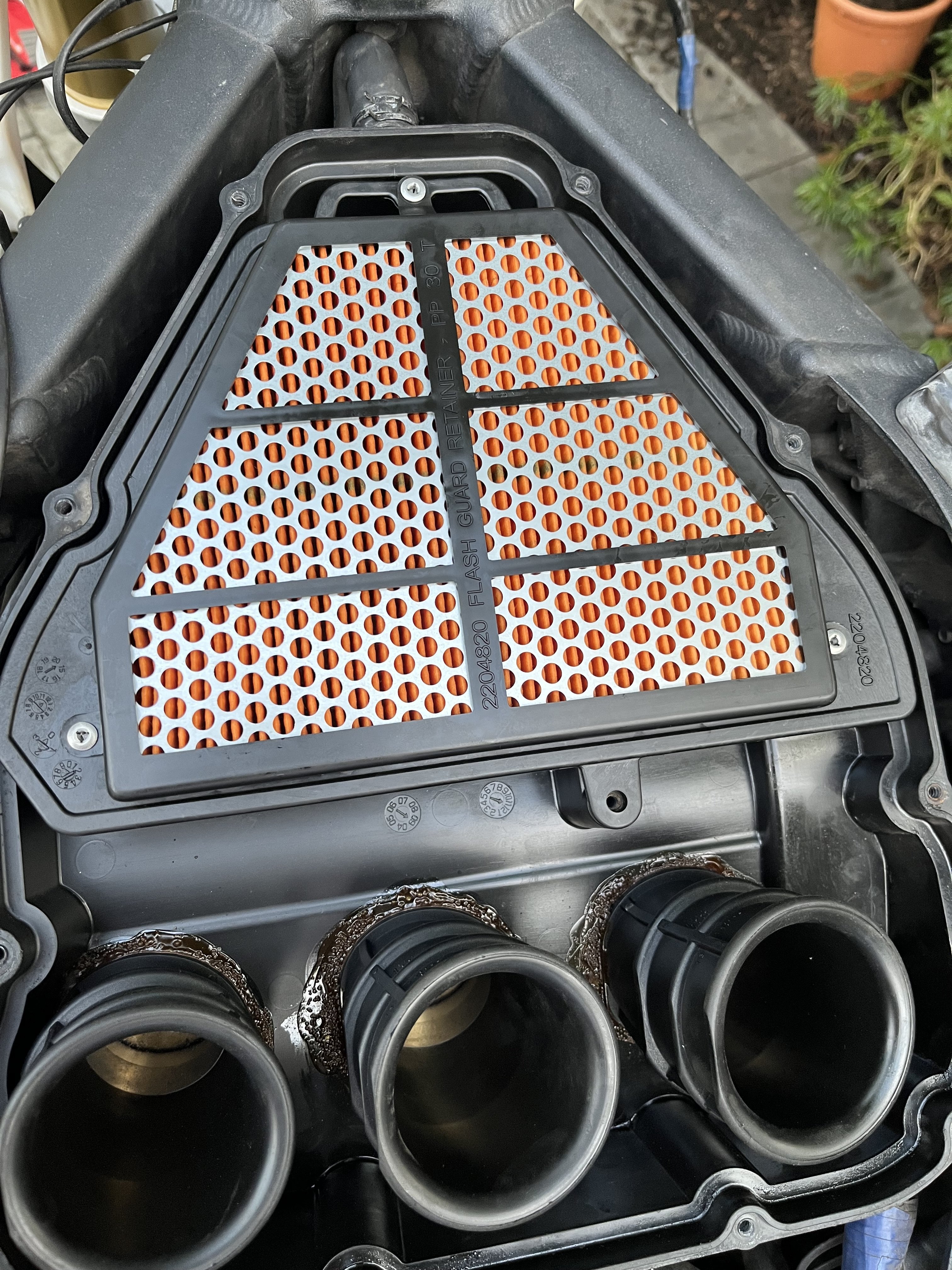

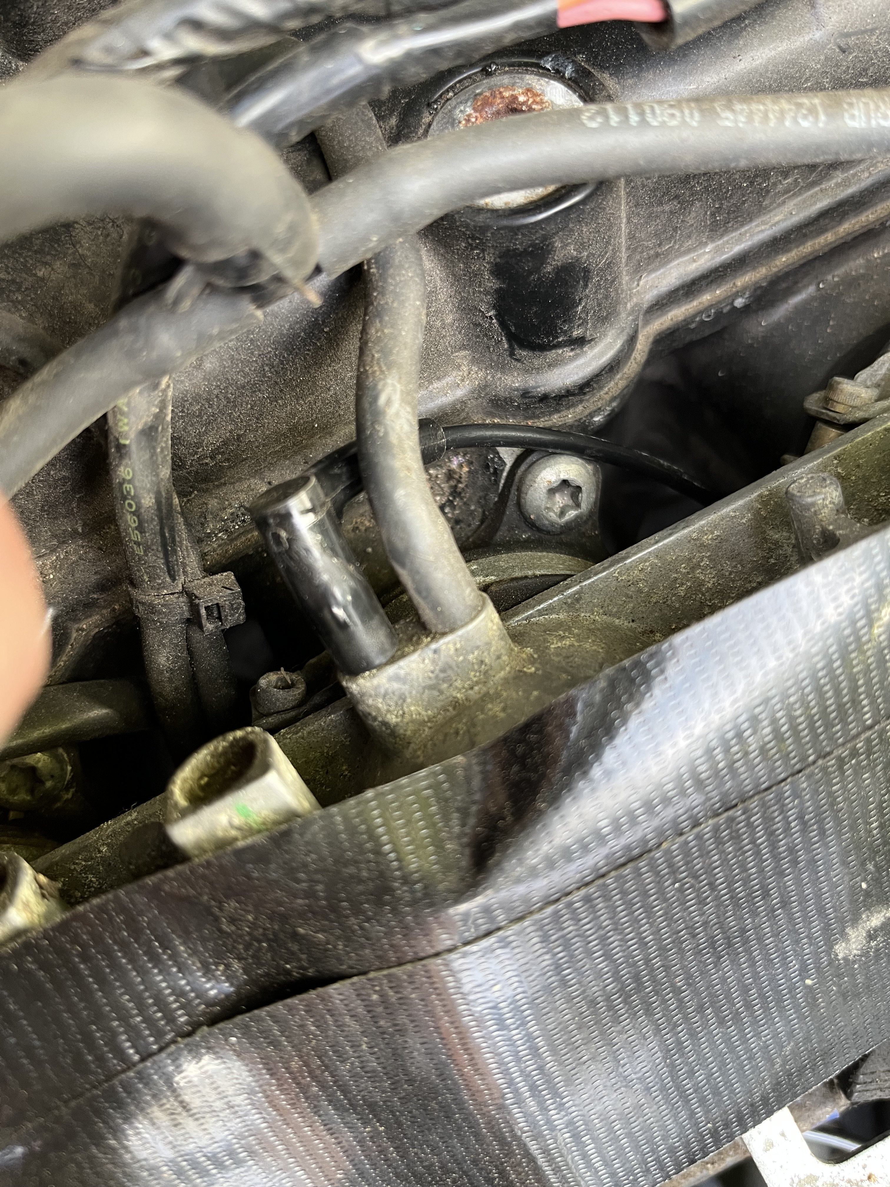

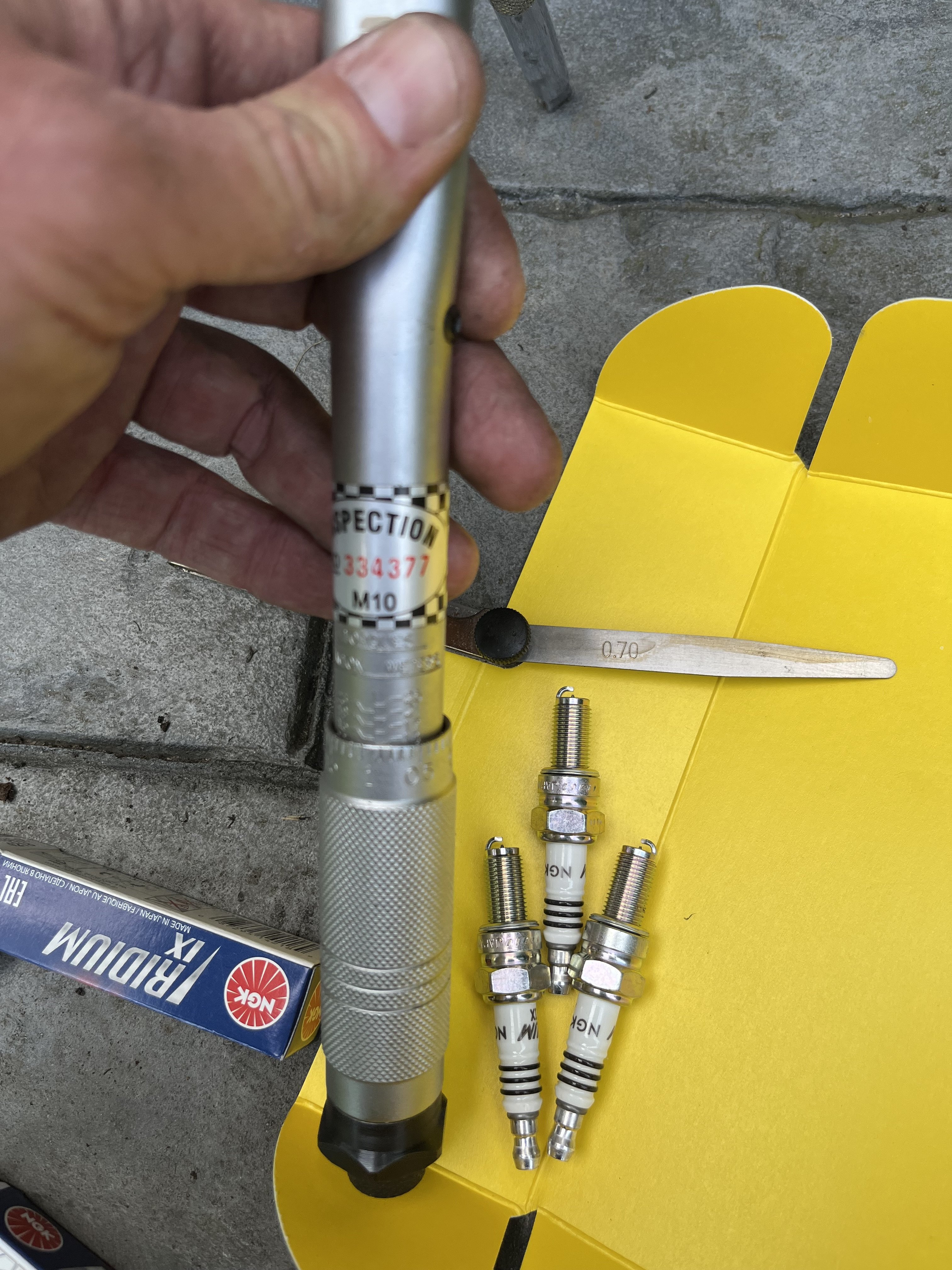

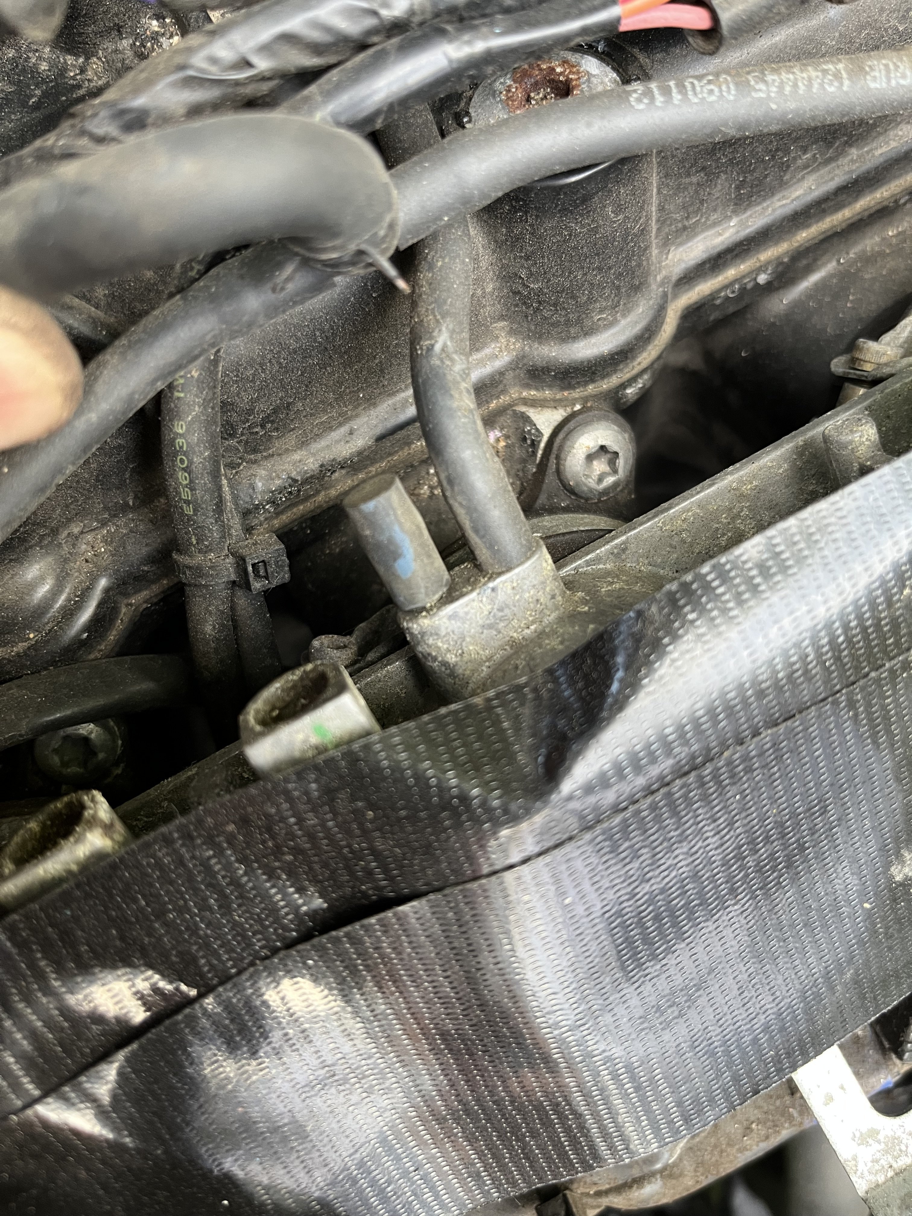

    Having decided I’ll be keeping the Tiger after our little NC500 adventure, I decided to sort a Scottoiler for it. Having to get a vac tapping meaning tank and airbox coming off, I also opted to fit new iridium plugs and replace the air filter.
    I know the bike was serviced before I collected it just over a month ago, but I’m sure that would just have been an oil/oil filter change and check on levels.
    So, that all happened, including fitting of the Scottoiler yesterday evening/this morning.
  10. Boothman
    Boothman Elite Member
    Aug 15, 2018
    2,928
    1,389
    There’s a conveniently capped vac connection on the throttle body assembly that I used for the push on elbow and threaded the small vacuum pipe towards the battery area.

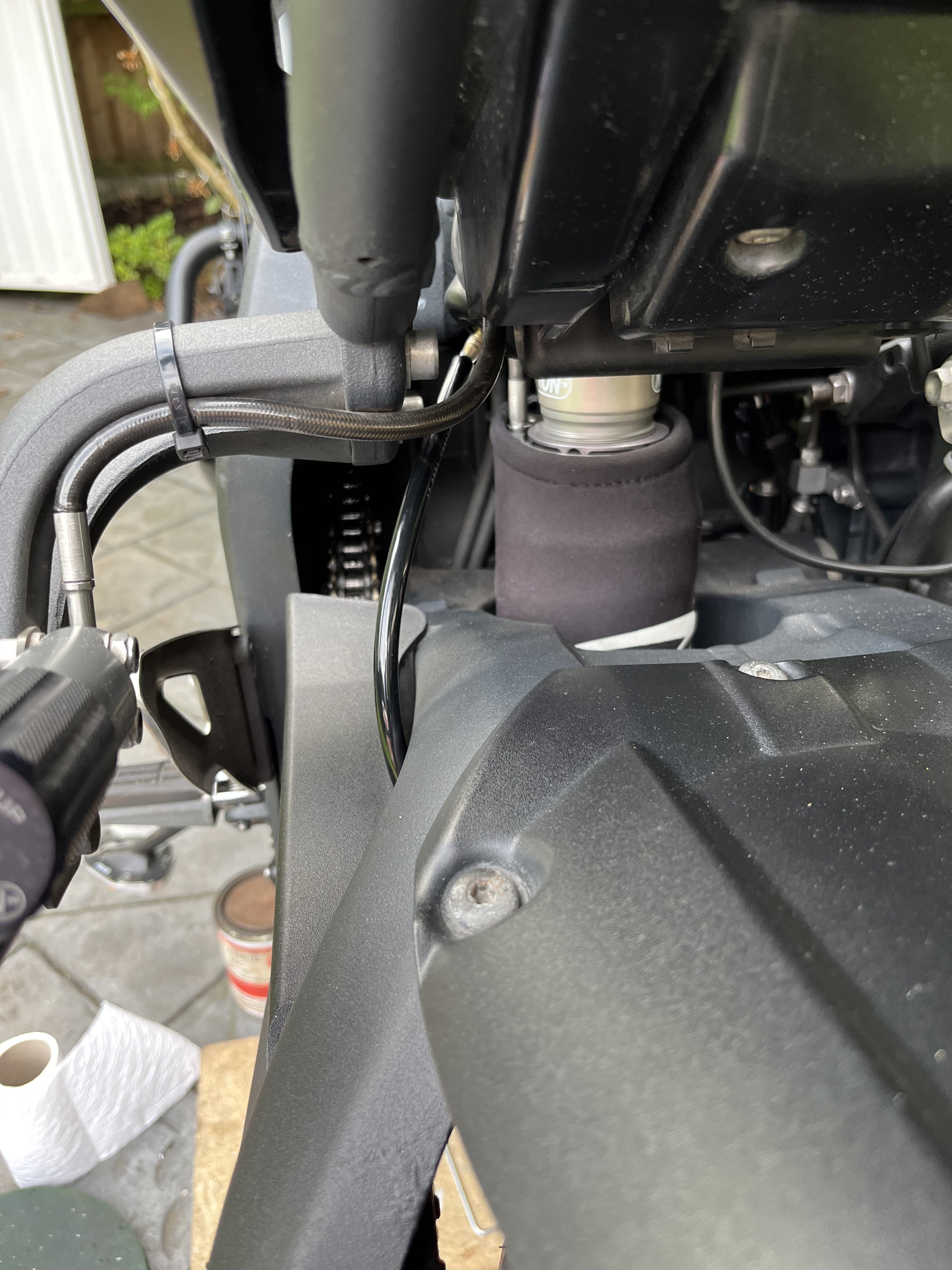

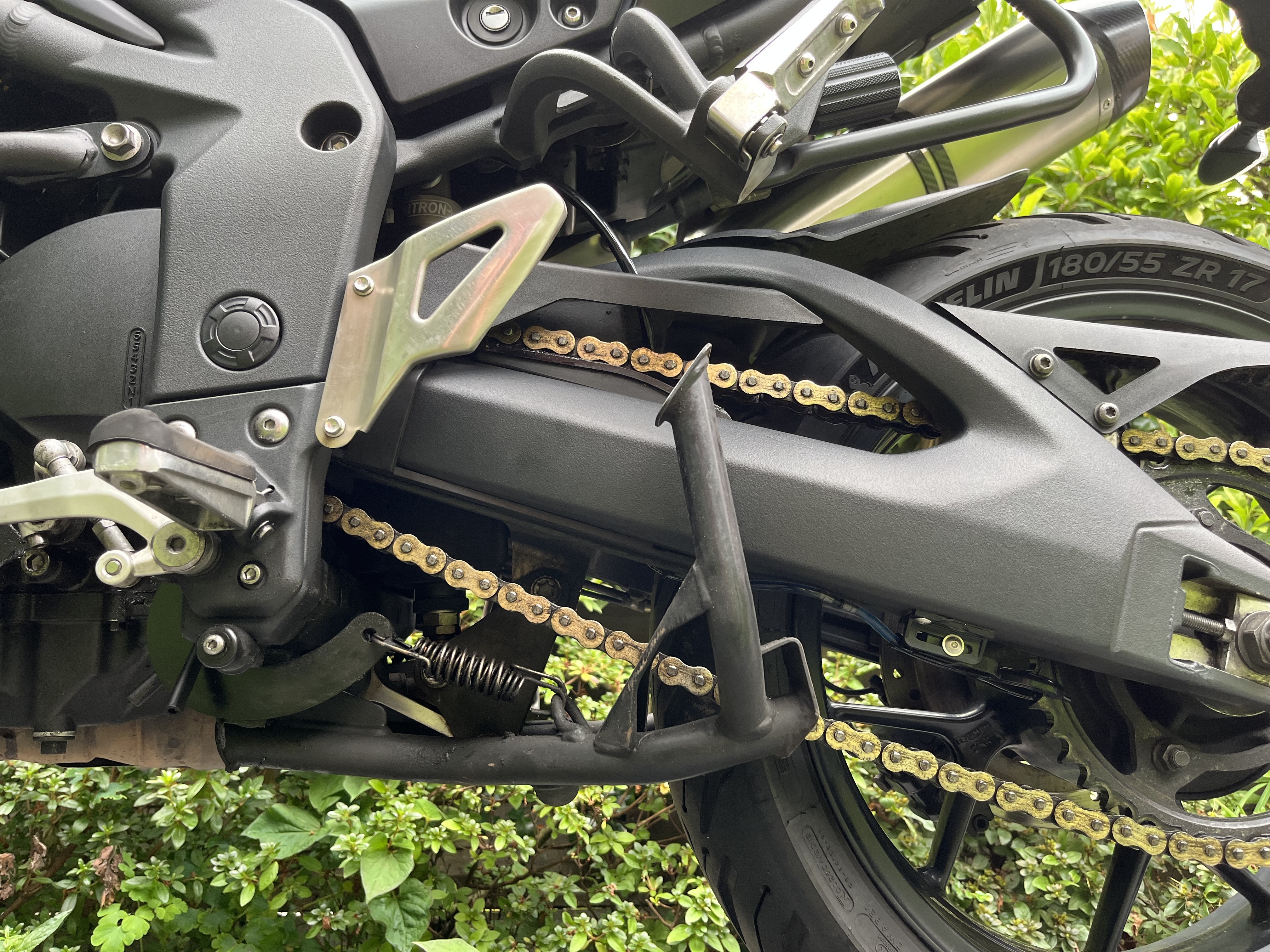

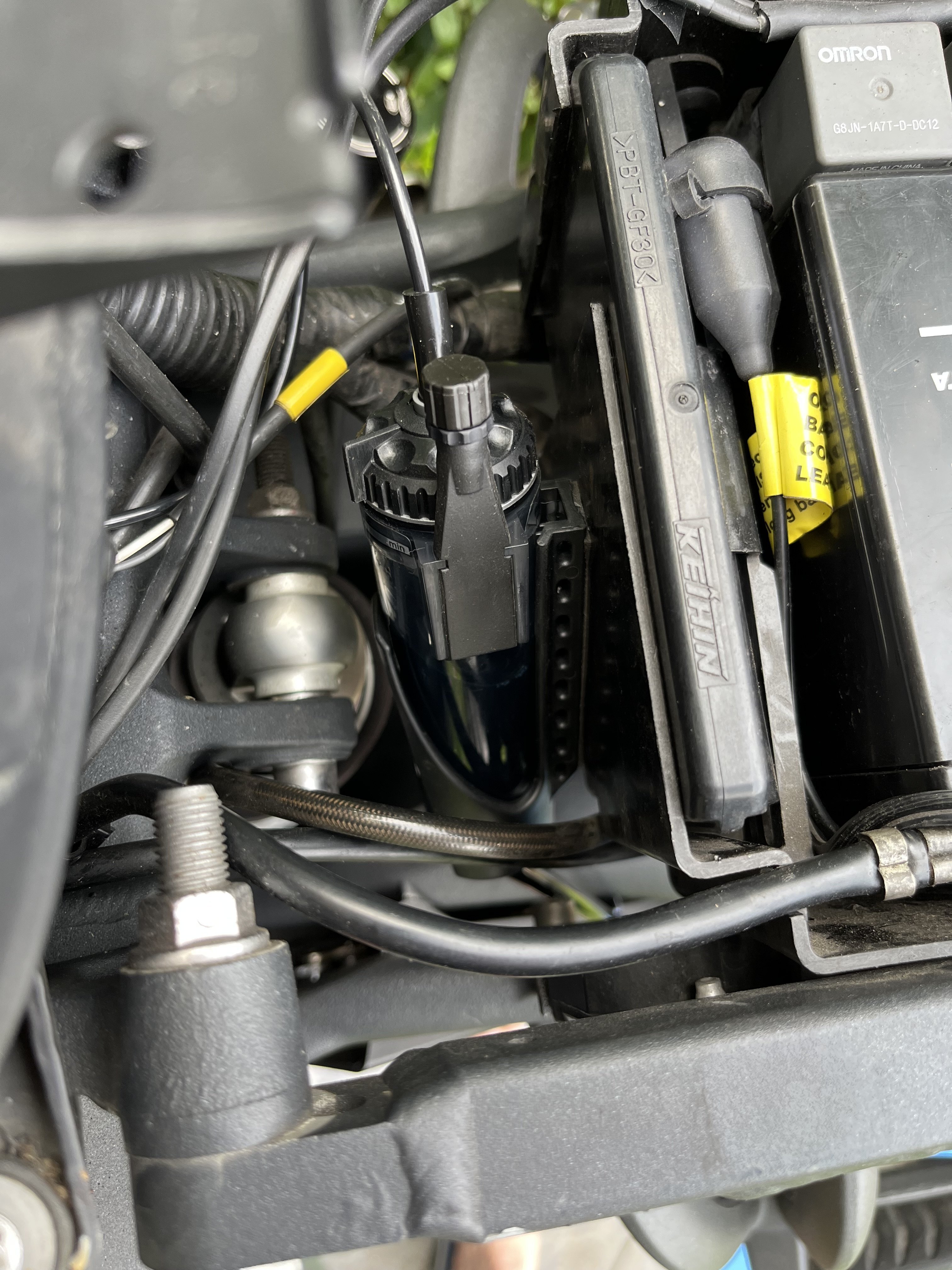

    Fitted the reservoir in the shock absorber well by screwing in to the ECU holder (removed the ECU first) cutting the tips of the screws off flush and then tapingover on the inside of the holder. To be double sure of no scratch risk to the ECU.

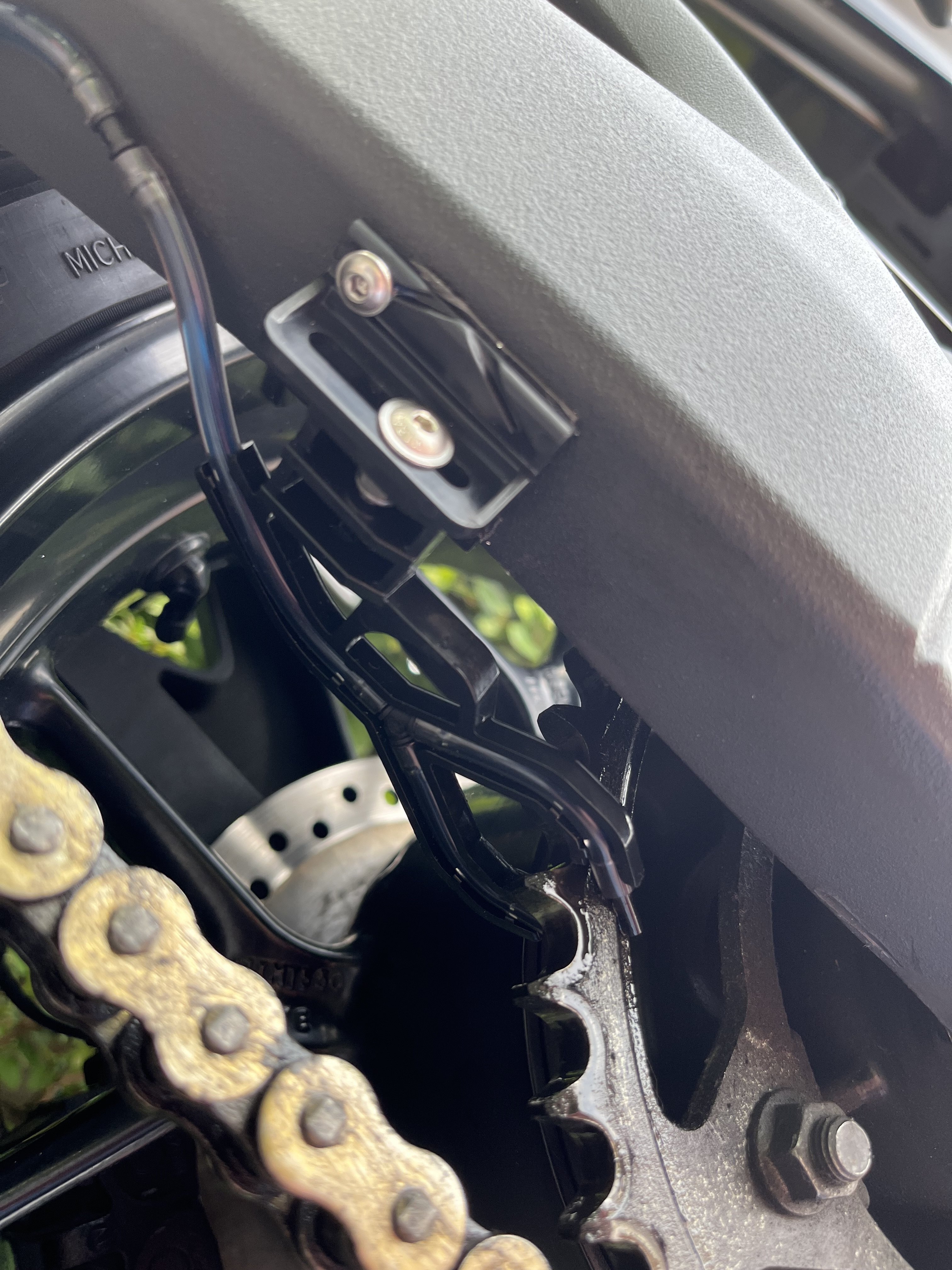

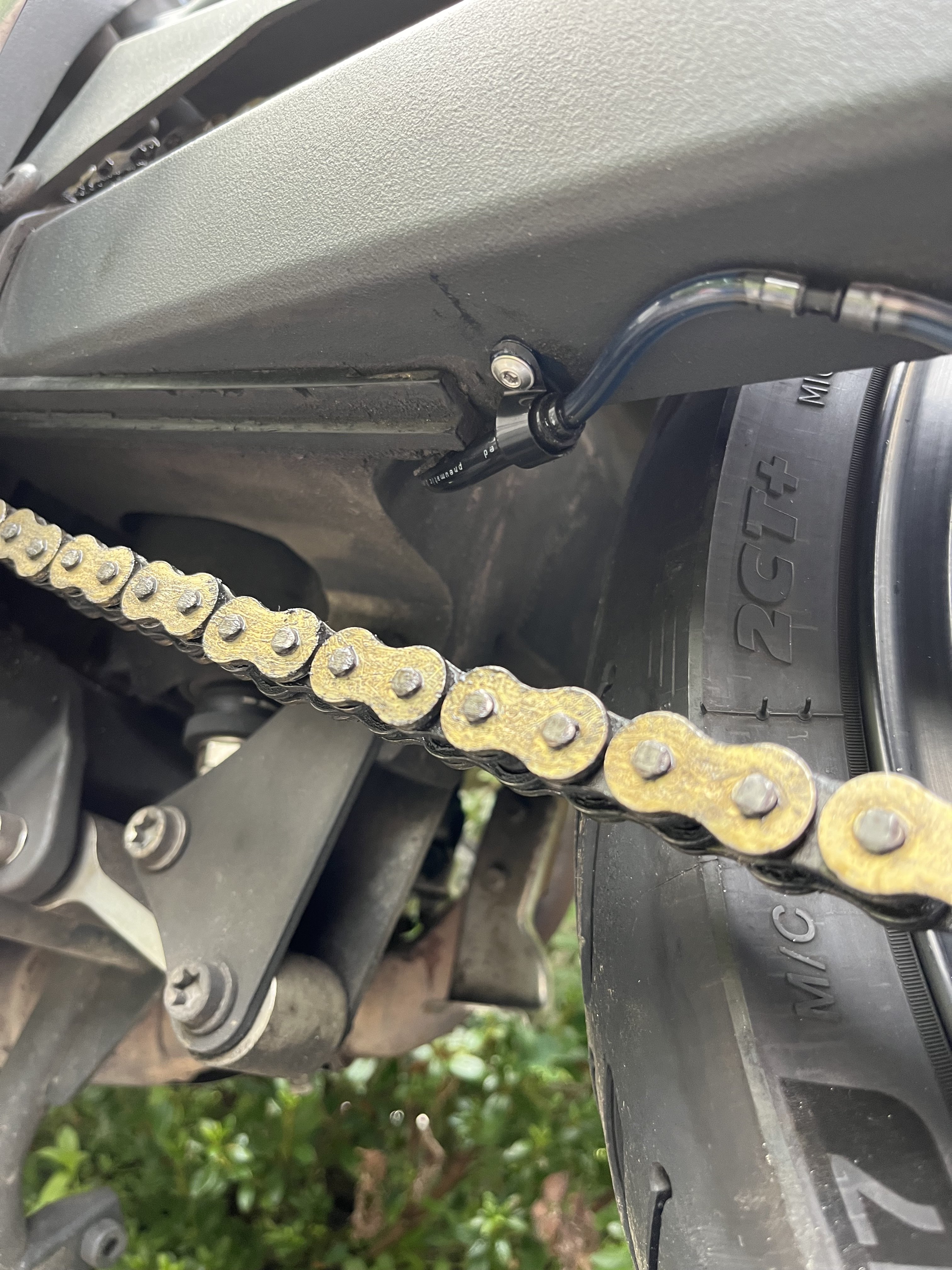

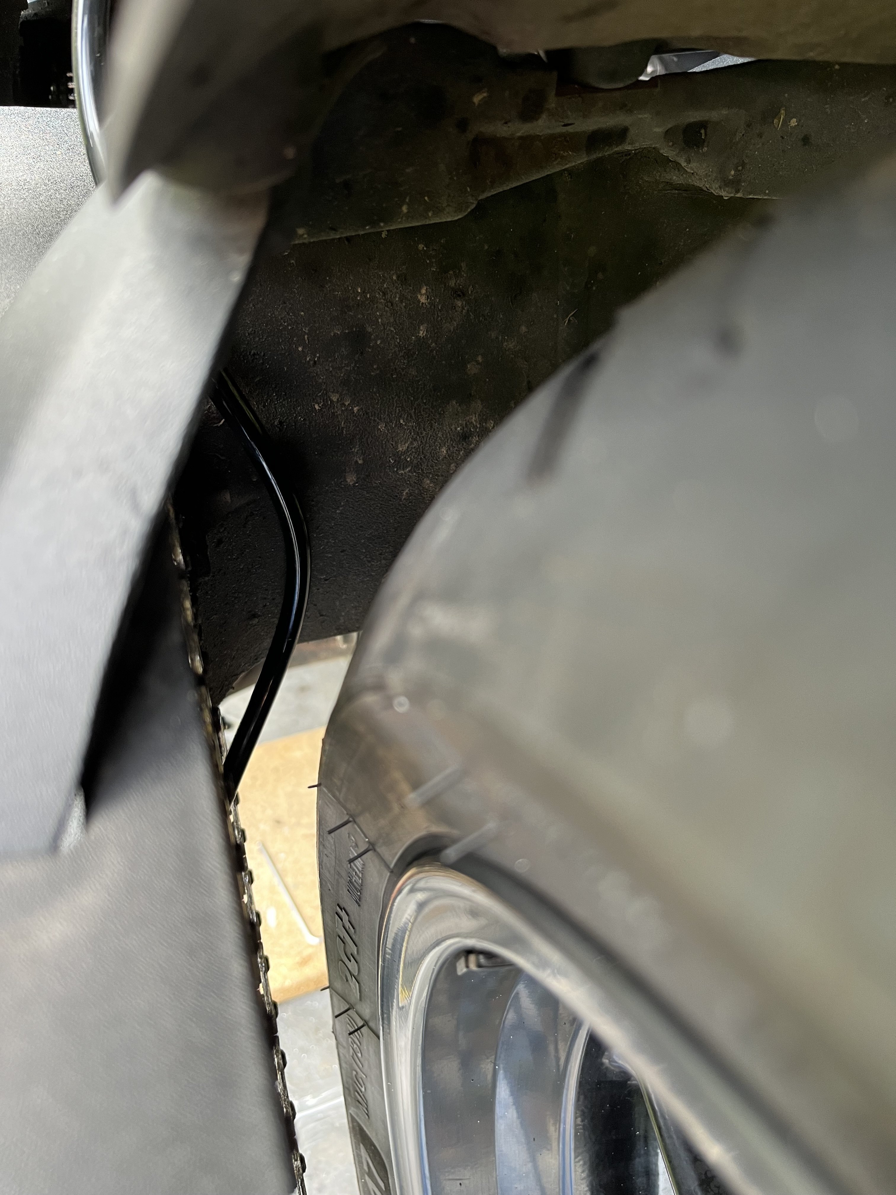

    and then because I’m a bit of an OCD freak. Sleeved the clear tube in blacknylon, routed it over the top of the chain guard
    and to the underside of the swing arm.
    That held in place by a P clip screwed in to the (drilled and tapped M4) underside of the swing arm
    and connected to a similar 2x D&T diagonally opposite fixing for the Scorpion Dual Feeder to drop the oil on to the rear sprocket (not as good IMHO as the Dual Injector type they used to do and I have on my Fireblade).
    All looks rather neat, if I say so myself :)

    Know what you mean about the clear tubing but personally I wouldn't sleeve it as I use it to keep an eye out for airlocks etc.

    Yes, I deliberately stopped short of the scorpion connection to have visibility, and of course the scorpion tube is all the clear stuff so there’s a few inches you can see :)

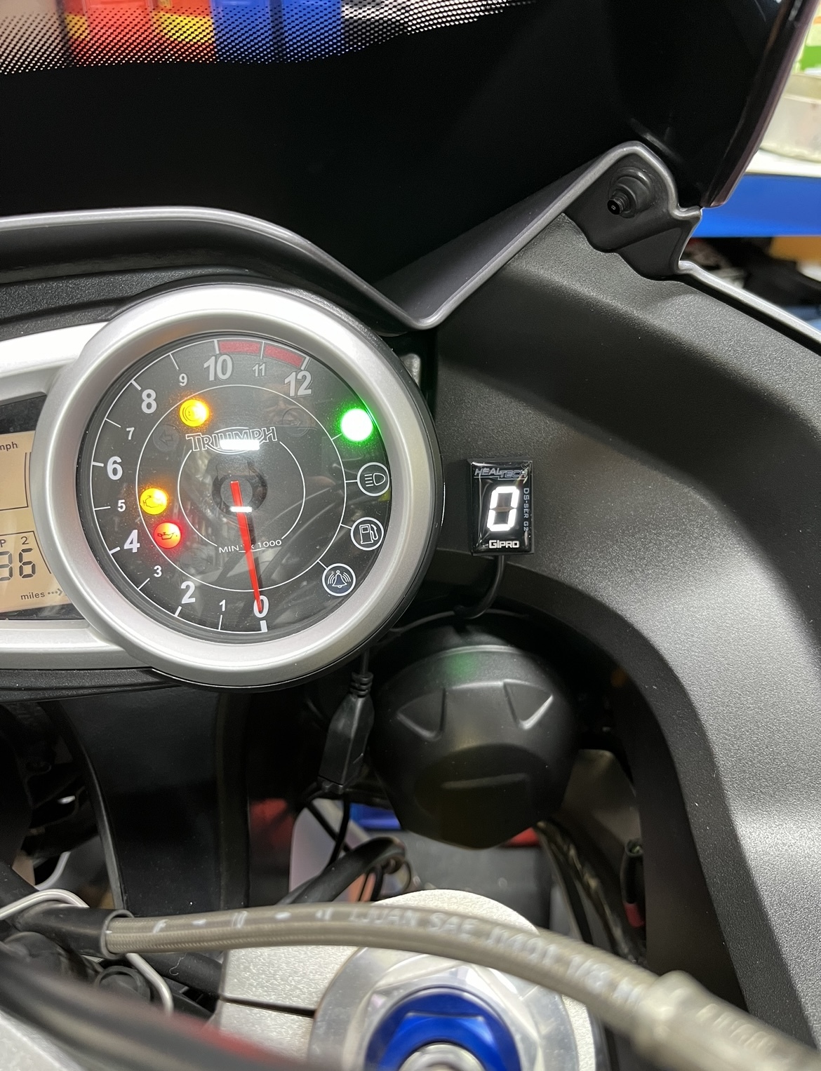

    No gear indicator on the Tiger has niggled me so I bought and fitted a Heatech at the weekend, but the weather was too rough to do the setup.
    I’m happy to report that the ‘Learning’ of the gears by the indicator went without issue and all appears to be working correctly.
    It stopped raining briefly enough this afternoon which gave opportunity to pull the bike out and do the set up. With the bike running up on the centre stand it was all very straight forward.
    Wasn't fit to go out for a run, but went up and down the gears a good few times and response is within a second I’d say of releasing the clutch for the display to change to the gear you are then in. I’ll give an update for how it performs on the move after the weather offers a chance for that to happen, but so far I’m very happy.
    When I spoke to Healtech before the purchase they did say the Series 2 units are a lot better than the first generation. Mind you, he was selling them so who knows - I’ve no previous experience to go off.
    With the Series 2 you do get options the previous model didn’t have - you can fine tune the response, increase/decrease the display brightness and even invert the display if it works out better routing wires to come from above rather than below.
    As you can see I opted for the white display and I’d say that’s in keeping with the bike - had briefly considered red, but that was the fireblade side of me coming to the surface I think :D
