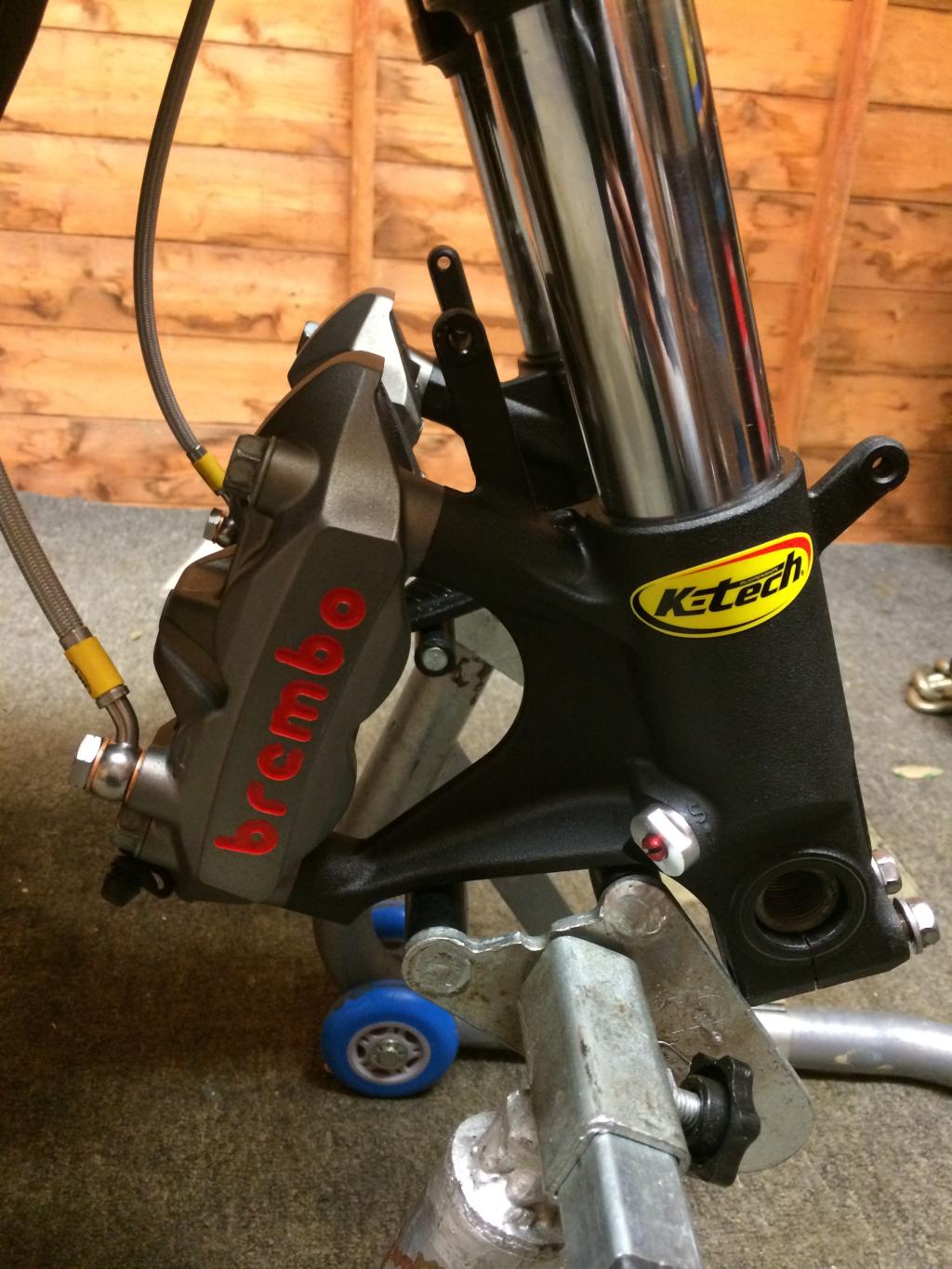

    Russ I hope you refitted the calipers the right way round for final fit??? :D

    Ha ha yes I did. Wasn't till I stood back and looked that I realised they were upside down lol

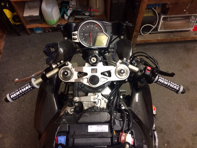

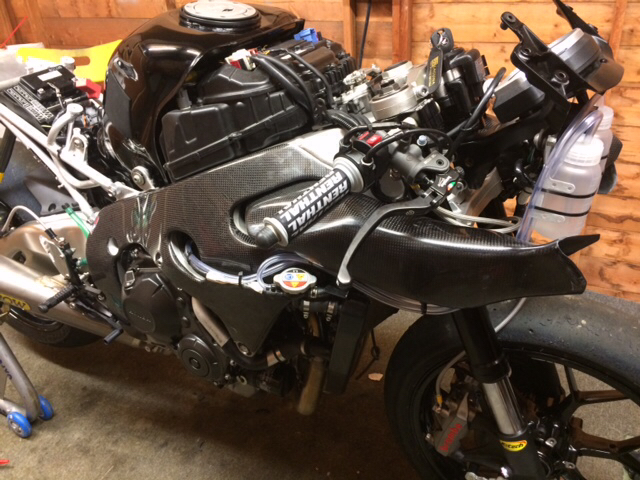

    Russ, couple of questions if I may!
    Where did you get the catch bottles and tubes from? Where they sold as a kit?
    Also have you used the standard wiring loom for the dash and just tied up all the unused connectors, (lights etc)? When I removed the nose cone and lights the wiring loom is all fixed within the nose!
    Cheers

    I have some bottles I can sell. Very close to hrc ones. The pipes look like from a fish shop ;) I like em tho
  6. RepsolRuss
    RepsolRuss Active Member
    Feb 24, 2012
    487
    209
    Got the catch bottles from Dobles Honda . They were £9 each I think. I (stupidly) bought the HRC tubes from them too but they weret long enough, so I bought new lengthens from my local DIY store.
    The loom has just been tidied up with various cable ties just under clocks. Quite easy to do. Looks neat :)

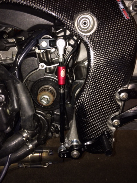

    Popped along to HM Racing this afternoon for a new shift rod (only 20mins away) as the rod that came with the shifter was the wrong size. The shifter was previously fitted to a K8 GSXR 1000 with a Suzuki/Honda sub loom, so fitted straight on.
    Shifter was already set at 70ms cut time and 75% sensitivity and with compression already selected, so perfect for race shift.

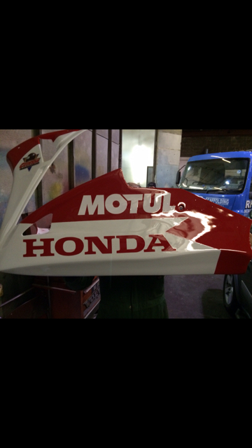

  12. RepsolRuss
    Feb 24, 2012
    487
    209
    Got some pics today of me repaird belly pan. The repair took longer to get done due to work load at the paint shop.
    Belly pan has gone from this
    To this
    Really chuffed with how it's come out. I know some people would of kept the damage as its from the TT but I couldn't live with it lol.
    Fingers crossed I'll have the fairings soon :)

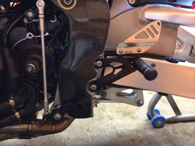

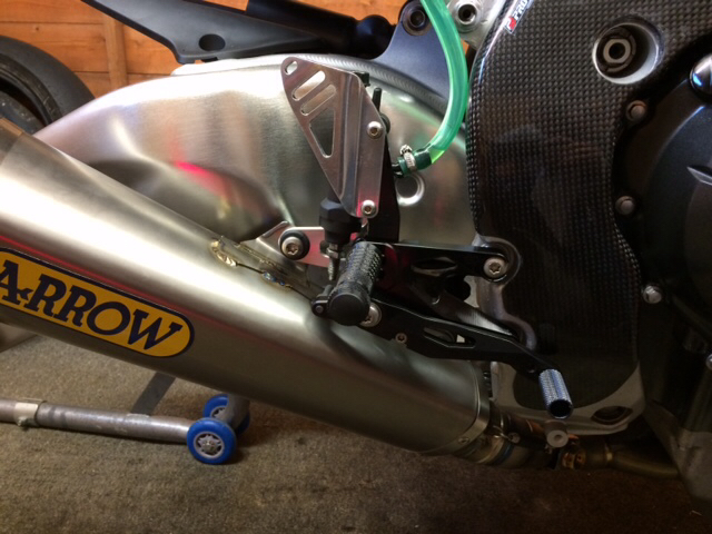

  16. wedgiewolves#223
    wedgiewolves#223 God Like
    Apr 7, 2011
    3,955
    2,314
    Hi buddy i havbe the same rearsets i dont know whether it makes a difference but on destructions it says bolt the shift rod on gear lever outside in yours looks the other way hard to explain and probs wont make a difference ?
  17. wedgiewolves#223
    Apr 7, 2011
    3,955
    2,314
  18. wedgiewolves#223
    Apr 7, 2011
    3,955
    2,314
    Or i have it the wrong way around hmmmmmmmmm off to investigate ha ha

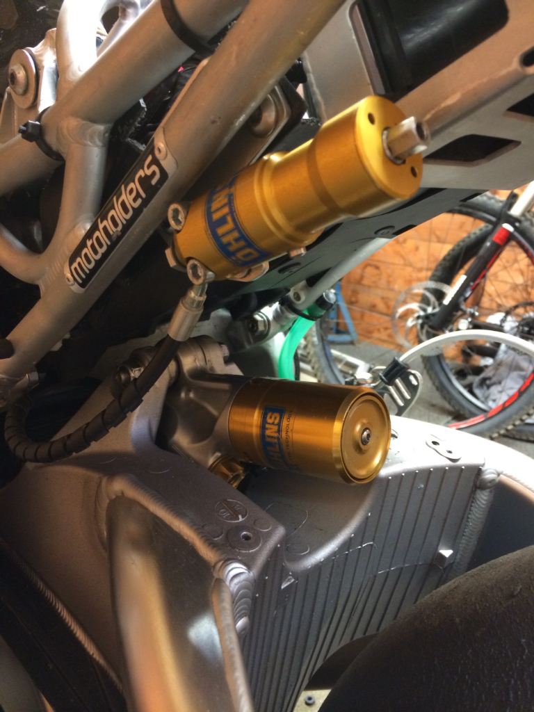

    It's been a while.... Been mad busy with work and various other projects at the moment.
    Managed to pick up a newly serviced secondhand Ohlins shock from Steve Mercer for the blade today. It's in great condition and at £500, it's half the price of a new K-Tech or Ohlins GP. I had an Ohlins GP on order but canceled it as Ohlins couldn't give me a delivery date!! Was supposed to be Jan 25th..... Still haven't turned up by the end of Feb.....

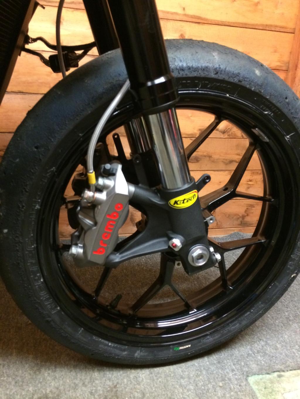

    I also had to compromise on the front brake discs. I tried to order a set of Brembo HPK discs from both Italy & the UK. Again, I watied for over a month for a set but none were available. Didn't want to spend the extra on T-Drive discs so eventually went for Serie Oro discs. These hold a good improvement over the stock discs & I'm sure they are more than up to the job..

    I have however picked up a set of Ohlins forks for the old girl. I'll be putting them on over the next couple of weeks or so. image.jpg
