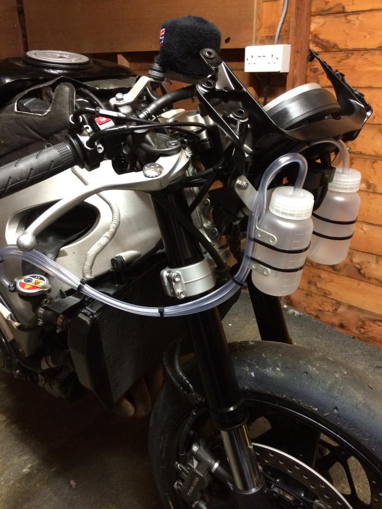

    Could I ask how did you plumb both bottles in. Obviously one is from the top of the radiator filler cap but where is from. Is it from ?

    Hello, I'm currently converting a 2009 blade to a track bike and have a couple of questions i have seen you have answered, But me being a bit of a plank want to confirm a couple of things and also ask another question!
    I have the SES Front sub-frame with bottle bracket and bottle catcher am i right in assuming i can remove the Stock expansion tank (Near the rear swing arm) and plumb one bottle straight into one of the bottles and the other bottle gets plumped into the fuel tank overflow? What size silicone tubing did you use?

    The clear pipe I used is 6mm Internal and 9mm external diameter 3m in length will be more than enough you need. Try eBay.
