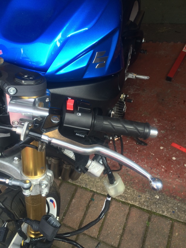

    First up we had to replace the steering damper (the electronic connector had been snapped in the accident). Luckily we found 1 cheap on the evil bay for all of £22. That and it was a case of 2 bolts to undo the old unit and replace with the new
    Next up we had to replace the clipons, as 1 had snapped. Well that and you would replace these anyway for ease of replacement if a spill on track had to happen (best buy a few then)
    These 1's are from Diamond racing and are on special at the mo at £75 for the set

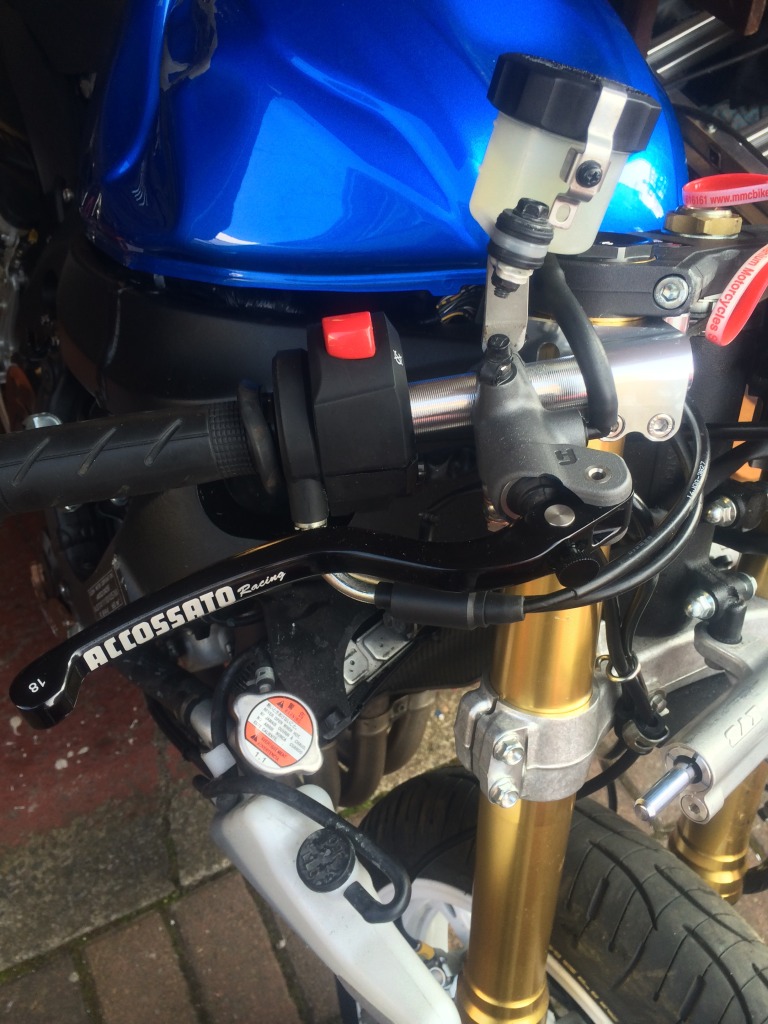

    When the clipons got damaged it also wiped out the brake master cylinder on 1 side along with the clutch cable along the same side. Both of which were replaced. Found an OEM clutch cable on ebay for £25.

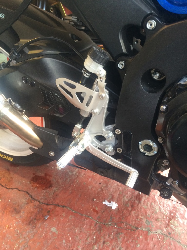

    It also wiped out the Giles VCR rear sets that were fitted to the bike, but luckily the originals came along with the bike, which we also fitted. (these will be replaced in due coarse with SES rear sets over the winter months)

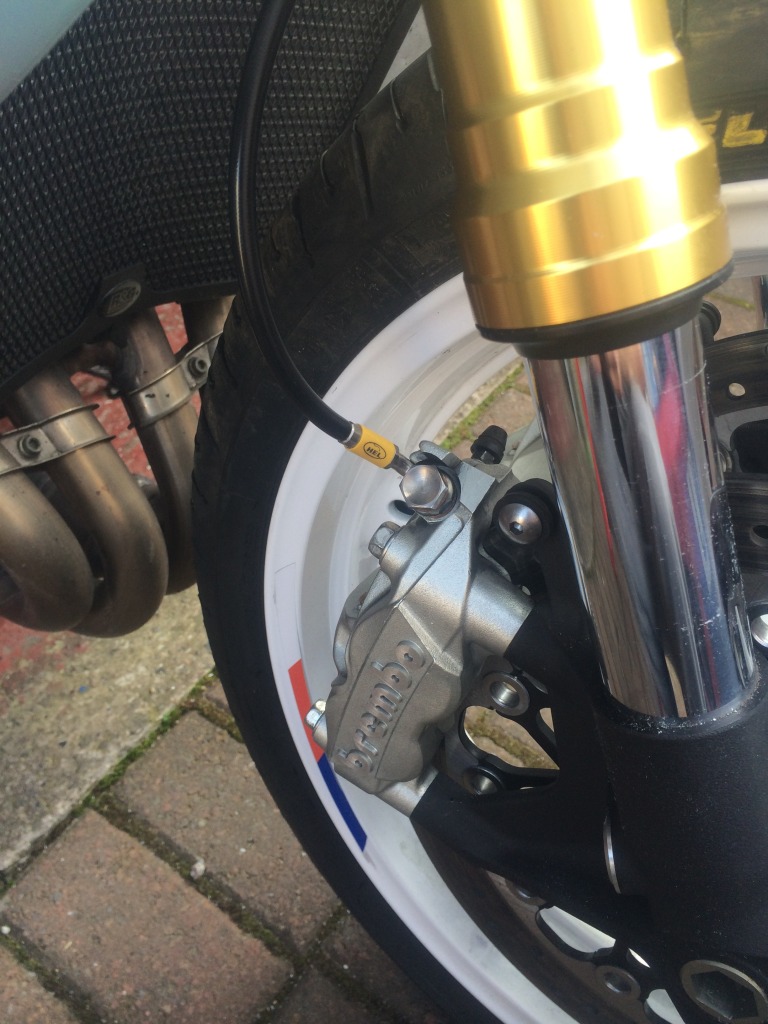

    This is where upgrades were made in the braking area. We decided to upgrade the MC with an Accossato fixed ratio MC with full braided line kit, as it wouldn't make any sense to replace with OEM in this area. We bought the MC and lines off of here via bikersdiscountstore with forum discount. (get in touch with them as the will do a cracking deal).
    1 good thing about this year of bike is that it already has Brembo's as standard, that along with the MC, braided lines, and SBS pads should make for some anchor out action.

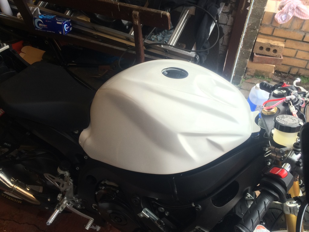

    Managed to source a tank cover that saved a bit of cash replacing the damaged unit. Also makes it easier for painting.

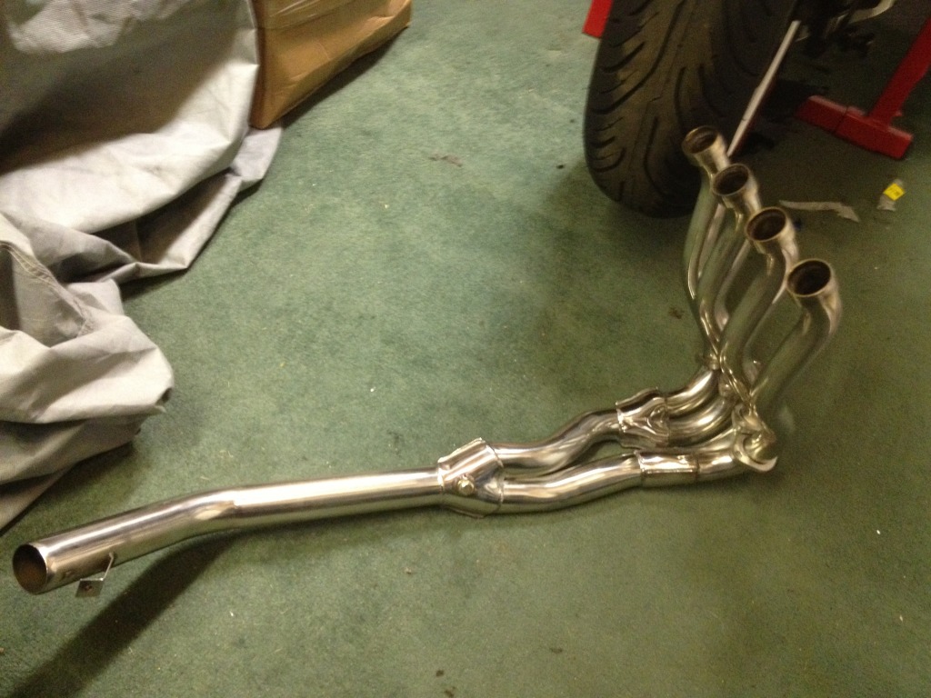

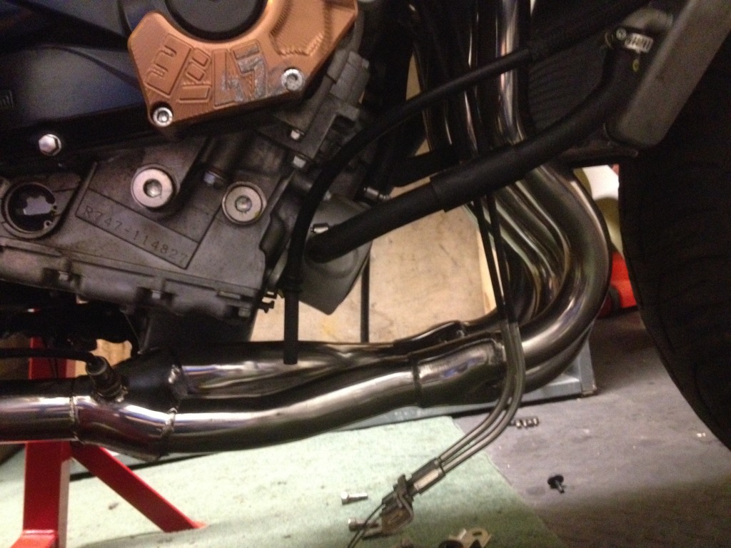

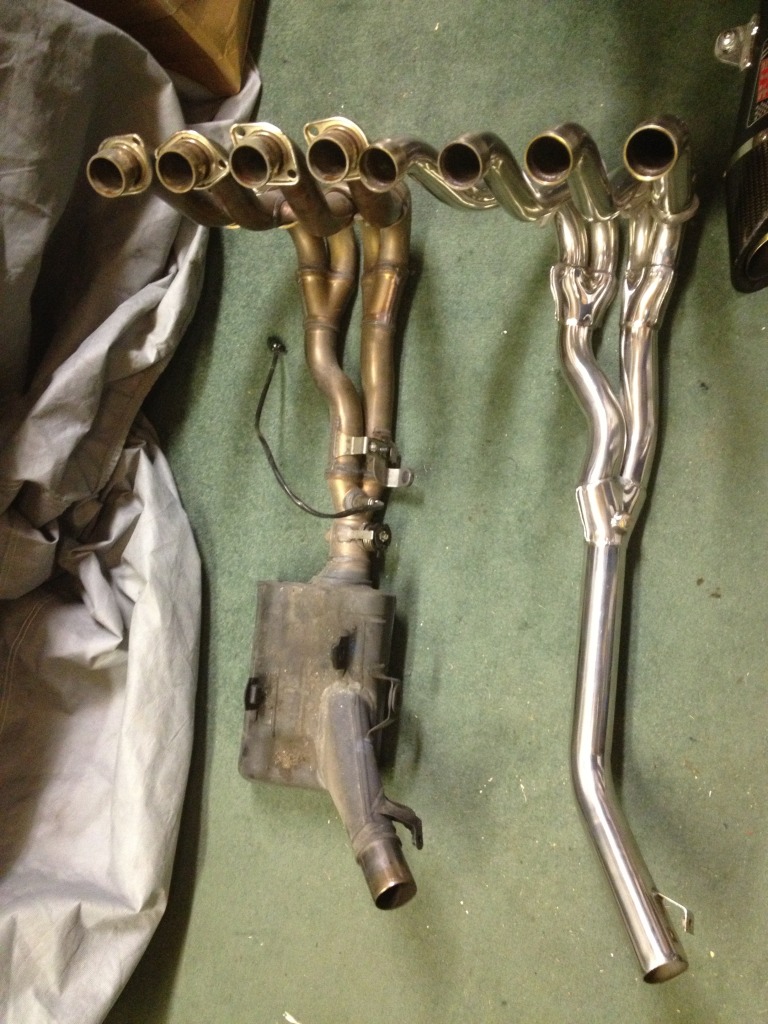

    Had to order up a new shiny bit as the track fairings didn't like the cat....who does rite enuff?
    Out with the old....
    And in with the new....just the exhaust valve cables to remove from the motor.

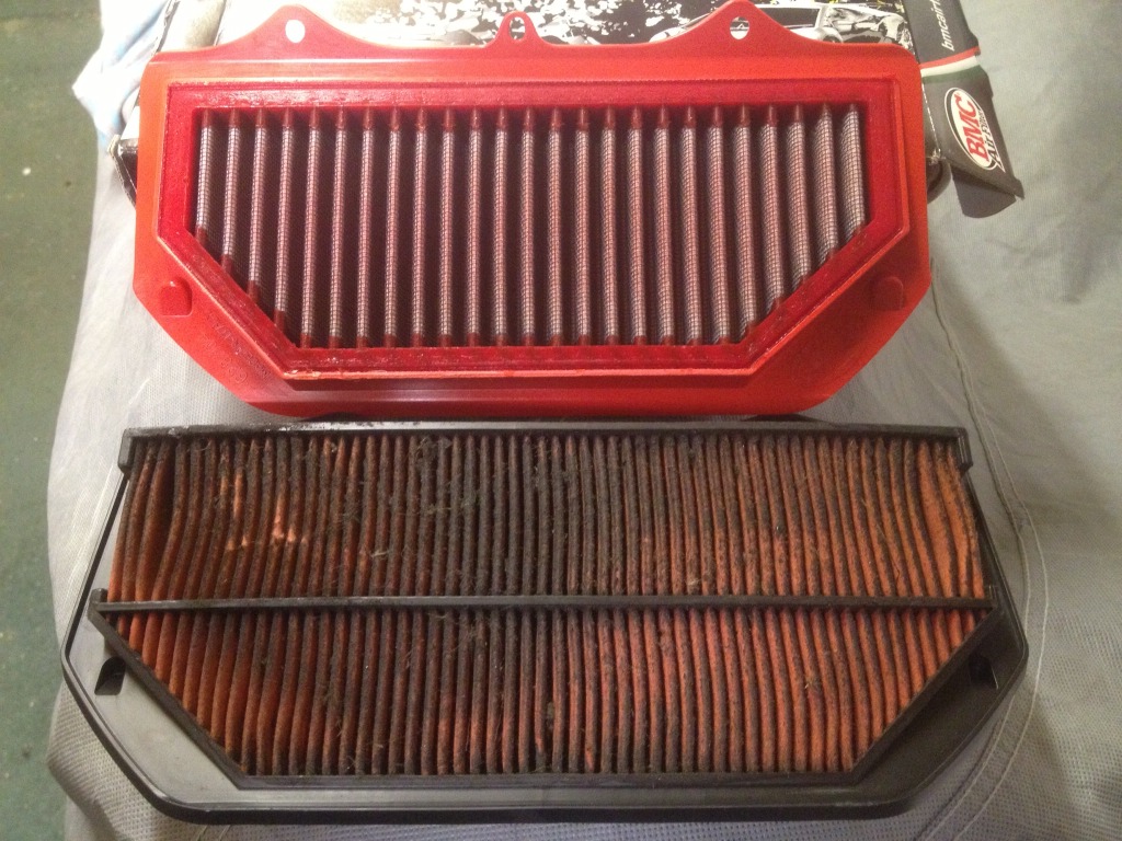

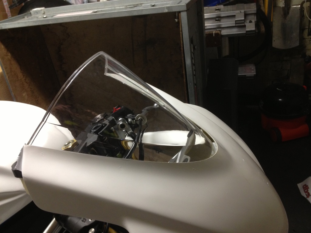

    A few other bits and pieces added to the bike
    BMC race air filter
    Double Bubble screen
