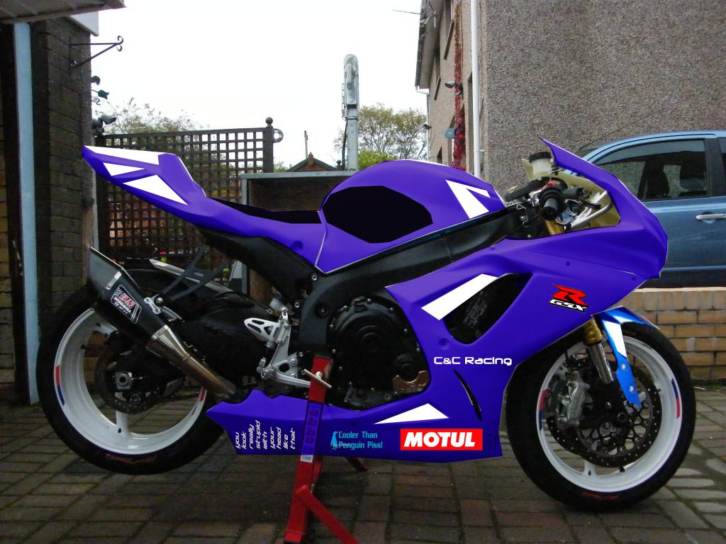

  7. ColinBR
    Well looks like we have now changed the design again, and have went with something a little easier to paint and maintain.
    It'll still look good though ;)
