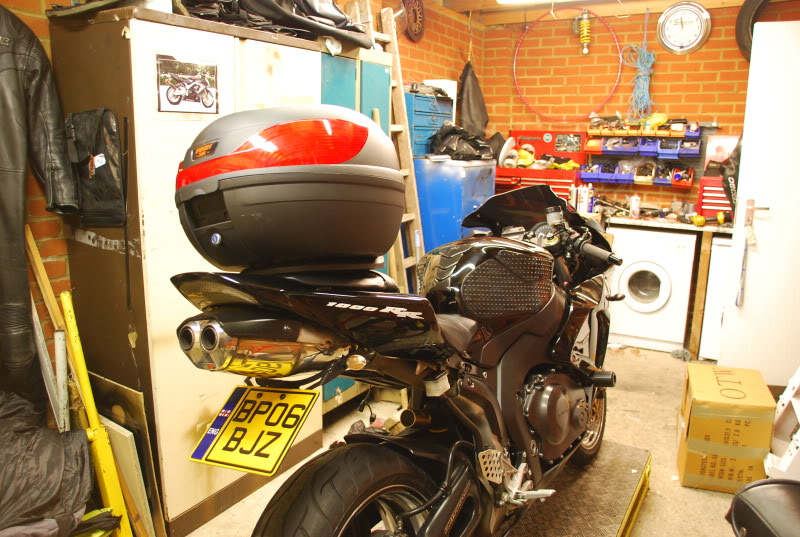

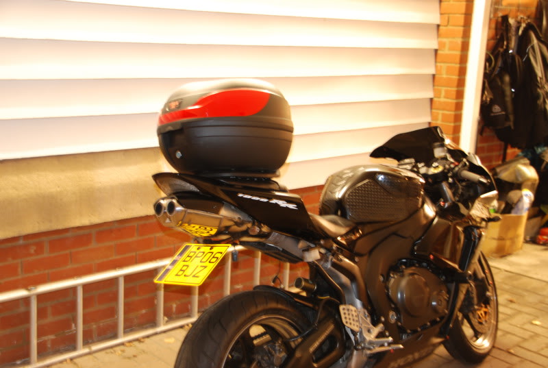

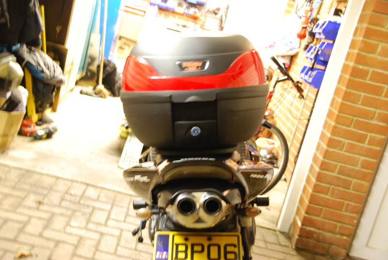

    my photos of my top box mod [​IMG]

    On the pics...................What do the spacers bolt to/through??Looks like you,ve drilled/secured through the tail section? or have you welded a few lugs to the rack?

    I welded 4 lugs to a Renntec sports rack so that with the use of the spacers my mounting plate can be be bolted to these lugs over the seat so no damage to bodywork or seat. Then fitted to my plate is a universal givi mounting plate. I used my 45 litre top case
    when i got to the isle of man all was removed, about 10 mins to do back to sports bike to play on the mountain course

    The Renntec sports rack fits on to fixing points under the seat and my mod fits to the rack and does not touch any other part of the bike ie paint work or the vinyl of the seat

    I thought about doing it like that too,I have the rack but changed my mind in the end.I had a spare pillion seat that I fitted some spacers under the cover and then just bolted the quick release plate to it.........job done.I carry the single seat in the top section of the box and takes 30 sec to convert back.
