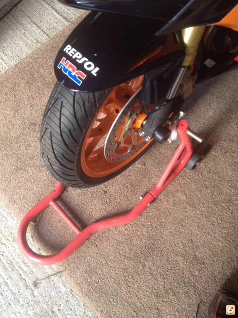

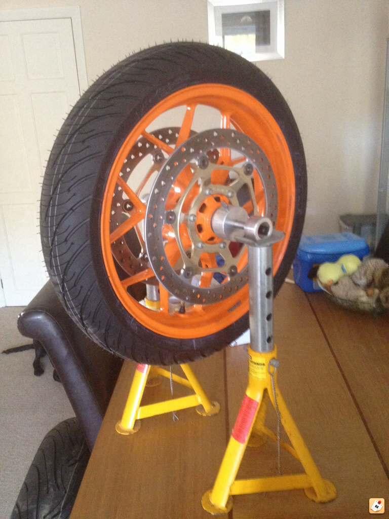

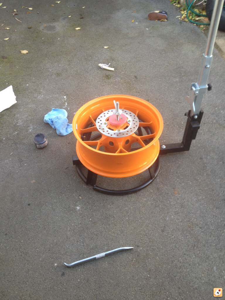

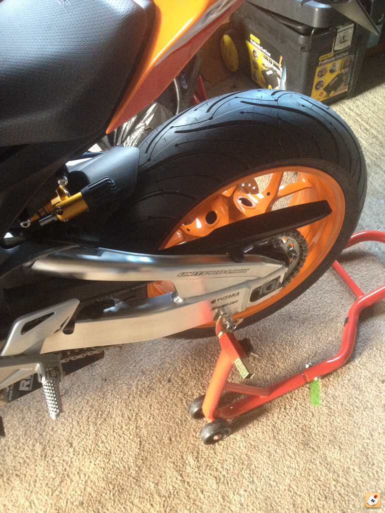

  5. Jamiestrada
    Changed the tyres over
    [​IMG][​IMG]
    Also insured bike with MCE for next year

    Can i just ask n im prob being a numpty here, but how do ya check the wheel balancing on them axle stands??
    And take it them are Pilot Road 3's ??

  9. Jamiestrada
    PR3s yes and its a static balance, the heaviest part of the wheel drops to to bottom you then add weight opposite to balance the wheel, once you can rotate the wheel through 90 degrees and it doesn't move or does very slightly its balanced :)
    It rotates on the spindle which rests on the two axel stands
