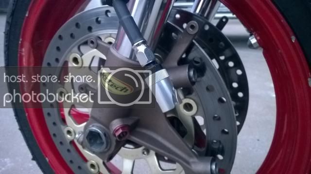

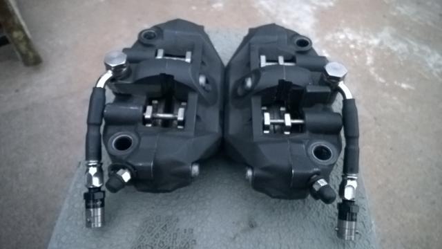

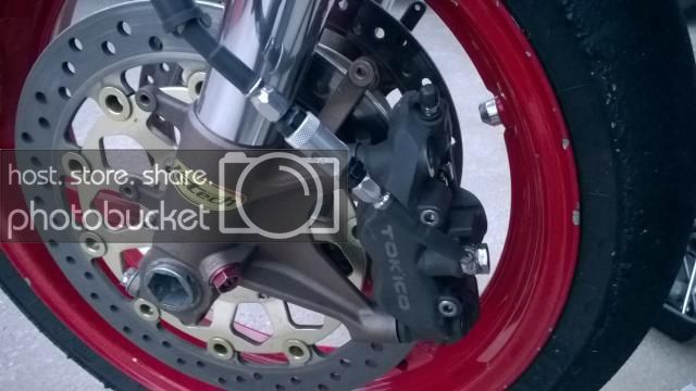

    Seals replaced and calipers clean up.
    New lines and dry brake joints fitted. God that makes life a lot easier when working on the brakes and bleeding them.

    Also ditched the anti-rattle plates and top spring clips
