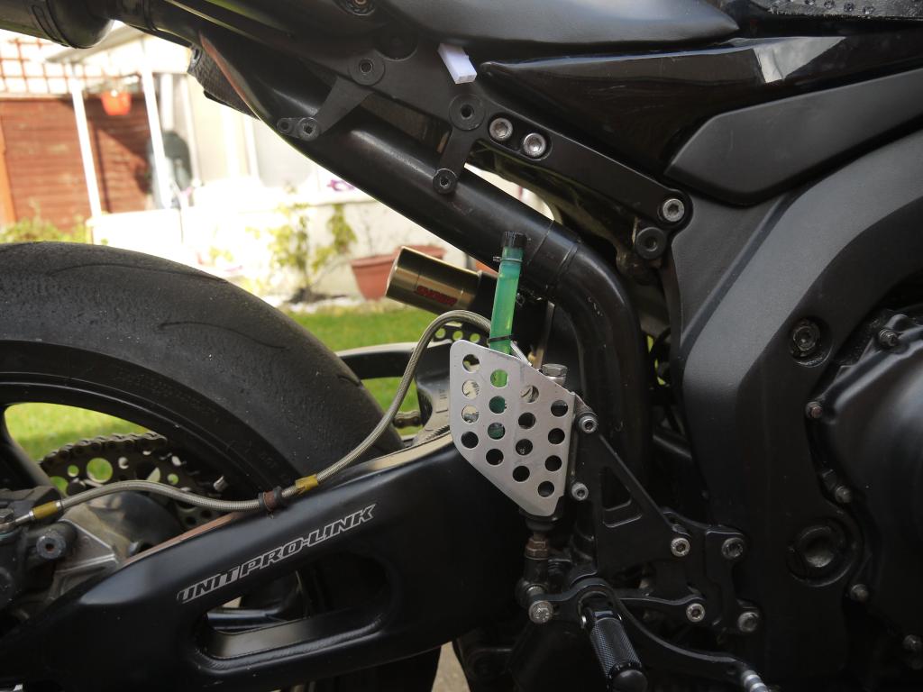

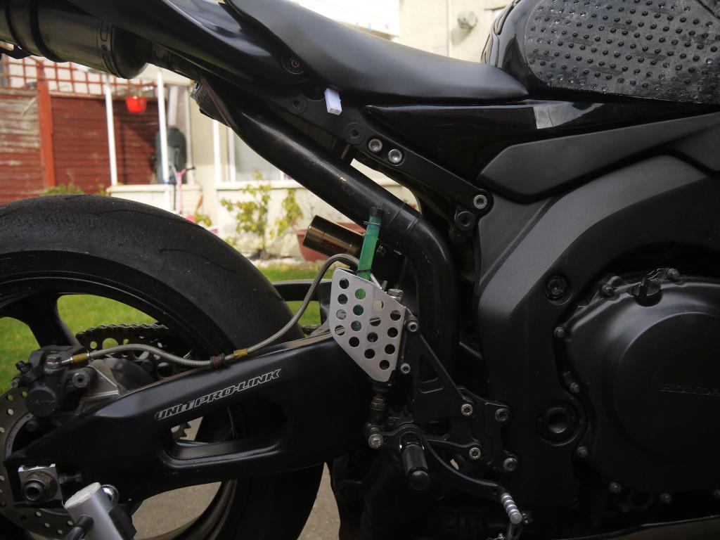

    Took the road Blade for it's MOT this morning which free'd up space to get the track bike out for some work before Snett next weekend.
    Spot the difference (BoroRich should get this) ;)
    Before
    After
  12. martinowen
    9,907
    Res hanger gone
    • Agree Agree x 2
  13. Muffking
    5,862
    2,839
    Got it in one :D
    Done both, which is a job mentioned in Rich's post about the HRC rear brake reservoir post. Done it to the road bike too, but this one has no exhaust cover either, so that hangar's gone too.
  14. FirebladeRR
    FirebladeRR Active Member
    Apr 30, 2014
    655
    86
    What did you cut with or do you recommend cutting them off with?
  15. Muffking
    5,862
    2,839
    Just an angle grinder with a 3mm cutting wheel. Then smoothed it down with the grinder and painted over it in black.

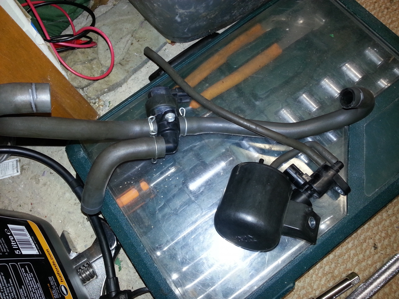

    Lifted tank, removed airbox and intake duct. Then removed the following:
    Also check the spark plugs whilst I was in there... all looking good!
    Obtained a mint condition air duct from a scrappers, so I can set about removing the flapper from mine, and some general "adjustments" with a stanley, 1mm polyprop sheeting, and super glue!!!
